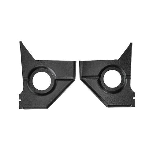

They look like these:
from:
Or these:

Yep, but i just ordered the empty kick panels off ebay and used my own 6.5” speakers of choice.
The panels are great and are a perfect fit. Only thing I dont like is that driver’s side speaker bulge now blocks my wiper/washer foot pedal so I’m going to fabricate a simple metal plate attached at 90 degrees off of the original and then I’ll be able to still press foot down up in that corner and use w/w again.

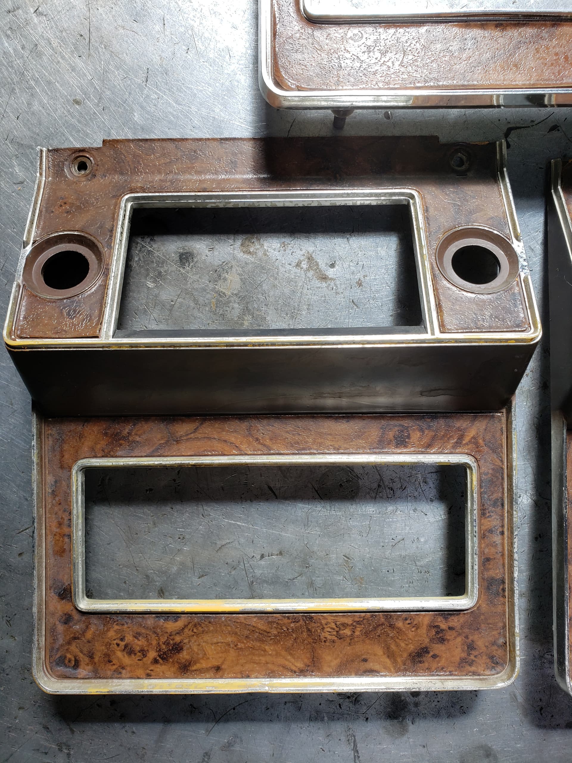

This example has nice wood burl but the chrome is patchy.
How to restore the chrome on an XR-7 radio bezel?
Careful masking and chrome paint works great! The finish won’t come out as shiny as a mirror, but imo it actually looks better that way.
