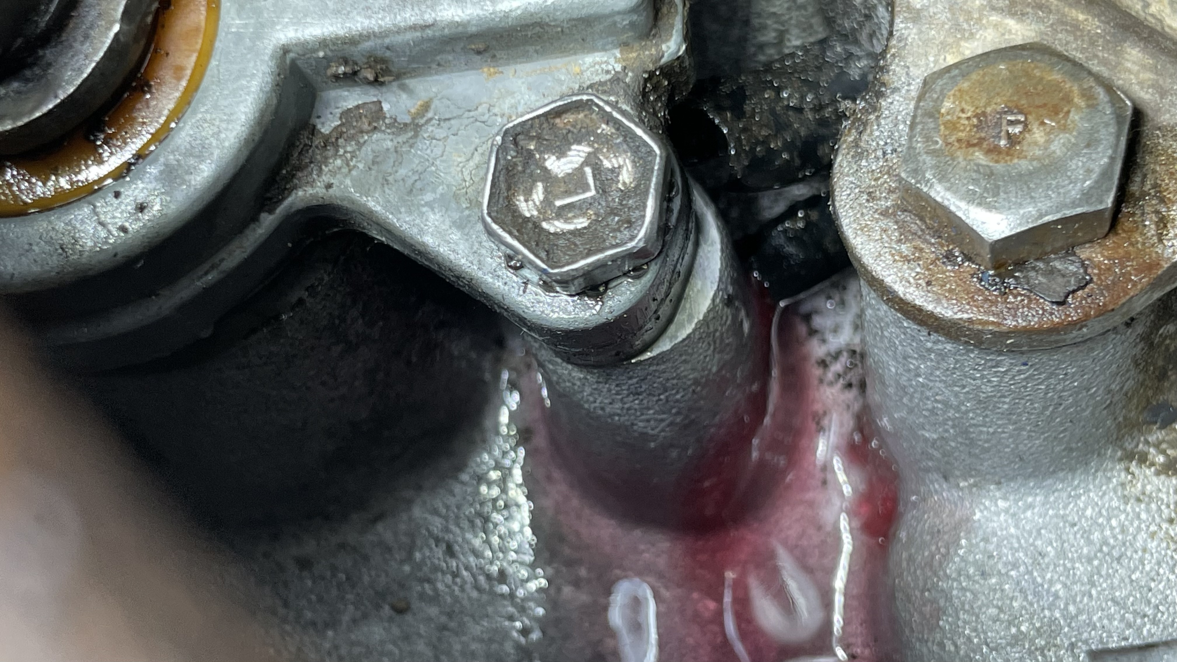

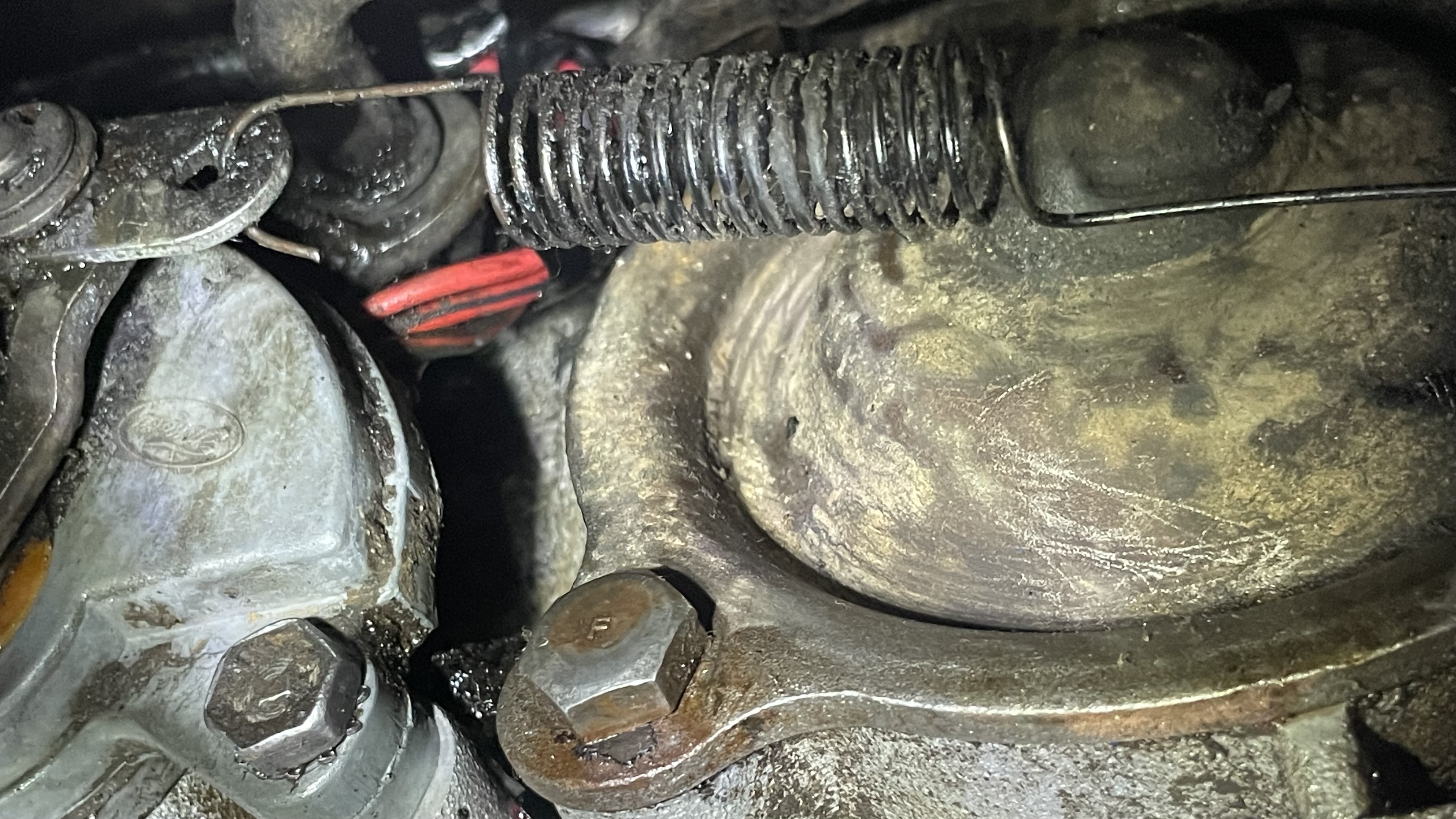

So… I installed the transmission cooler and was getting ready to flush. As I was adding the 6th qt it started to leak from here, above the neutral safety switch, looks like somewhere near where the shifter linkage mates with the transmission:
What is up there? Is it a leak or is it overflowing? What’s it potentially leaking from?
Looks like it’s coming out the vent which is above that area. Another question not meant to insult, but I’m assuming you’re adding fluid and checking with engine running? That’s the only way to fill the converter since I know you drained it…
No offense at all @EliminatorClone . Yeah, I thought it would be the vent after digging further.
