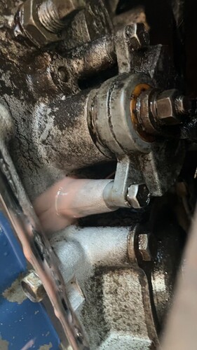

When we checked the fluid level it appeared overfilled. Was it just venting extra fluid from that spot? I’m guessing water/coolant got mixed it somewhere.

An overfilled transmission will aerate the fluid and push it out the vent like you’re showing. The pre-70 C4 has a vent tube that empties right above your leak.
The in-tank transmission cooler might be leaking. Autozone and Oreilly “rent” tools for free, get a cooling system pressure tester. Remove the cooler lines and test the radiator for leaks. It should be obvious, as you’ll have coolant leaking out trans fittings on the radiator.
Very interesting @Hemikiller would over-aerated fluid turn pink, or could that be ‘leftovers’ from just not flushing it a few times when I initially changed the fluid?

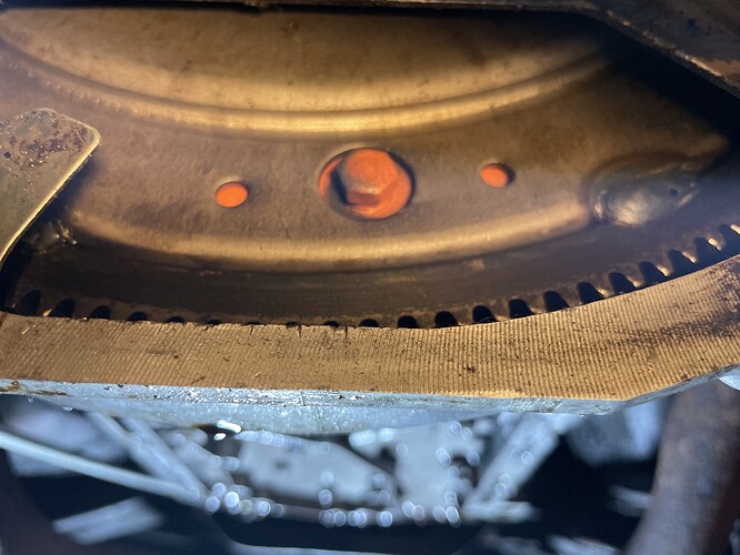

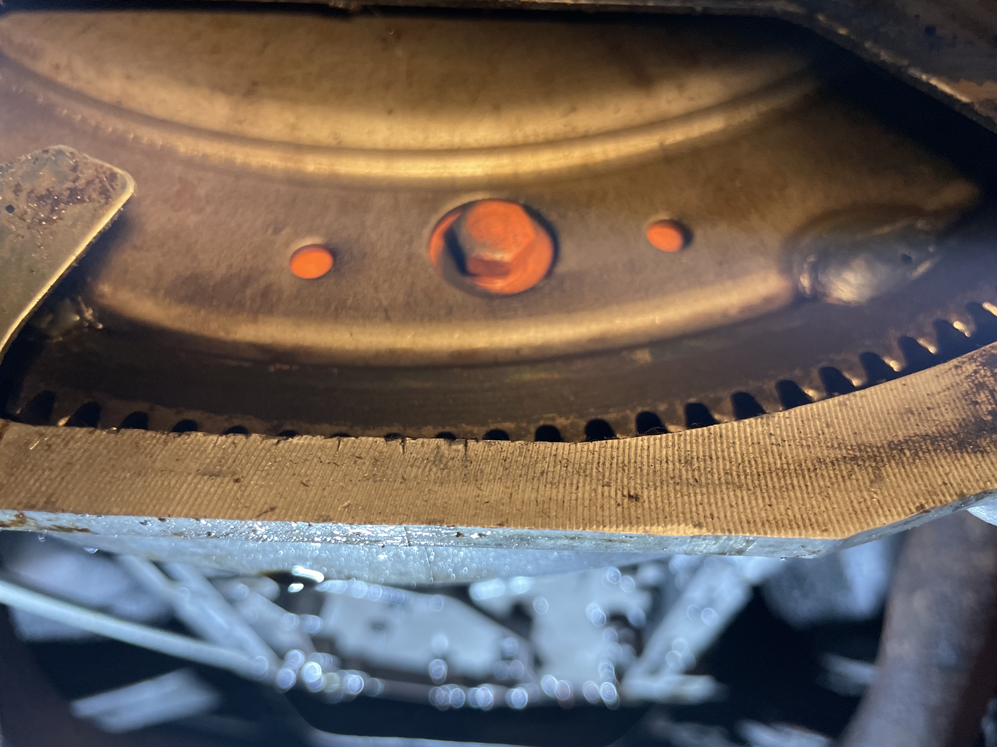

I removed the transmission pan to drain the milkshake. I’ve never drained the torque converter but I feel like I should. I removed the inspection plate, and I see conveniently a recessed bolt with a bit of red:orange on it.
The other bolts appear ‘on top’ so I think I’m looking at the right spot/bolt. Any harm in removing it? What should it be torqued back to when reinstalling?
Once you get the pepto-bismol looking trans fluid. The water is dissolved into the ATF. Being the clutches and bands are all bonded with a water-soluble adhesive, you will eventually find the friction material will fall off or shed. You can have the fluid tested to see if there is glycol contamination. At my shop, I have test strips from Accu-strip to test for glycol in ATF. You can buy a pack online. Glycol contamination pretty much means instant rebuild. Water can be just as bad. Doing a drain and fill is usually throwing money away. Drop the trans pan first. See what other debris might be accumulated. If there isn’t excessive debris and to ----buy you some time---- you can attempt a complete drain or flush. Definitely pull the plug on the convertor. Leave the pan off and plug out of the convertor overnight. Let as much drip out as possible. If you think it’s a failed radiator cooler, install an auxiliary cooler and run independent. Reassemble, pull a cooler line and route both sides into a bucket. Put 6 quarts in the trans. Start the engine and immediately add more fluid to the trans. Keep pouring as you watch the color of the fluid going into the bucket. When it is bright red, you are done. Shut off the engine, reconnect lines and restart to top off fluid. You can never really get all the water out-----even if you flush 20 gallons of trans fluid through it. Life of this C-4 is limited. Either rebuild or do your manual swap.

I will drain the torque converter and flush as you recommended. I’ll also buy that test strip to test the fluid.

I pulled the pan and removed the drain converter plug, pink is coming out as we type. Whatever went wrong with this trans went wrong many years ago I think. I am just trying to clean it up/keep her operable.
