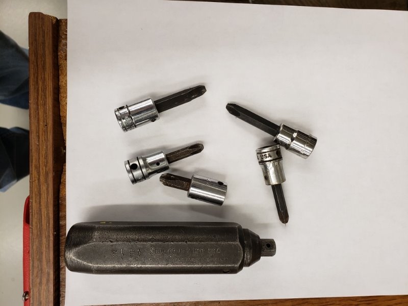

Success! I used a combination of a 1/2 drive breaker bar and a hand impact tool and a series of different bits. Searched all over town for a pozidriv bit, with no luck. I had the best luck with the hand impact. After hammering several times, I then used a pipe wrench on the hand impact which gave a better grip because of the weight of the impact. Thanks for all of your help! You guys are the best and this forum is great help!
