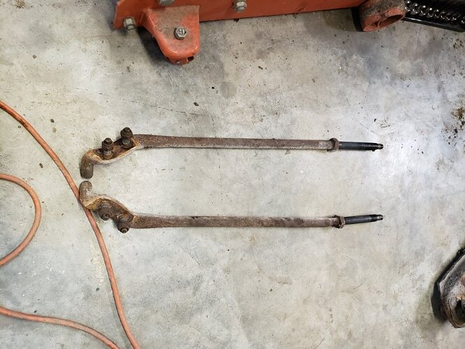

I’m in the process of trying to remove my strut rods on the front of my 1968 Cougar. I have had no luck with my air impact since the threads are rusted. I have been able to slightly move one of the nuts with a breaker bar with a cheater pipe on it, however I don’t want to possibly break the rod. I have tried to clean up the threads with a wire brush and have been spraying the threads with a good quality spray lubricant. I was thinking about running a die over the threads, however I don’t have a large enough die. Anybody know what the size of the threads on the rod is?

Success! Got them removed by soaking the threads over several days with aerokroil and slowly removing the nuts. However the driver side strut rod has a slight bend to it. Think I could straighten it?
Probably not. Unless you have access to a lot of heat, and then you’ll change the temper of the metal. I wouldn’t even attempt it due to that fact.
Agree. Not worth the risk. A really cheap part. Get a good straight used one or a new pair.
I figured as much. Thanks guys!
