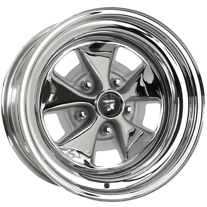

Were the styled steel wheels (similar to the one pictured) available as an option with any '67, '68 Cougar model?

They were. However the one you have a picture of is not quite correct. The correct wheel is 14x6 and the outer edge of the rim is painted black. And there is a stainless steel trim ring that goes over it. Its quite common in the after market to use the all chrome version as your picture shows so you don’t have to deal with the trim rings. Here is a picture from WCCC that shows the correct wheel with trim

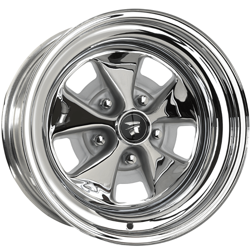

i bought them from coker tire in 15x7. i think its a good price and the quality is OK. i am not happy with the argent paint, they paint it directly over the chrome and it scratches off very easyly…
What exactly is the argent color? I have seen an almost black if not black on these wheels?
Thanks
Argent is a metallic silver as pictured on the wheels at the beginning of this thread. Many people choose to customize their wheels and paint the inserts a different color. In fact, dealers also color-matched the inserts for Cougars if your car was Jamaican Yellow, Onyx (black), Inverness Green, Cardinal Red, Cinnamon Frost and maybe another color.
