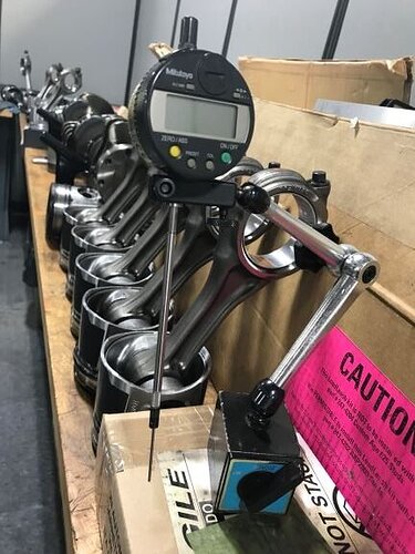

Like 67427GT500 said if you have non rail roller tip rockers you will have guide plates to maintain alignment regardless if it’s a solid or hydraulic lifters. Do you have a dial indicator with a magnetic base? If not it’s a good tool to have in the tool box. Put the dial indicator on the rocker arm on the push tube end. Bar the engine over so that position is on lift. Watch the dial indicator and see if it goes negative (leaking down) then it’s hydraulic. No movement it’s solid. Generally hyd lifters have a full travel of .120" and are set at mid travel .060" They’re ground in categories and the leakdown rate can very and be influenced by the weight of the oil and temperature. If the engine is warm it will be easier to tell then a cold engine with cold oil as it will leakdown slower with cold oil.

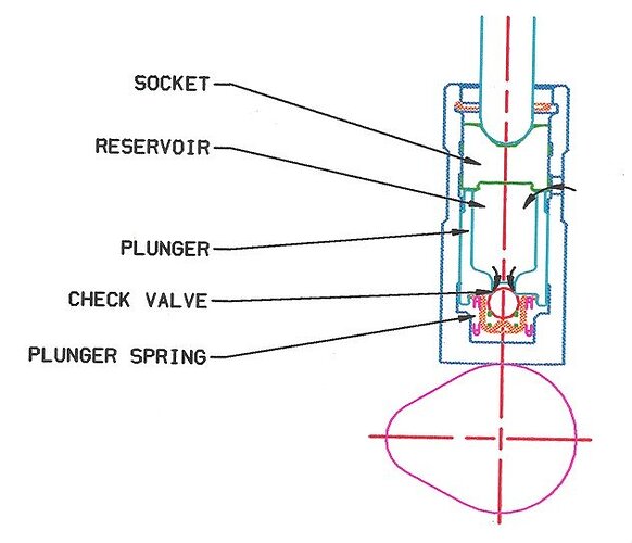

No, if it’s a solid lifter their is no bleed down. Just loose lash. You have most likely pushed the oil out of the lifter. The resistance you’re now easily pushing against is the lifter ID plunger return spring and the high pressure chamber now has air in it verses oil which will have less resistance.
Diagram of a hydraulic lifter.
