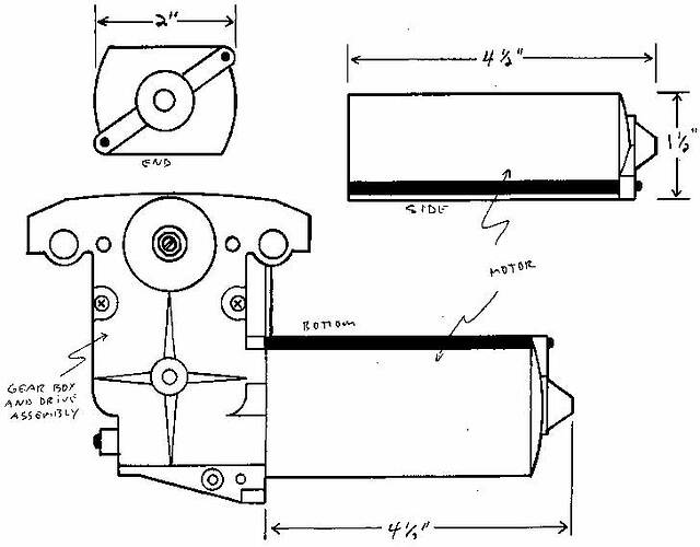

Why would the unit you listed above not work with an overhead console - too large/thick?
Seems thinner than the roundish metal ones.

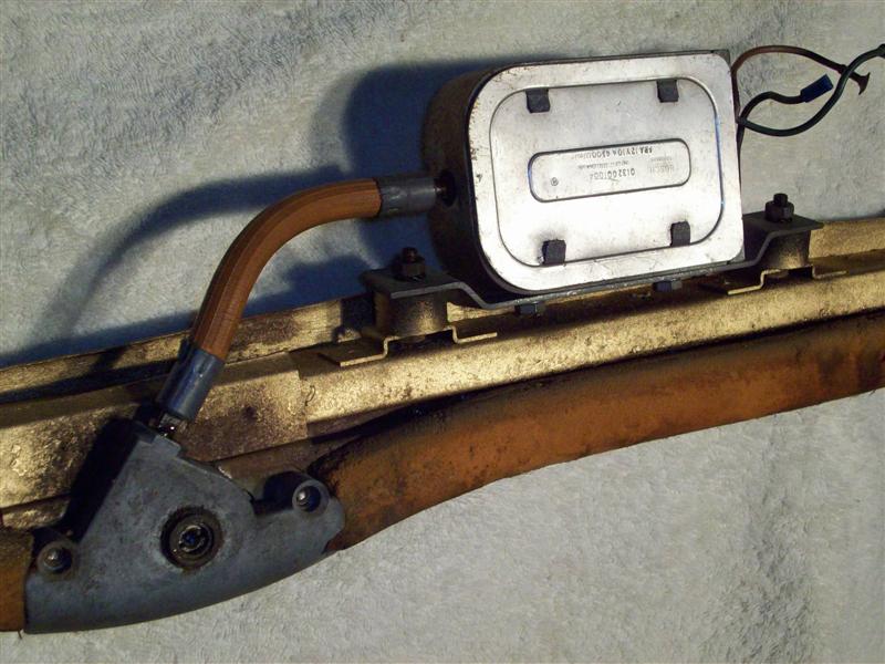

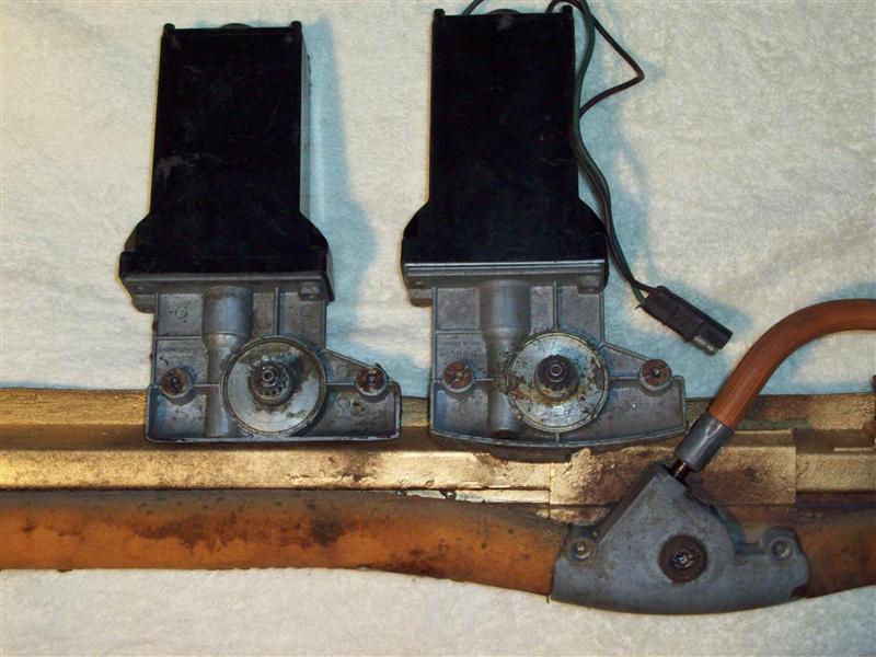

In the picture that shows a motor labeld “Rusty Sunroof” the motor is at a 90 degree angle to the drive unit. Your drawing also shows the 90 degree relationship between the drive unit and motor. Those will work with an overhead console. The second listing I have on EBay has a motor that is straight out from the drive unit. This would interfere with the overhead console on a 67/68 XR7.
