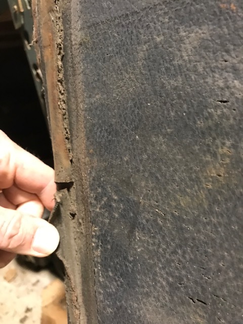

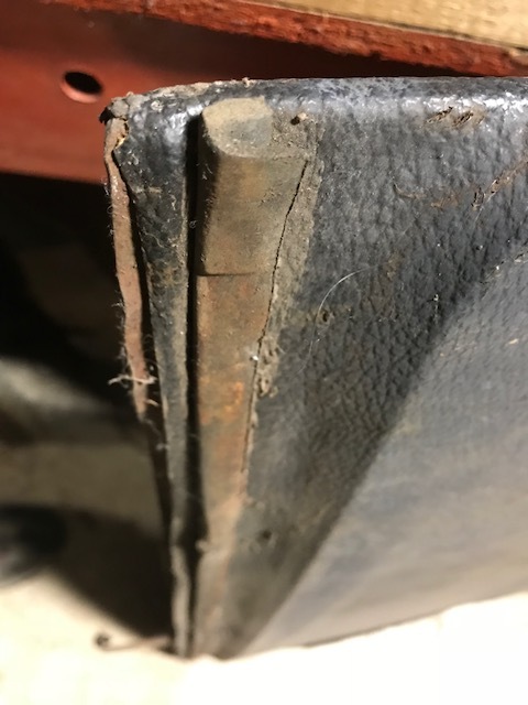

Just two seals. The small one that goes along the back of the sliding panel and just starts around the corner curves and the second felt covered metal one with the bead along the top which goes around the front and both sides of the sunroof opening.

You are correct Steve. The third seal is this foam U shaped seal at the back that often gets over looked.

Any source for those often overlooked (certainly by me!) rubber seals like in the pics Don posted?
