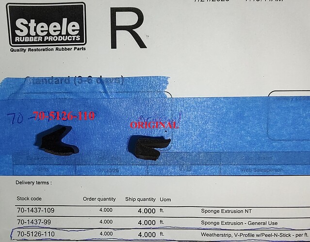

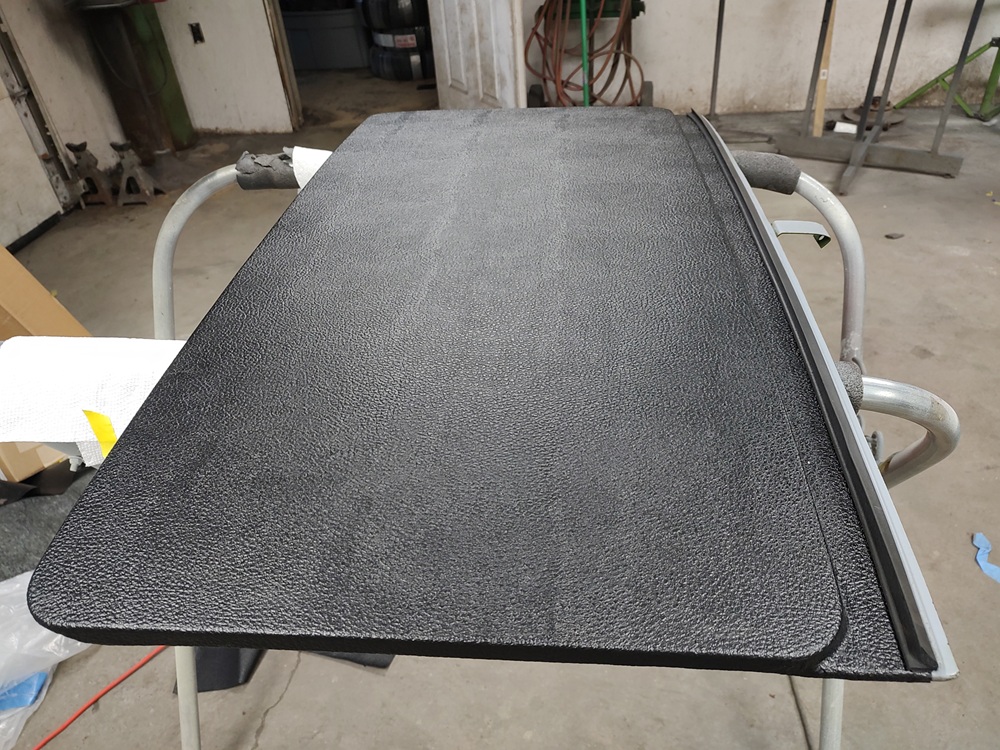

I found a good rear weather seal for sunroof panels. I bought a bunch of different profiles and found that Steele Rubber pn:70-5126-110 comes close to the original. It comes with adhesive on it and it stuck very well to my newly covered sunroof panel.

And it looks like you’re referring to the strip at the rear of the sunroof panel and not seal that runs around the edge of the opening - correct?
