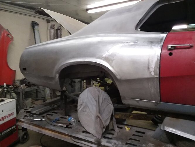

If you look closely you can see that this quarterpanel is four different pieces flush welded together

Hello. Yes, they are the ones made for both the 1969 and 1970. I had to extend the rocker panel (move it back) about a half inch so it matched the quarter panel in that area.
Awesome. Thank you. You told me exactly what i wanted to know. Unfortunately I need to use most of the panel. I cut it just below the upper body line.
Another area that does not fit too great is in the door jam. the top is tight but not the bottom. But I am getting it pretty close, it will just take some patience.
Correct, they split the difference between the two years. As Badcatt mentioned, 70s have a wider wheel opening than the 69 to accommodate larger tires. So regardless of what company makes them, if they are being advertised as fitting both years, they are not right for either year. I knew this going in though and I was not overly concerned because the wheelhouse lips needed remade anyway. My choice for the quarter panel replacement was these panels or two OEM panels that a guy is selling for $1,500 each. So I chose the cheaper route.
