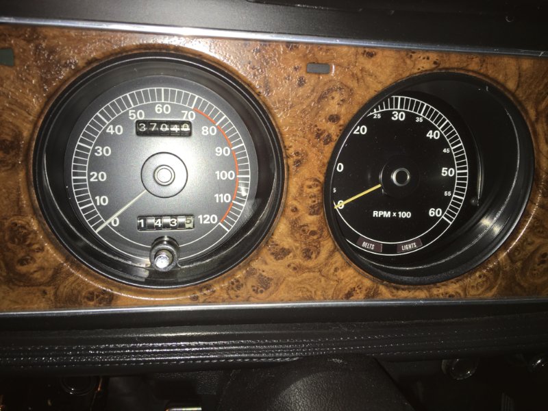

I recently picked up a 1970 XR7 convertible, November, 1969 Dearborn build. The speedo needle is white and the tach needle is red/orange. The faces of the dials match. I have noticed photos on the web of other cars with the mismatched colored needles. Is this considered production variance or is one color “correct” and the other “not”. If the latter, where would the red/orange needle tach have come from? Thanks in advance for any insight.

I’m pretty sure that the white needles (including all the secondary gauges and the minute/hour hands of the clock) are not faded red/orange. Just wondering if the tach is a transplant from another year/model or ??

Just checked my 70 XR7 convt and my 70 Eliminator have a white spedo and off white or yellowed tach needle. Exactly the same shade in both so I doubt any sun bleaching.

The tach needles should have been white from the factory. However…
The Faria built tachs like Randy’s have a plastic pointer and these tend to get an orange tint as they age.
I have had some XR7 tachs and even speedometers show up with unmolested orange pointers. The Mustangs all used orange pointers and the internal movements are identical for Mustangs and Cougars. I suspect that there were occasions where a Mustang movement got mated to a Cougar dial and case.

From the color of those needles I’d bet those are Faria tachs - especially since they are in a 70.
Look at the back - the cases are plastic, not metal. Along the bottom of the back they say ‘Faria Corp’.
They started out with white plastic pointers but didn’t age well.
The only orange pointers I have come across were painted and on 67-69 Bendix built units (metal case, metal needles).
Thanks for sharing the community’s common wisdom. The photos posted above showing what appears to be a faded orange tach needle is exactly what I have in my '70. Replacing the fogged up instrument bezel lenses and generally refreshing the cluster is on my short list. Bringing the tach needle back to white has been added to that list.
