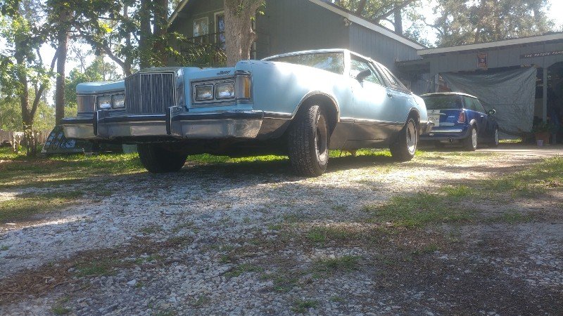

Literally bought a 1979 cougar xr7 3 days ago with 55k miles on it (no roll over). Drivetrain is strong but the wiring is…how do i put it… A rats nest lol. The tail lights seem to work weird.
The blinkers dont work well. What i mean by that is, if the blinker switch is in the center position (lights off) it does nothing. With the lights on the dash illuminates the right blinker steadily when the switch is centered or for the left blinker. If I turn the hazards on all light but the rear driver illuminate because someones been messing with that wiring.
My other concern is that when I press the brake with the hazards on, you can no longer see the flaahing of the hazards on the untouched passenger side of the car. Im getting a voltometer, and my chilton manual is on its way but blinkers working is important.
