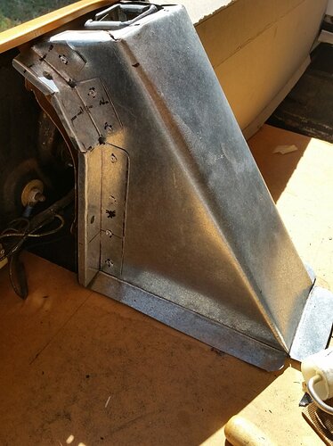

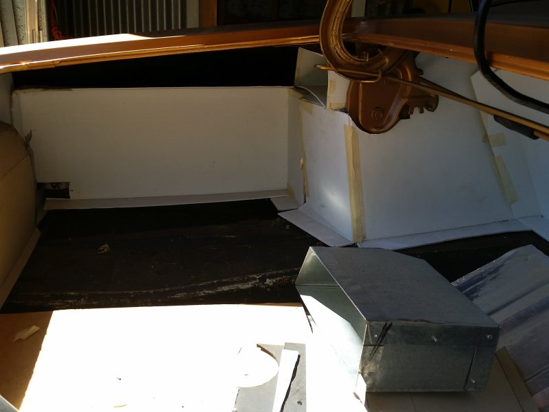

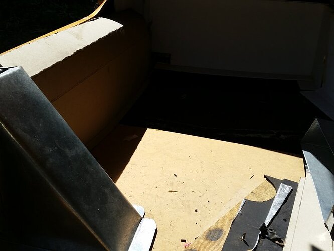

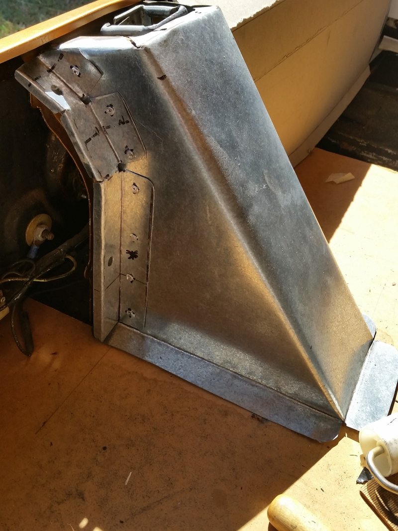

Current work in progress to trim 69 trunk
Made this cover and bracket for coreflute backed covers - these will be covered in marine carpet and clip in with Ford Aus trim clips
Sorry for the bad shot - shows cover template in position - there is another bracket (in construction) that parallels the centre bracket so I don’t have to bend the ends of the covers to meet up with the taillight support
