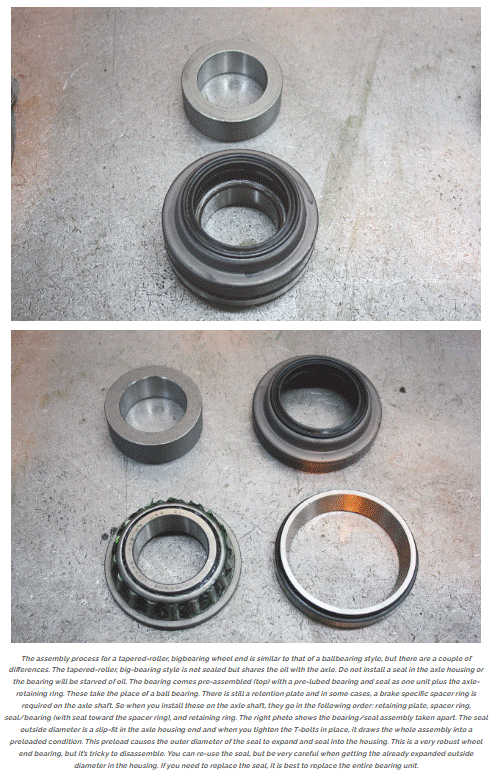

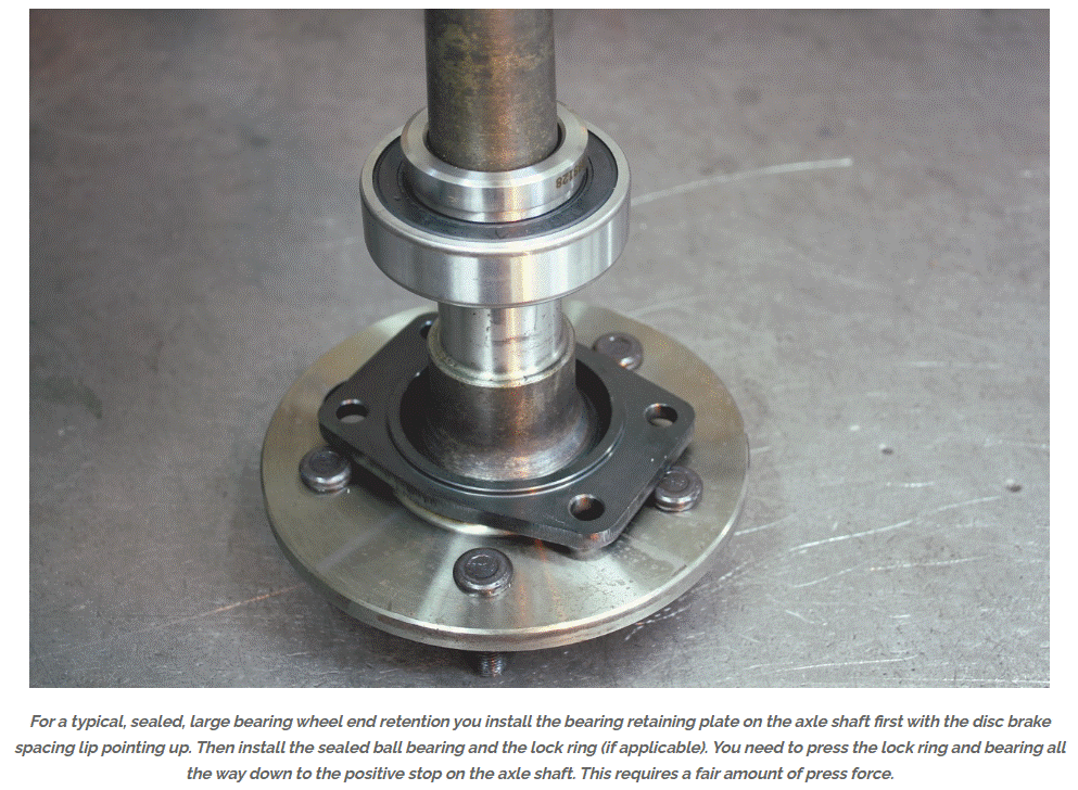

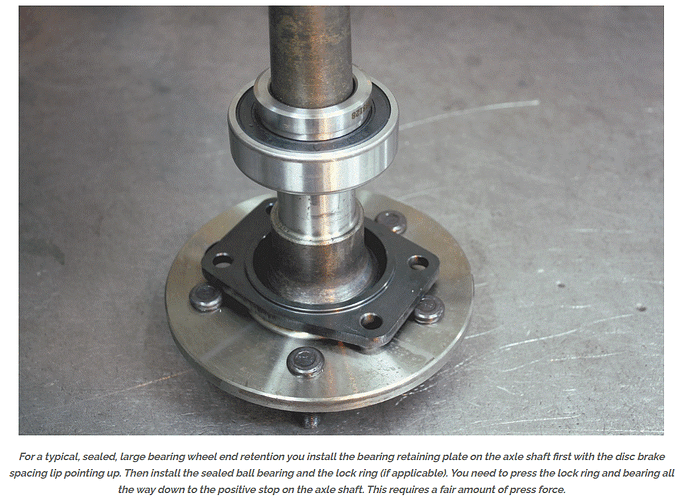

First, apologies for apparent “misplacement” - moderator please move discussion to “Restoration & Repair”. For any future seekers who wind up on this topic there ARE apparently two different set-ups; still unclear as to when one is used vs the other, but since mine had ball bearings and no outer seal I will be reinstalling same. Here are pics of the ball bearing and taper bearing set-ups. If I discover anything else I will post again. An added note for now is that the seal outside edge wants to be coated with an oil impervious sealer - I was steered to “Hylomar Blue”.
The tapered one looks like an outer wheel bearing for the front wheel. Never seen any like that for the rear.
I have, fairly common in mid 70s and up F-150s and Broncos.
I’m satisfied to at least know (?) that I’m good to go with the sealed bearings and no outer seal; apparently the taper rollers with outer seal cup are for high performance/offroad/extreme duty. When I finally get all straightened out mine will only be a grocery getter. Next problem comes with U-joints.
All of the 8” & 9” rears used in Cougars 67-73 had the sealed ball bearing wheel bearings with the inner seal only. Some later trucks used that tapered bearing as mentioned. Keep in mind Rock auto is great at listing parts that are not for the application.
