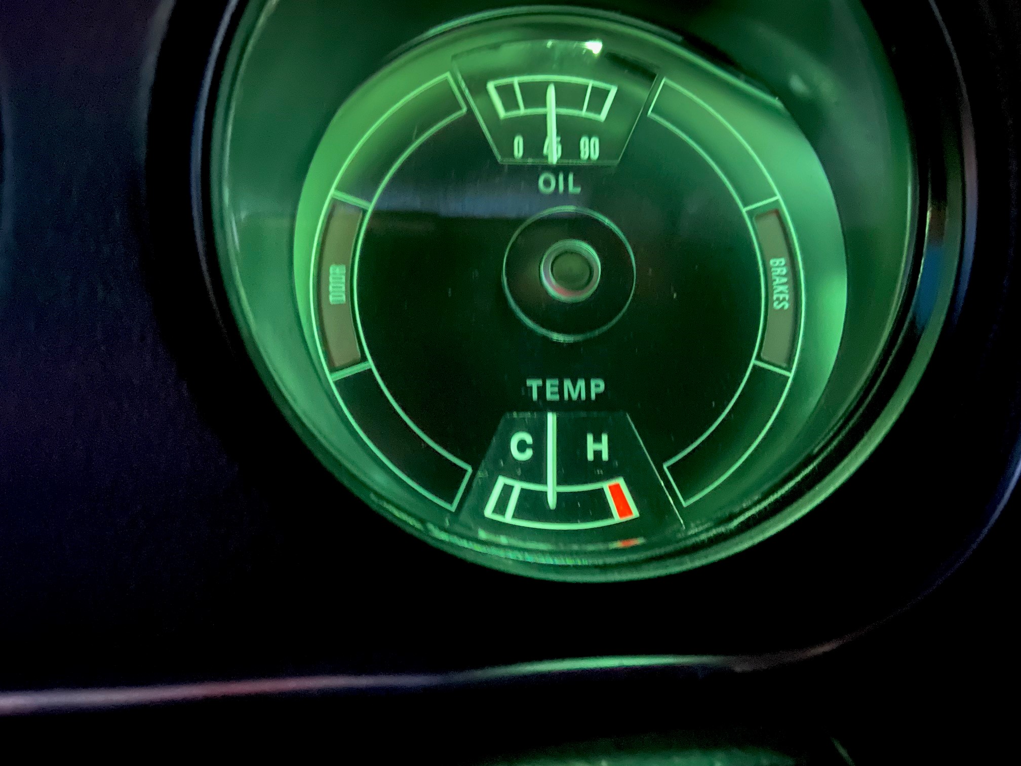

I’m looking for some feedback / insight on a temperature “issue” that has been getting worse over time.
My temperature meter has started to show variations based on outside temperature rather than staying rock-steady at the middle of the range.
So on a cool day when I’m up to temp and driving around the meter will show a bit below the middle of the range. On a hot day it will show a bit over middle of the range, unless I’m in stop and go traffic. In stop and go traffic on a hot day I’ll get a steady increase in temp, right up to the H end >.<
This seems to be a new-ish thing for my car but I’m wondering if others have seen something like this before and if it points to a failing component.
Car details: 428SCJ (3.91 gears), 3-row radiator that is about 3 years old, factory fan shroud and factory C9ZE fan in place, original factory temperature sensor, 195deg thermostat that is about 10 years old, meter has been tested good (using Bill B.'s meter tester), water pump is aftermarket and maybe 15 years old, coolant flush was done last summer.
