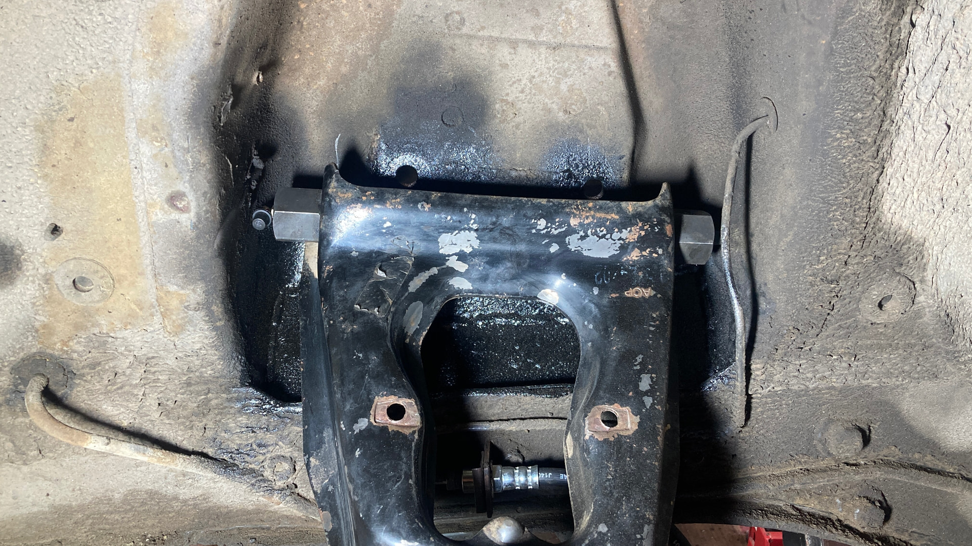

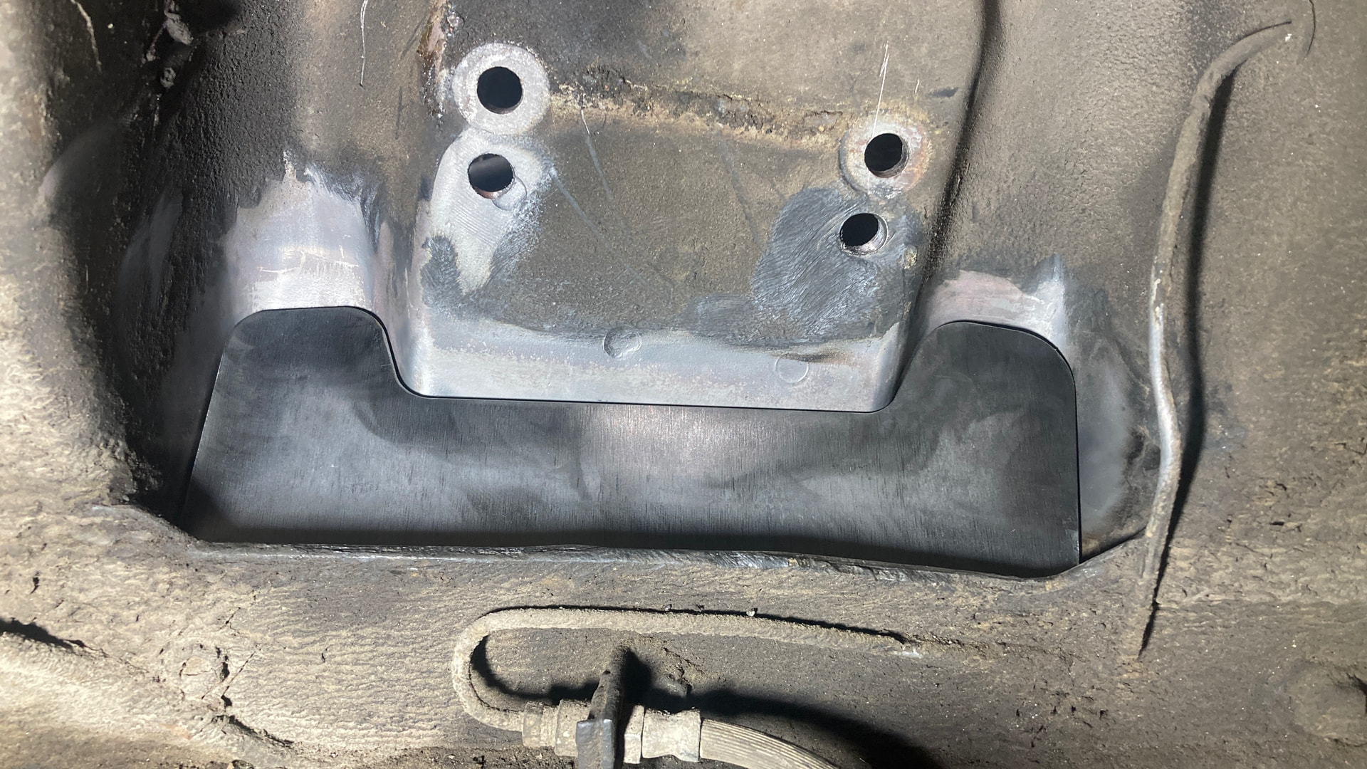

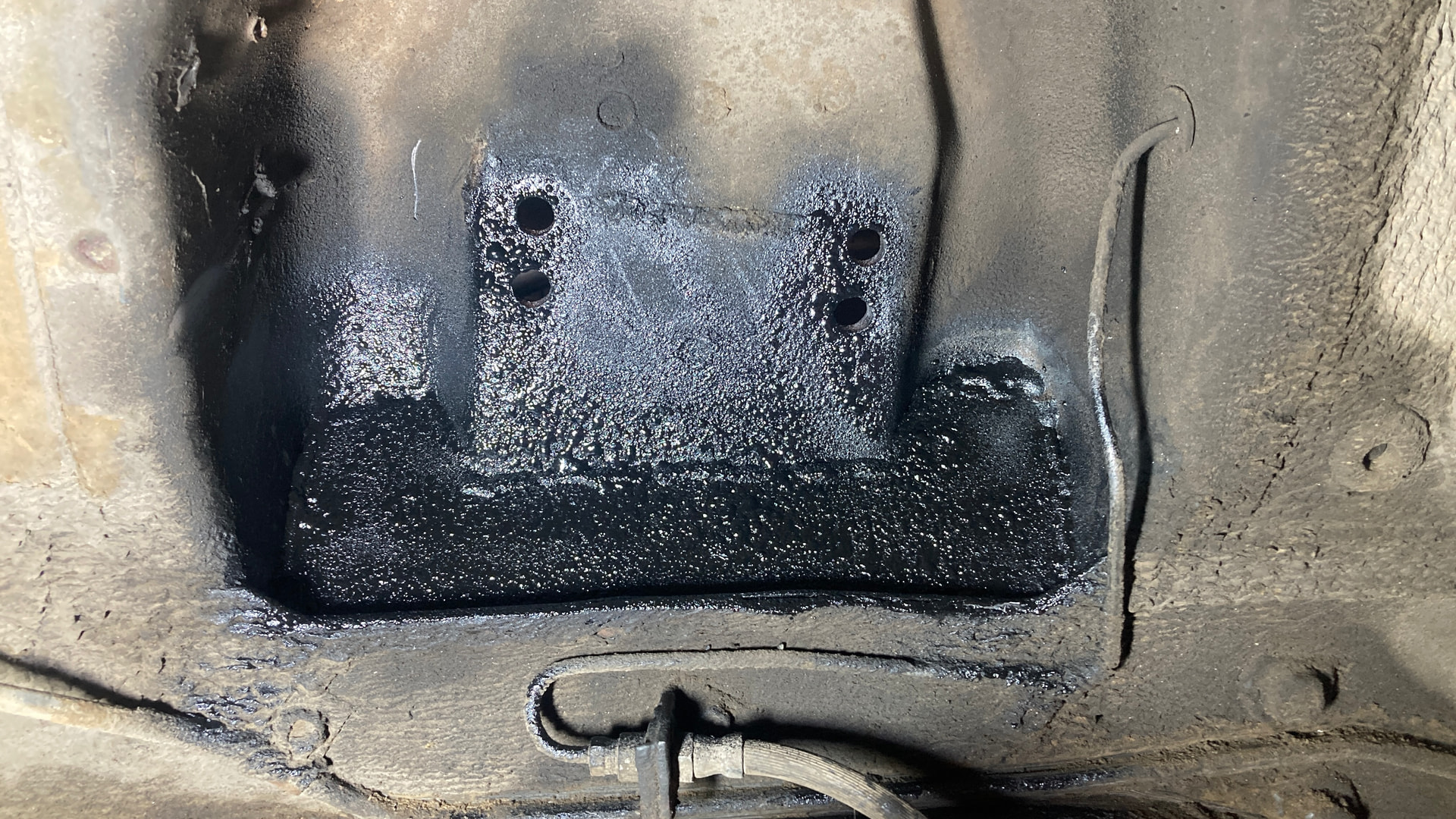

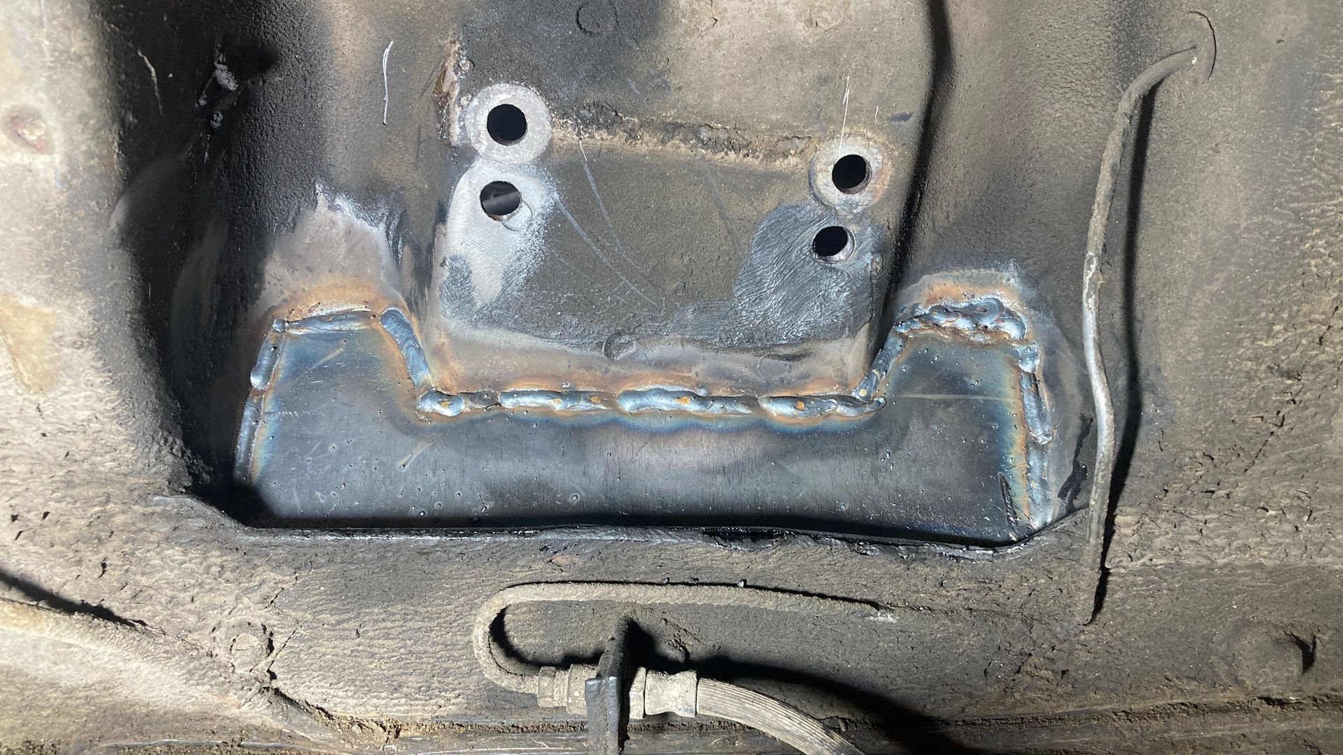

Finished the shock tower bracing and upper control arm drop.
And while the engine was out I cleaned the engine compartment and gave it a light undercoat.

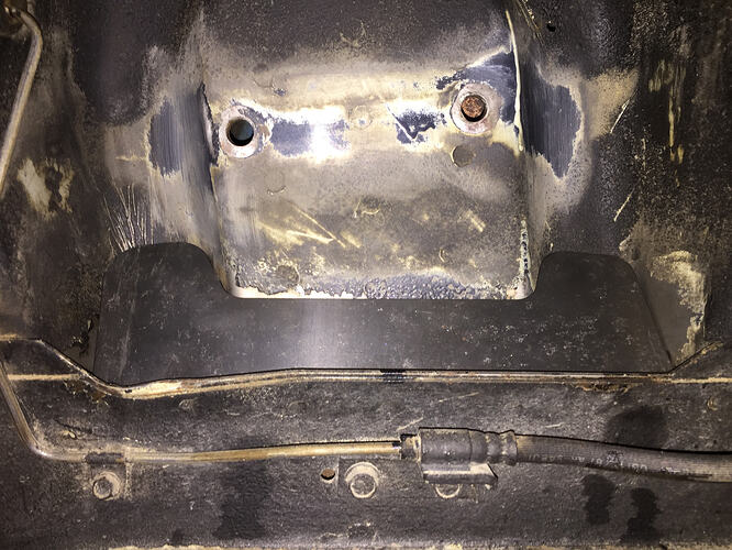

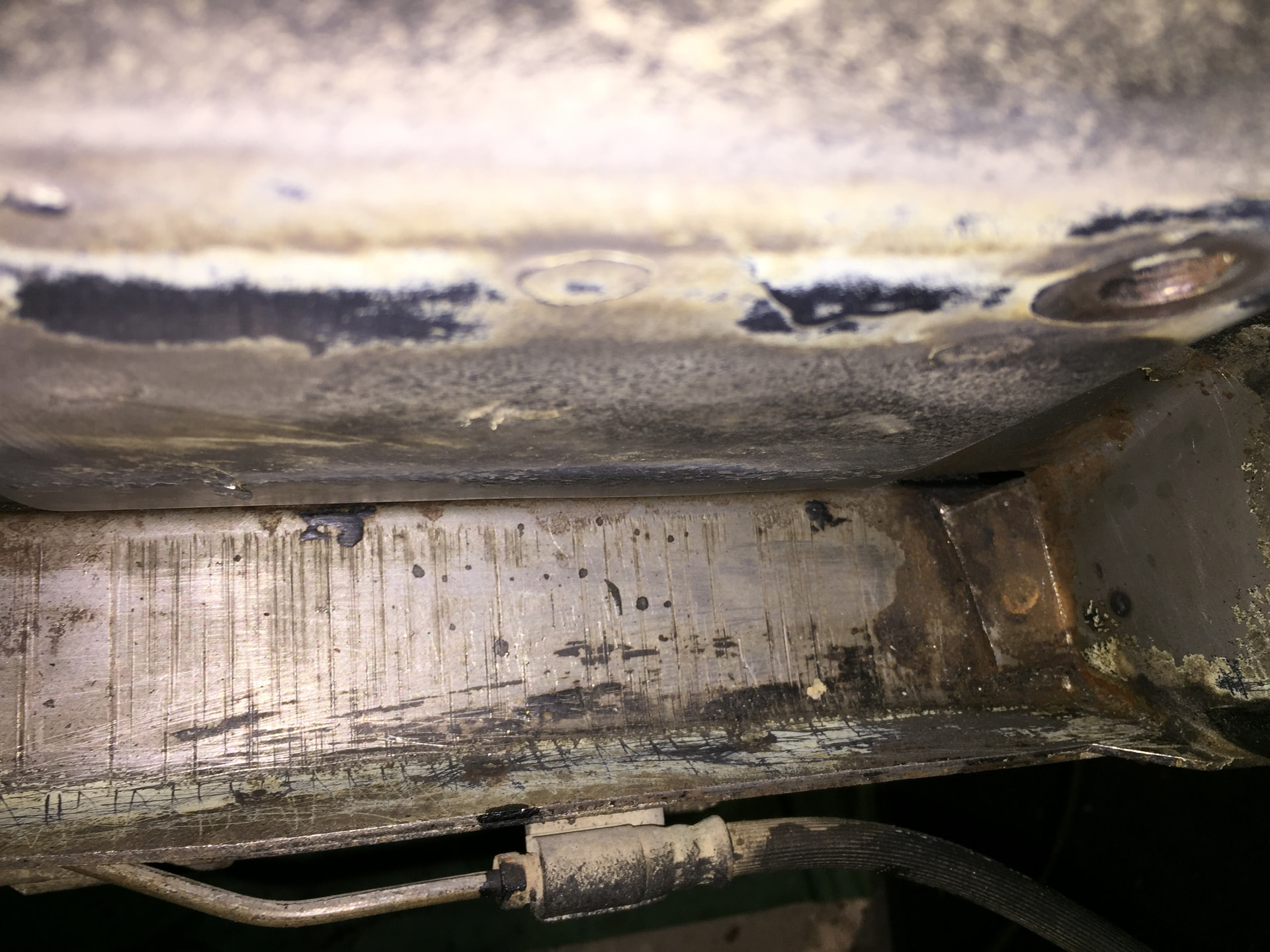

I think those braces are welded into the wrong part of the shock tower. I’m pretty sure they drop down into the pocket. Been years since I did mine, but mine are definitely different.
It may be difficult to see from the photos but they -are- dropped into the pocket as far as they will go right up against the frame rail at the outside edge, and angled up into the curved portions of the tower. They only “fit” in one position. I did watch a WCCC video prior to installing. They are installed correctly.

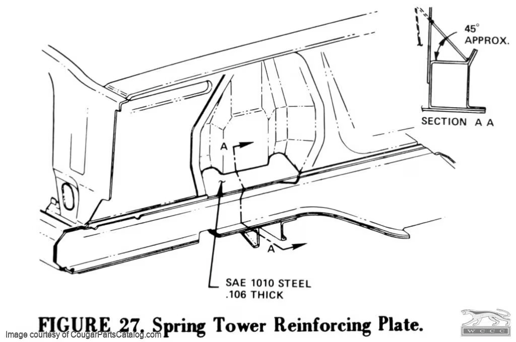

Here is a great illustration from WCCC showing exactly how I did mine:
Thanks for the heads up. I plan on doing the same thing to the 69’.

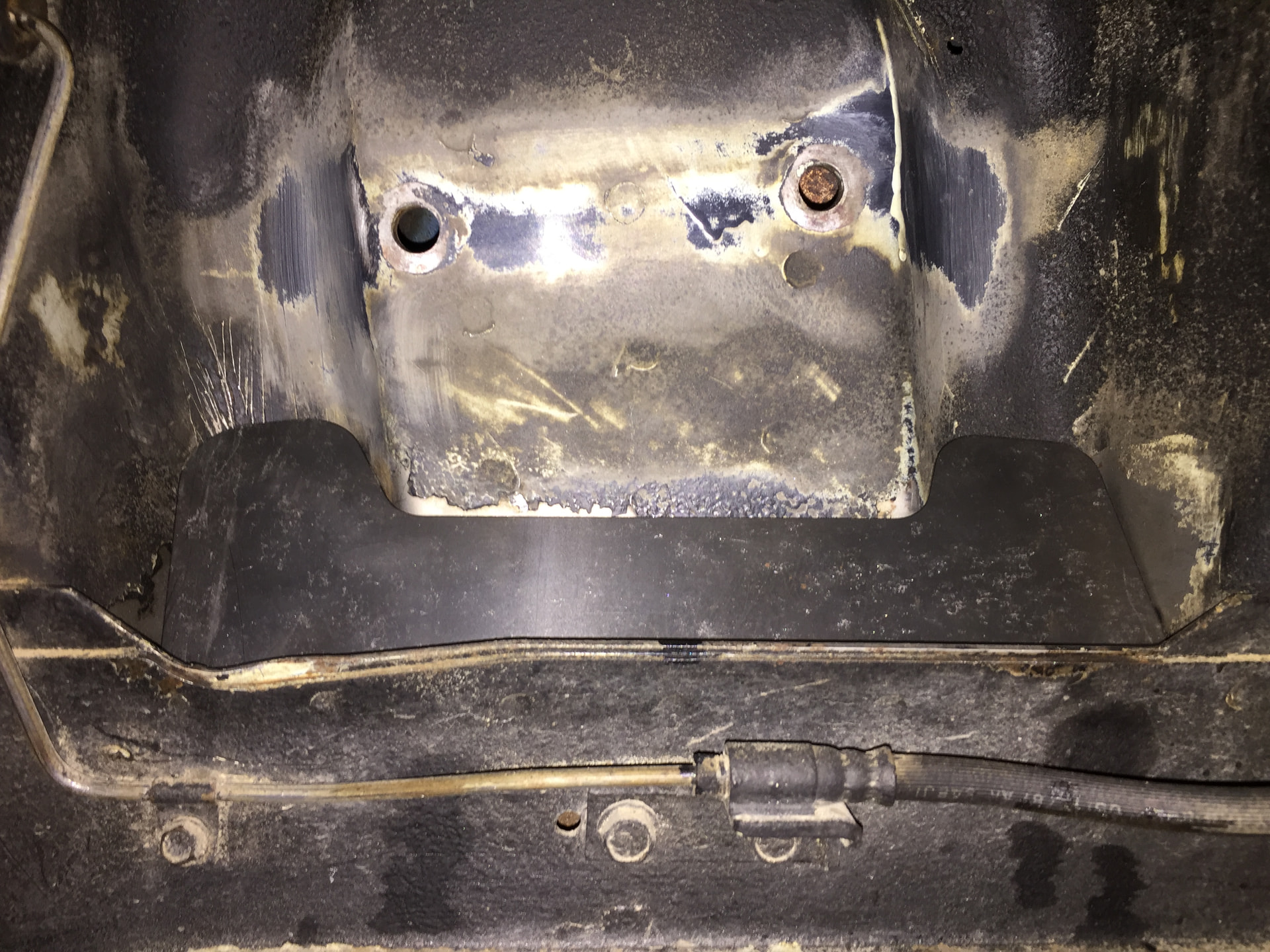

I had trouble fitting mine as well. I studied the video and examined the diagrams. I noticed that if I turned the plates, that then they would fit.

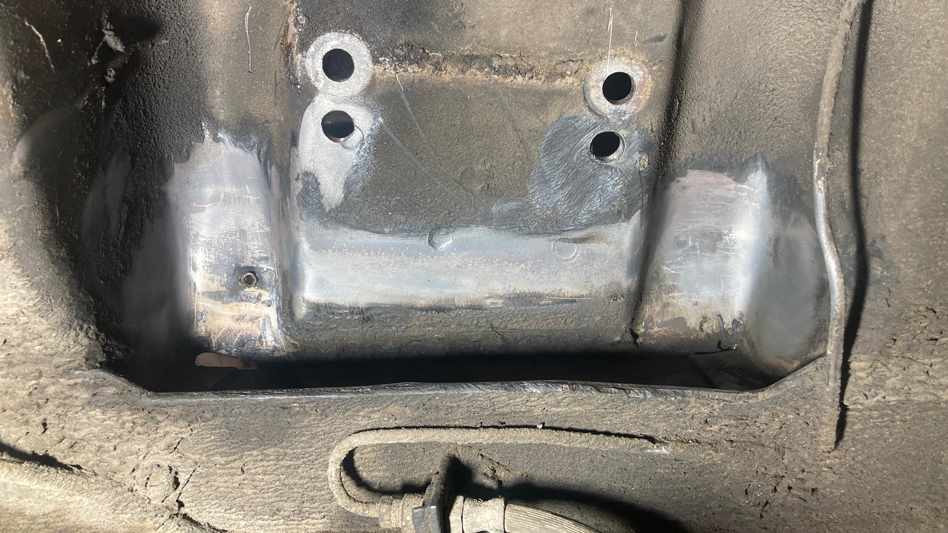

Here’s a couple of pictures when the pocket was cleaned up and the reinforcing plate put in.
That looks correct. Yes they only go in one direction. If it doesn’t seem to fit right then flip it end to end and it should drop right in at the correct angle.
I think I was confused due to the angles of the pictures. I’ve given my head a shake, so I’m hoping it’s all better now.:rofl:

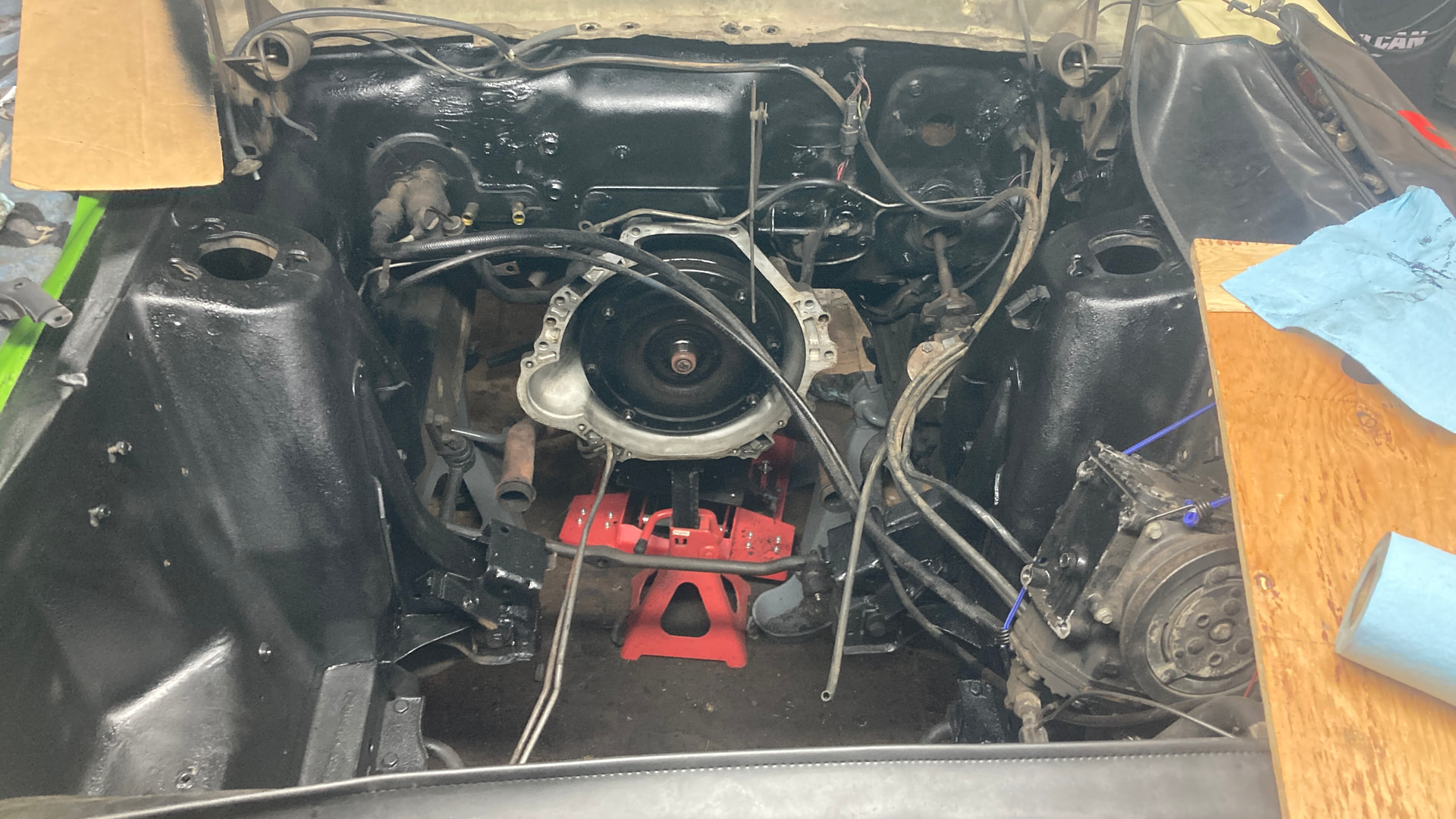

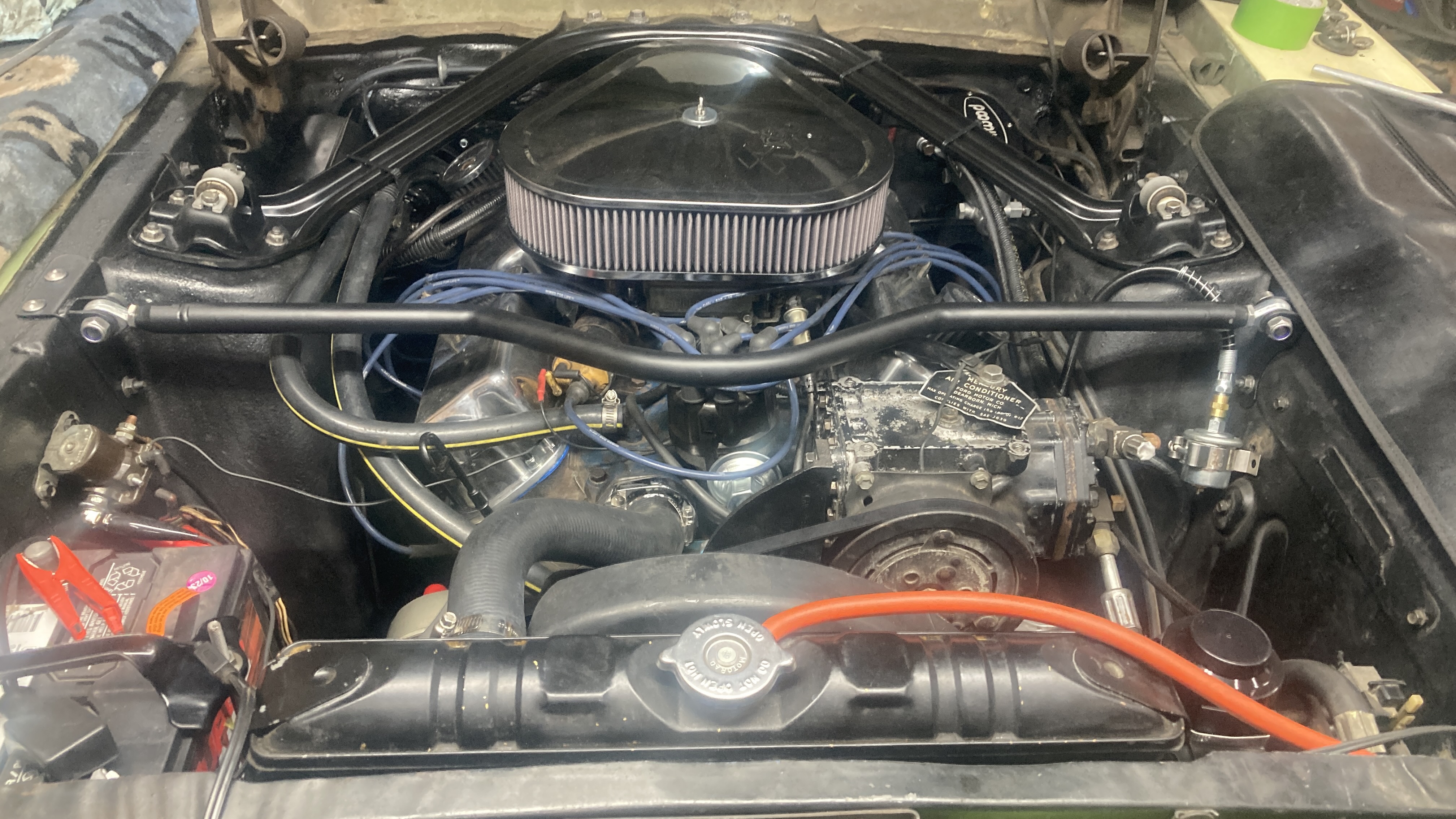

Latest update. A lot to unpack in this one photo.
The engine is back in the car with:
  • New rod and main bearings
  • New rear main seal
  • New oil pump
  • New oil pan
  • New full roller timing gear set
  • New timing cover
  • New water pump
  • New alternator
  • All new belts
  • Coolant overflow bottle
  • Flex fan (not seen here)
  • New cast valve covers with breathers
  • Rebuilt carb
  • New air cleaner
  • New Wilwood brake master
  • Remote mount oil pressure sending unit
  • Export brace
  • Monte Carlo bar
  • New battery tray (under the battery)
  • New radiator and heater hoses
  • Some New vacuum hoses
More on my list to come.

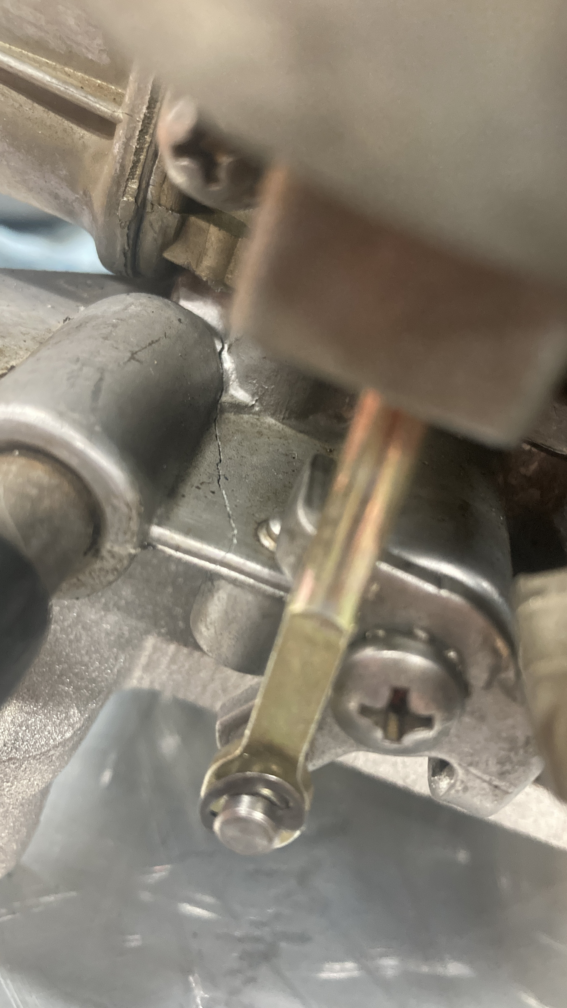

The broken carb flange, four days out from leaving. Necessitated the purchase of a new Quick Fuel Brawler via Amazon, and one day to tune.

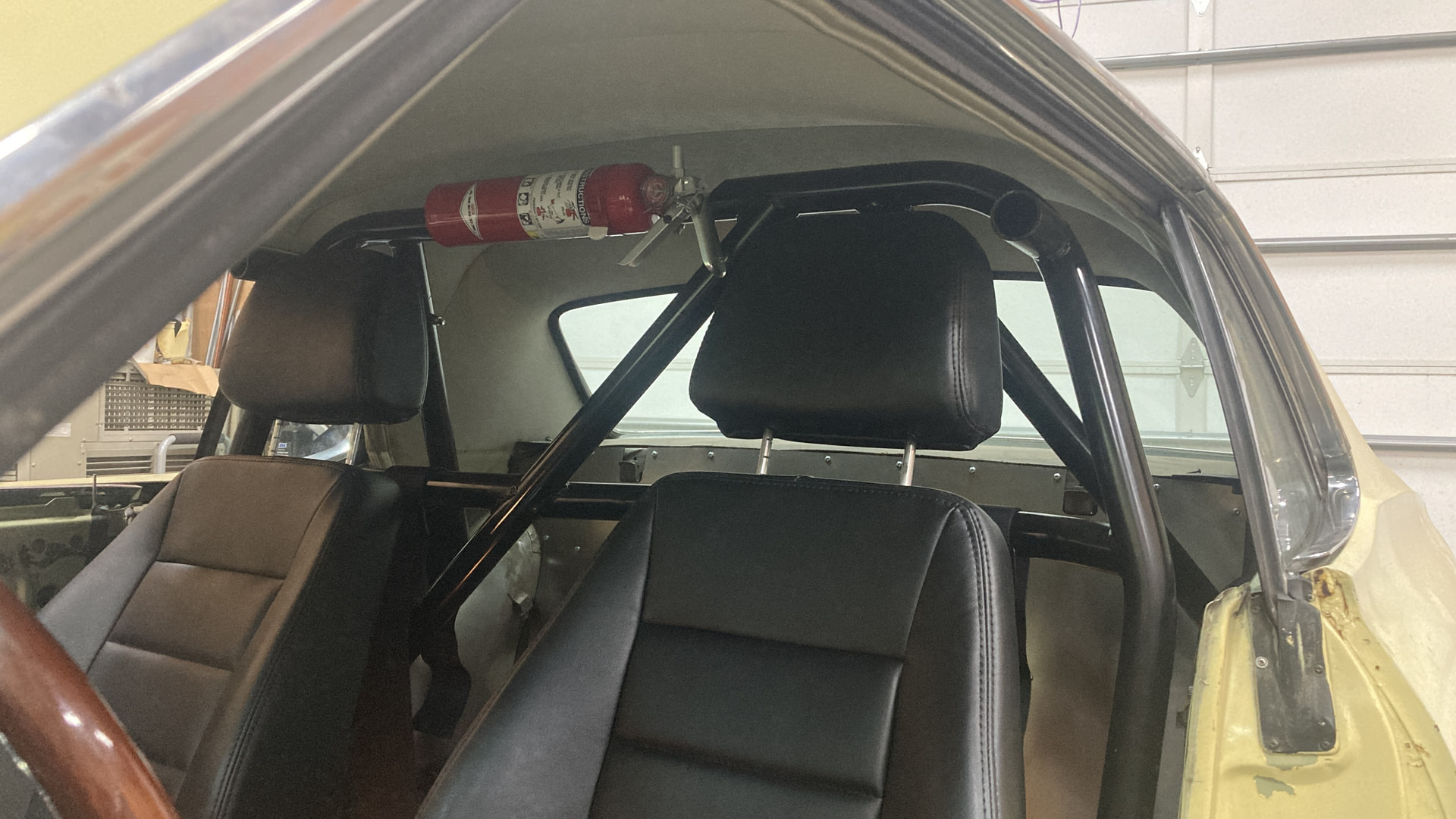

The rear half of an AutoPower Roll cage installed, along with new Corbeau seats. No time to fit the front half and not required for our class. No time to fit replacement quarter trim or the rear seat either.

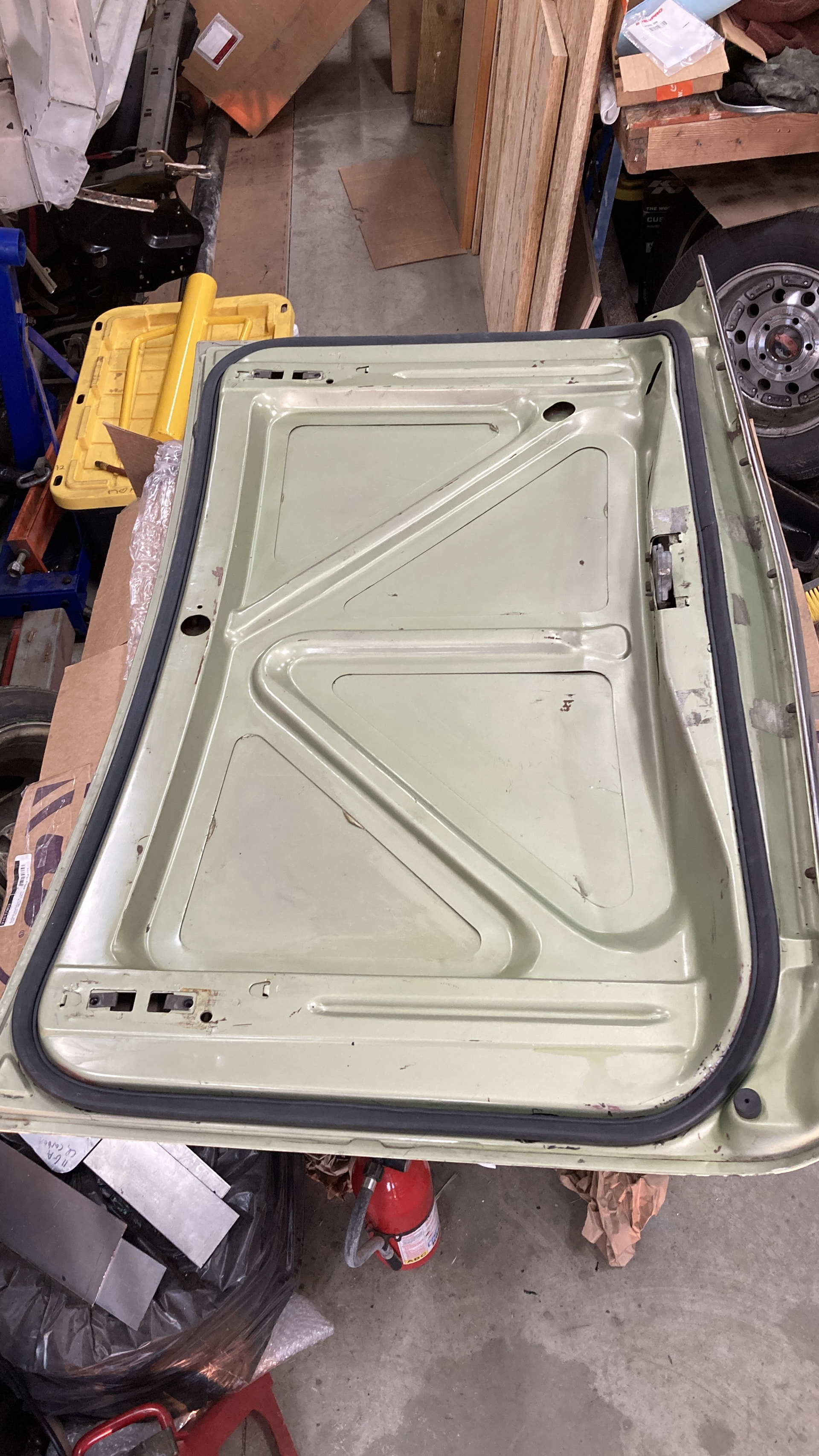

What was left of the old trunk seal was brittle and coming apart. We replaced it with a new seal so no more leaks into the trunk in case we hit rain.

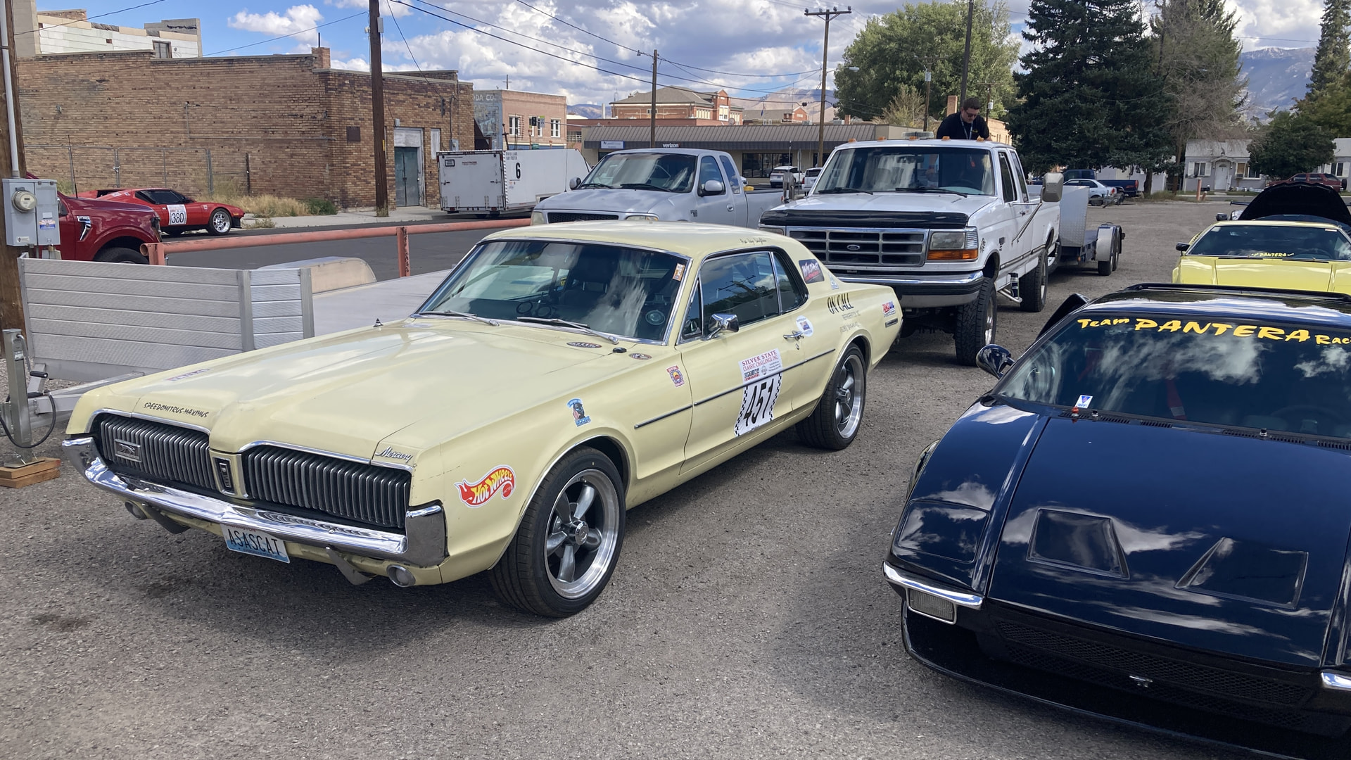

On arrival in Ely, we went to a local Soda Fountain, ice cream shop, Pharmacy, and toy store… all-in-one. That’s me, the driver, Asa Jay Laughton on the right, with my son Sam (the navigator) on the left. I’m wearing a t-shirt representing the Pantera owned by a friend that I raced in 2024.

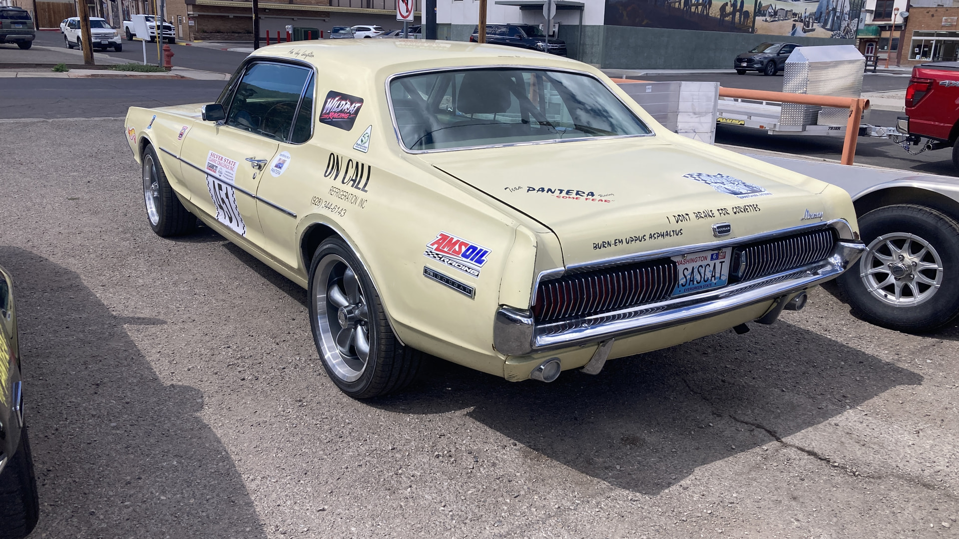

The Cougar, affectionately named “Lady Celeste” in her full livery for this race.

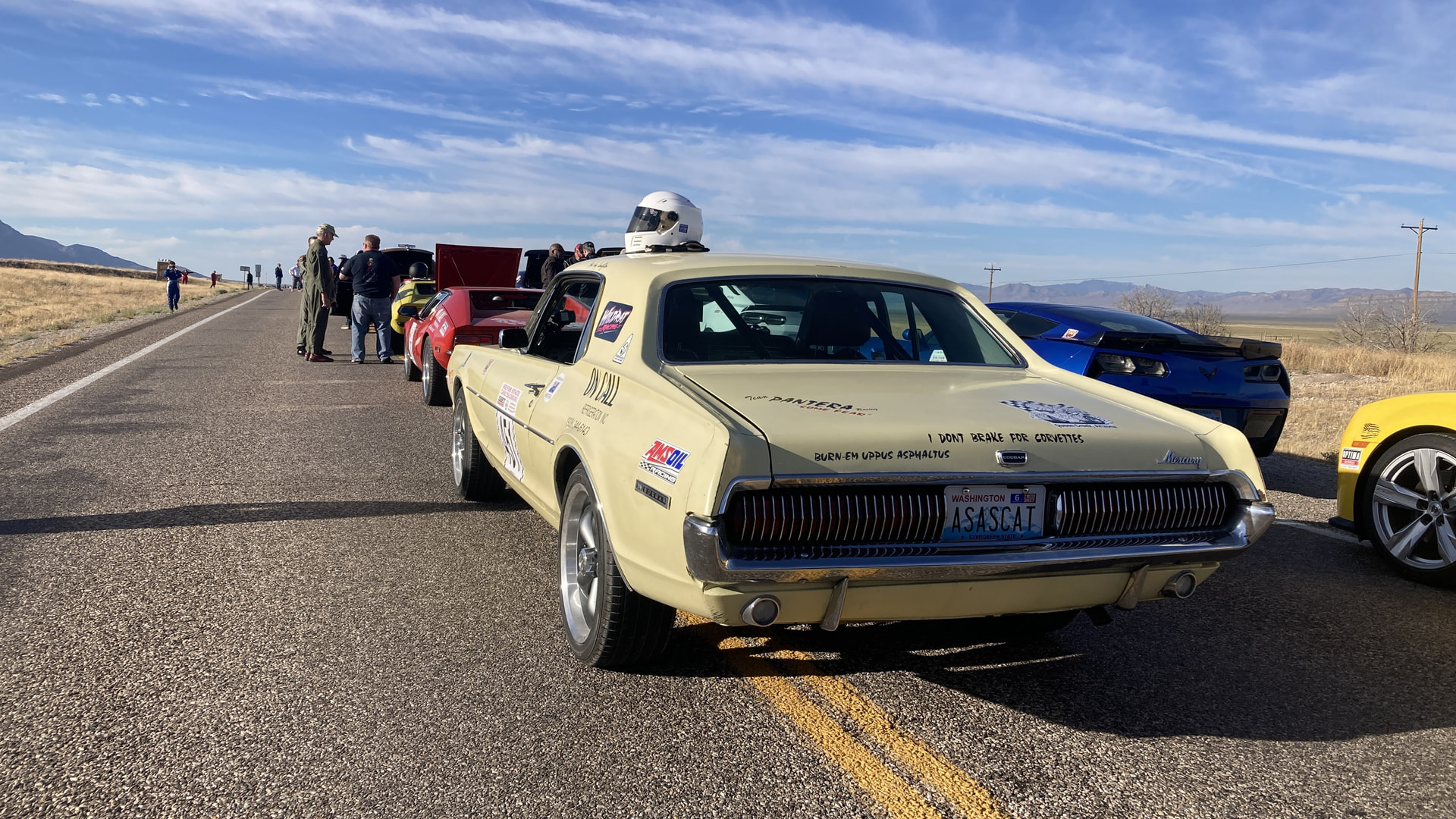

Sam and Celeste in Pre-Grid. A lot of other cars in the higher speed classes are -behind- the photographer.
This is the starting grid. At entry number 105 (same as our speed class, coincident), we were 105 minutes after the first car to start; they start each car at one minute intervals with the highest speed classes first and slowest last. We were right behind two Panteras from our team. We had eight total Panteras entered this year, only one did not finish due to a blown tire (brand new tire by the way). And we didn’t finish due to the oil leak somewhere.
