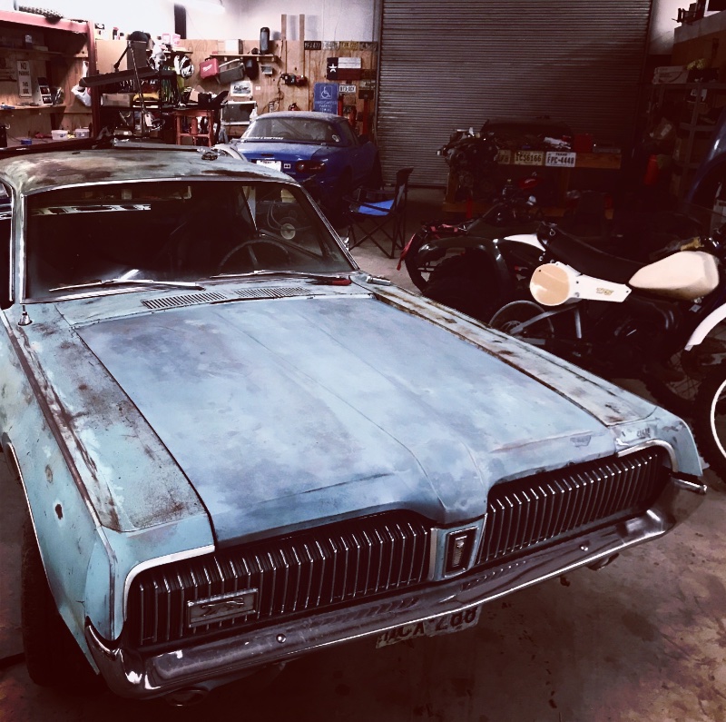

Little update to the project. Things are hopefully going to move a lot faster soon.
I settled on a patina gulf racing theme. Tried my hand on the hood first and I like the outcome.
I spent a lot of time and fixed all the rust on the drivers quarter. I used a front fender for a patch for the lower part in front of the rear tire. I fixed the quarter window rust, drip rail, and upper quarter near the lead line.
I picked up a lower mileage stock roller 5.0
I also grabbed a top loader four speed
And finally I grabbed a parts car to get the doors and other misc parts off of. I’m super excited to hopefully have this running by Spring break.
