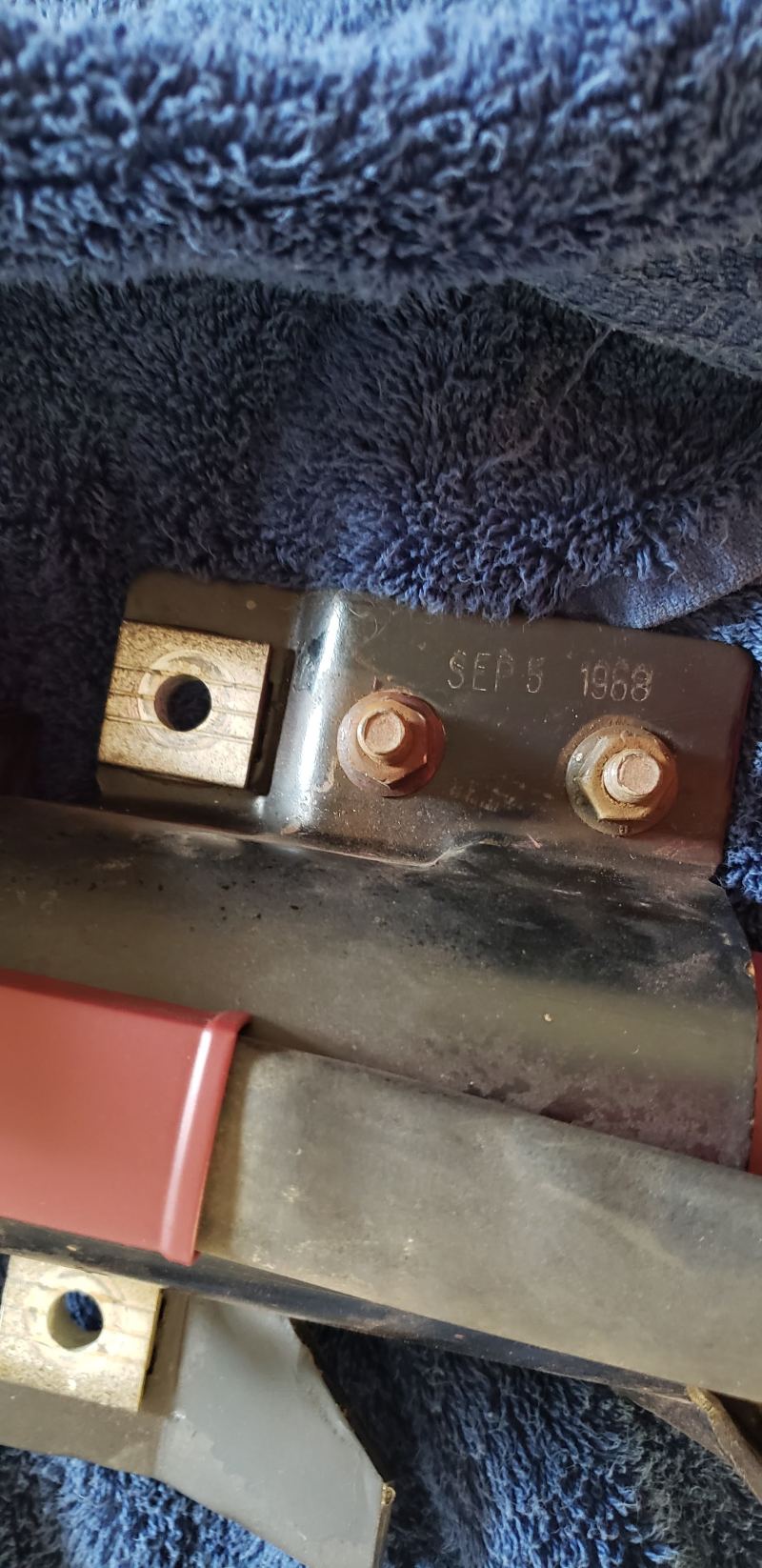

Some pretty cool pics of the fuel pump. Date code seems kind of early for my car but I can’t see why it would be so correct and not be original…Thoughts? It’s rebuilt now, and wow was it full of rust and crap!
It seems pretty early, but what’s your build date? Consider yourself lucky to have a correct one. I had to go find one. They aren’t cheap.
Appears to have the remains of a remanufacturer’s sticker on it. Someone probably exchanged the original for a rebuild back in the day. A very valuable pump, the correct date code should be easy to get with what that one would sell for.
I was wondering about the rebuild thing as well, but the casting tab was still over the soft plug and sure didn’t appear to have been bent around before. The car was owned by the dealership for over a year, so I really need to do some digging on why they kept this car in their possession for 14 months. I have some theories but no proof yet. If they used it as a sales mule and did some racing etc. with it then I can sure see parts getting swapped around due to breakage. The engine had an SCJ rotating assembly when I got the car so I know the motor had been apart, but the block was stock bore prior to me having it rebuilt. The transmission is vin correct but has been rebuilt and has had parts swapped as well.
When I rebuild them I sometimes can keep the tab in place and bend it once again. This would have been an expensive car and by 1970 insurance companies were cracking down on muscle cars, so much harder to sell than in 1969. I bet either the dealer was using it as a racer, or they just leased it to one of the dealership employees which would also be a common “perk” of working for a car dealer. Either way I would try and find a pump with a build date more in line (say 1 - 2 months prior) with the car’s manufacture date.
I was thinking the exact same thing Royce. I will keep my eyes open for a more correct date pump and will put this one with the pile of other CJ extra parts I’ve collected over the years. It will go nice with the early '68 block I have laying around.

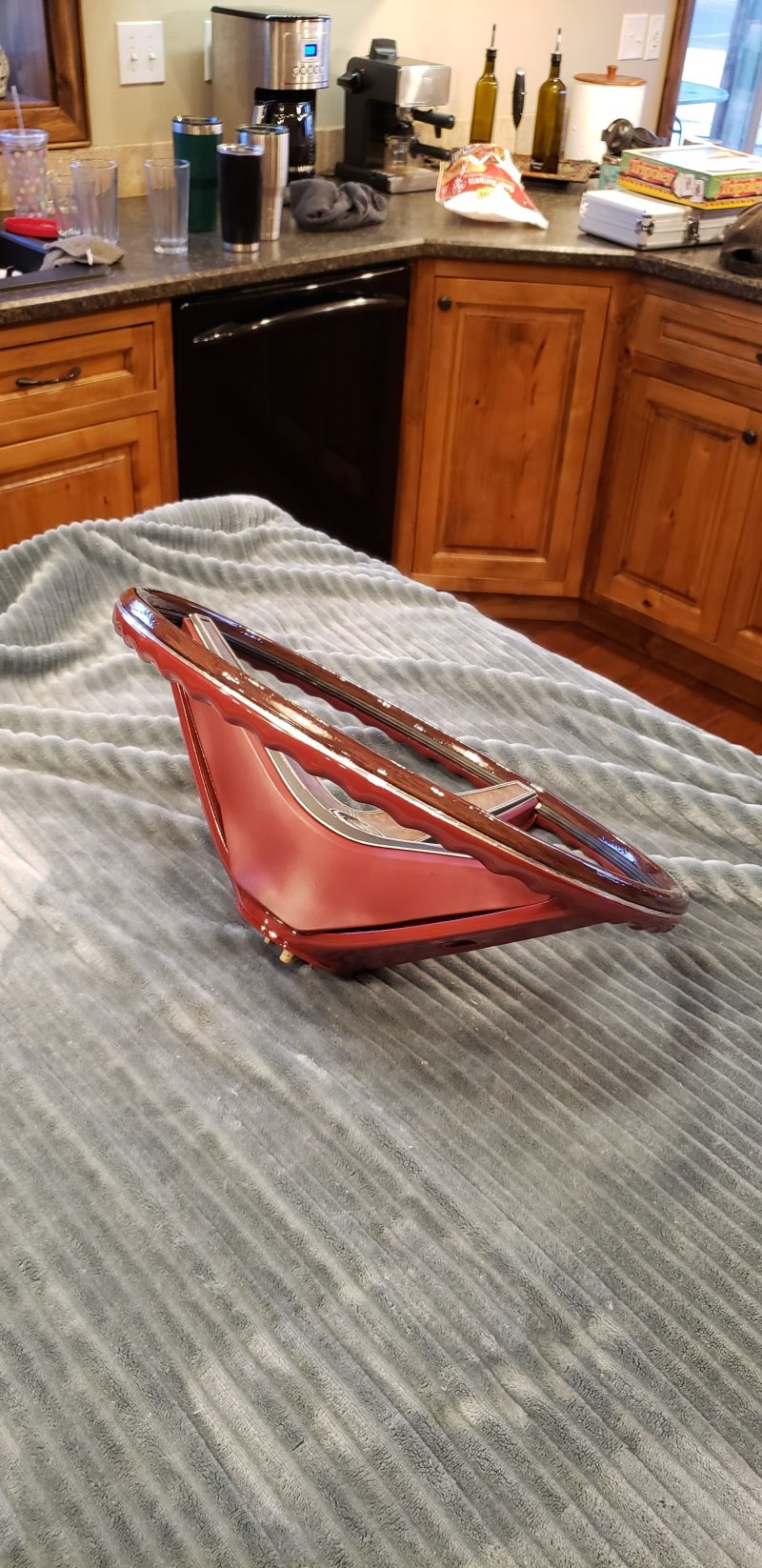

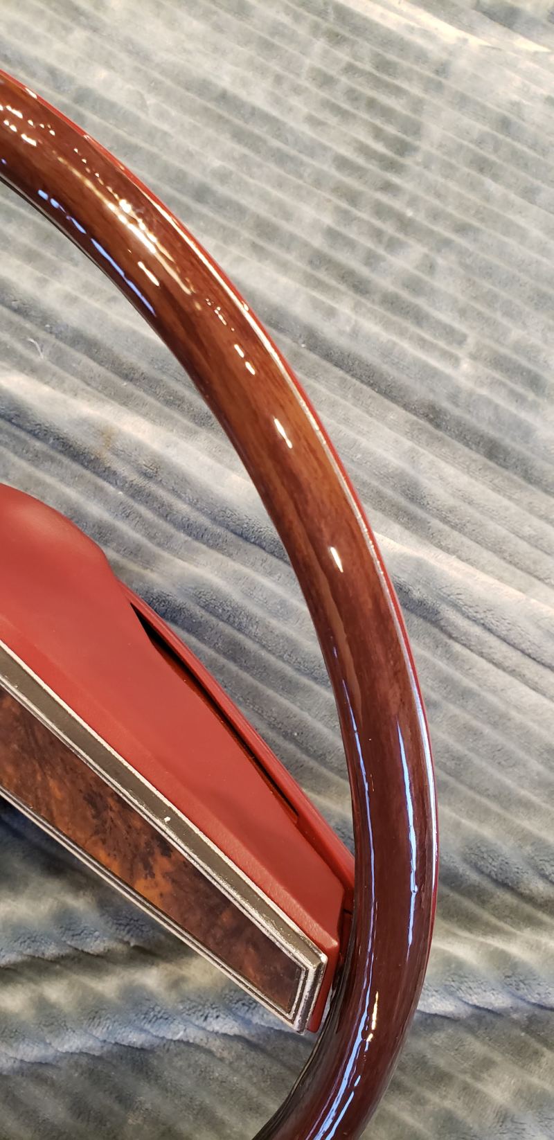

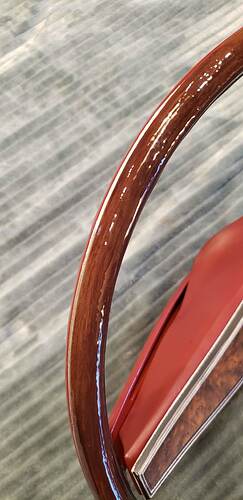

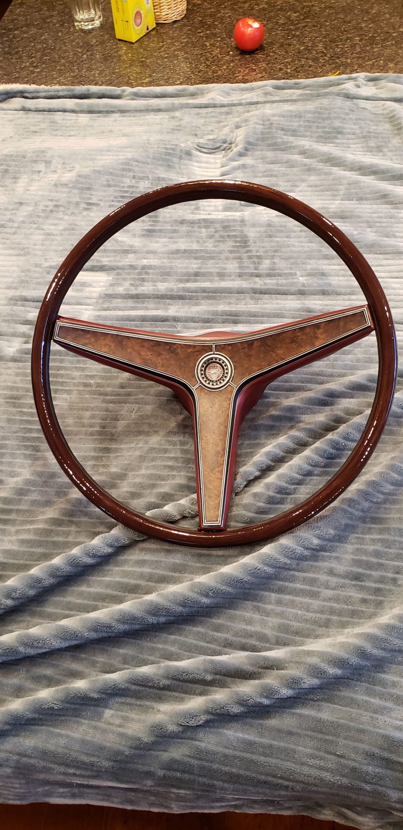

Progress update: I’ve been steadily working on the car and have most of the interior ready to go back in. Dash repainted, all the ancillary vinyl pieces dyed back to like new and the latest ordeal with the steering wheel restoration and column rebuild. Had to completely go through the steering column due to years of butchery and overheated wiring. By the time I was done repainting it and putting everything back together I had torn it back apart three times. :sick: I have never had the guts or stupidity to attempt restoring one of these rim blow wheels but figured what the hell, I have several pieces of crap that are no good so lets go for it. I am pretty happy with the result!
This wheel was rotted, busted and overall just plain crap. I epoxy repaired it and did my best attempt at restoring the center with a wood grain kit from WCC. The wood grain look on the wheel itself was a complete guess and crap shoot with all kinds of different paints and modified brushes to try to come up with something that remotely resembled stock. Not perfect but happy.

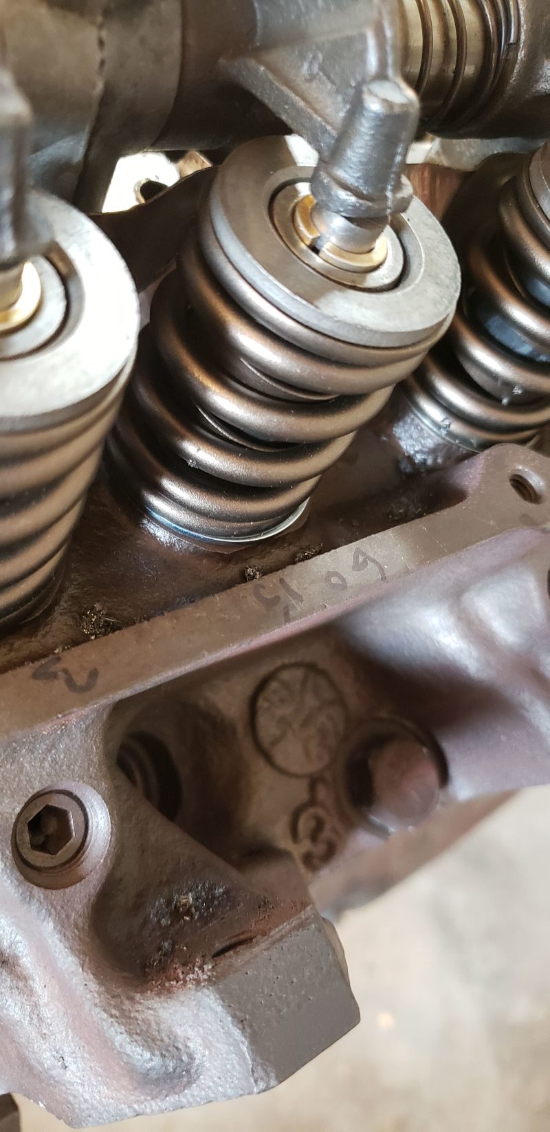

Got the engine back from machine shop hell on Friday… Unbagged it to start putting pcv and other goods on it only to find the top of the heads covered in metal debris… :imp: Somenone must have blown off a machine next to the engine at the shop. So it goes back tomorrow for a tear down and clean out and rebuild again since I am NOT going to take a chance on rare date coded and vin matched parts. Totally pissed! They had the engine for 16 months and this is what I get???
