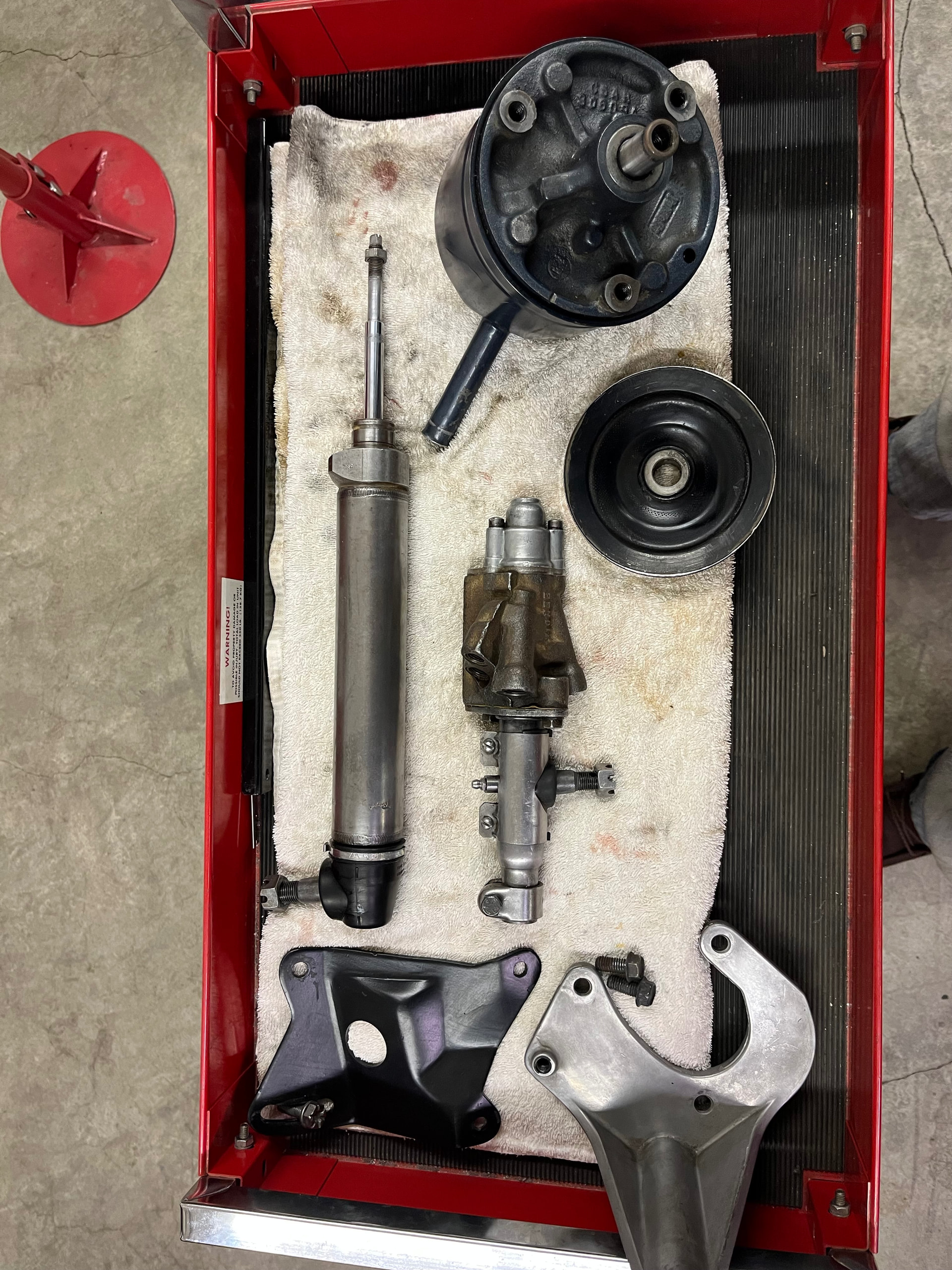

First I made a metal track for shifter light. Plastic one melted or something.
Cleaned out gas tank, lines, sender unit.
Brakes weren’t bad at all. Had to replace the master cylinder and had booster Steve rebuild the midland booster. This differential valve didn’t want to budge just pushing it from the middle so, I opted to the grease gun.

You need to send your sender to me for rebuild and calibration. I replace the thermistor with a much better component and also provide a brass float, filter, and seal ring. Every connection is soldered and zeroed out.
I’ll keep that in mind-thank you. I bought the parts from wccc and installed them. I’m very pleased that it works perfectly, now.

Having the same issue here with my centralizing valve in the brake proportioning body. Forcing it out that way works pretty well then.
I agree, works really well. Good way to get a stuck piston out of a brake caliper, too.
For my case, it was just about finding a plug and a fitting for the grease gun, that were the proper thread pitch. It came out no problem.

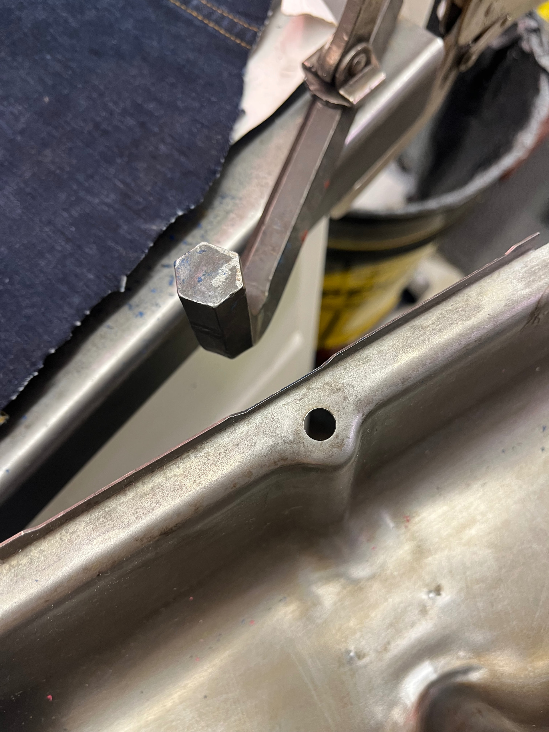

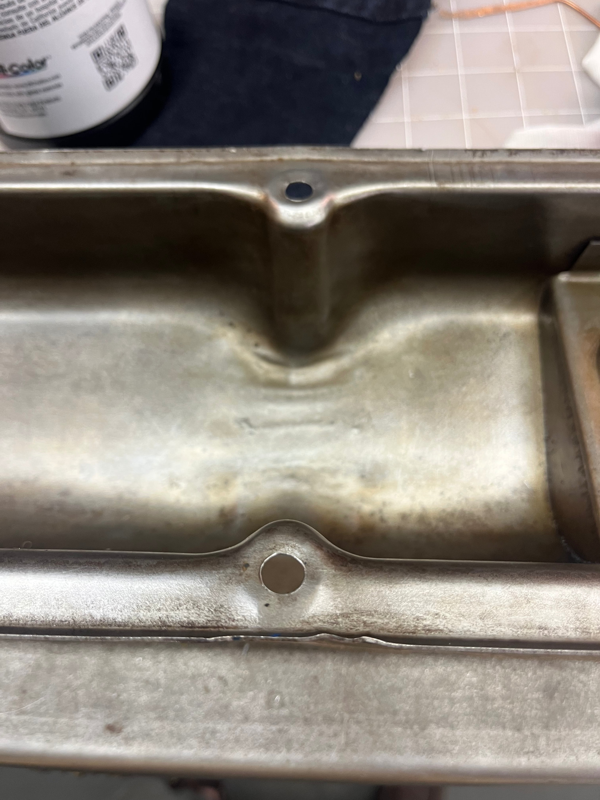

I bought a pair of these sight unseen but only need one, as the original was destroyed during the rebuild of the engine. It was replaced with one that doesn’t match exactly.
When they arrived, I thought it was a waste because they have been over tightened and need to be scraped and straightened. I guess if you see rtv on them, that’s not a good sign??
Then I thought…..they can be straight again so I asked my young son who is taking an auto body class. I think he gave me good advice because it worked!!
I still might get some better ones later on, but here is how it went.
I started with the one I didn’t need, for practice. It was the worse of the two.
