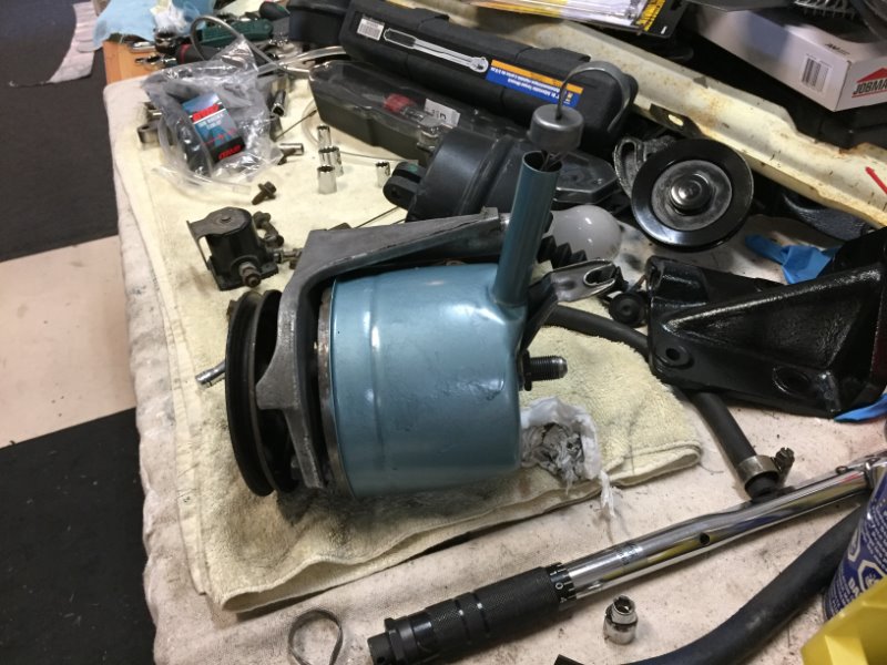

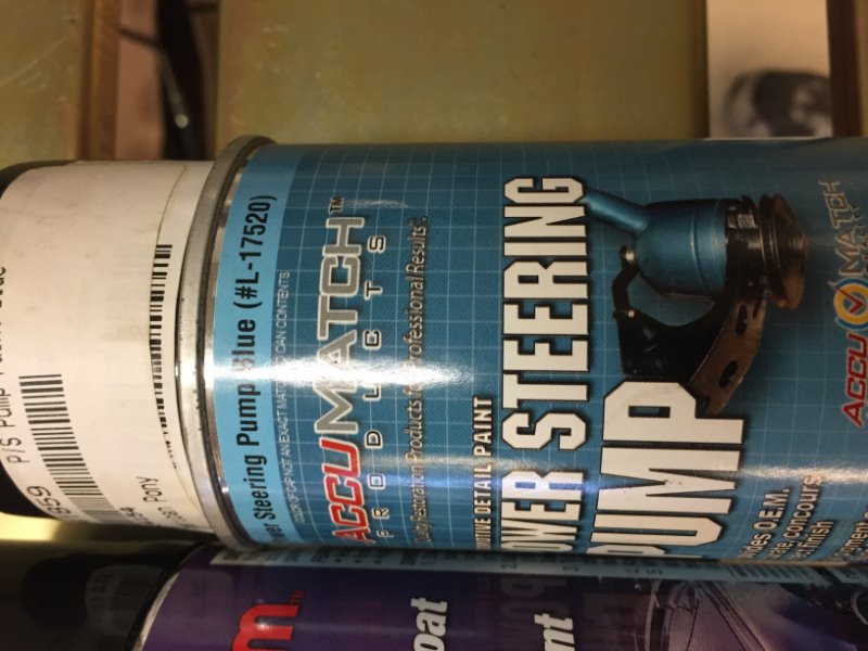

Paint.
WCCC you need to carry this ![]()
http://www.virginiaclassicmustang.com/Mustang-Power-Steering-Pump-Paint-P482416.aspx

Remember not all power steering pumps were that color. If I can find the information on what ones Iâll post it.
I donât like that color, to me it is not right. To light.
Iâm not a fan either. I get that in some cases itâs âcorrectâ and thatâs cool for the concours guys, but I just think itâs ugly and clashes with the blue engine. Satin black for me!
Is it because you feel it doesnât match original examples of the color ?
Yes I belive it is not a match. I took my power steering can to a paint store and matched to what I though is the correct shade.
correct color is PPG Dark Sapphire Blue Poly.
I had it made in DCC concept- single stage -Acrylic Urethane 4-2-1 ratio

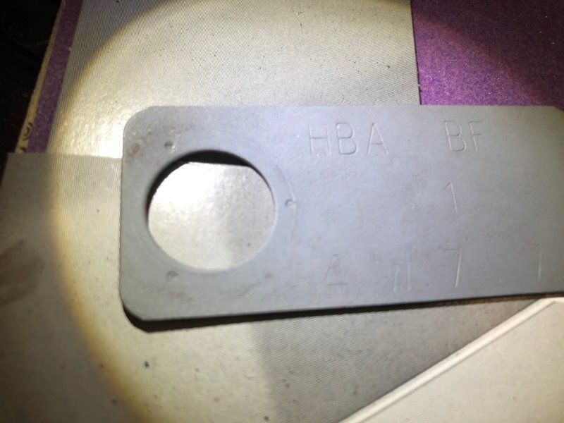

Supplier Identification Pump Color
TRW On tag â âWâ 2nd digit in bottom line Black
Ford Thompson On tag â âFâ in center line Teal/Blue
As I recall, the paint I used was from NPD (teal) and it was a very good match, think the thread above refers to working with NPD to get it right.
Thanks for that updateâŚFunny, I looked all over NPDs site and couldnât find it! SighâŚNow I wonder if the can I found at NAPA isnât in fact a better version (Iâm 99% sure I have the Ford Thompson) HmmâŚ15.00 test I guess ![]()
Remember that the color has faded. The match I had done was to a area that was under the tag & housing nut. The body was really washed out in color. The Boss & CJ sites listed this color many years back âŚ
I got mine from NPD. I found it to be an excellent match to what was on my pump to begin with.
My understanding is that the Teal paint was like the slop gray - a âbatch paintâ made up of waste paint (of appropriate shades and metallics, of course), and the actual color will vary from pump to pump.

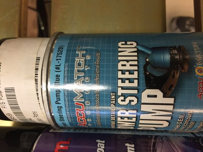

Paint.
Mustang Power Steering Pump Paint
Thatâs the stuff I have. Bought it two decades ago and it looks great.
And after all that, I have the TRW Lol.
Black it isâŚthe more you knowâŚ
