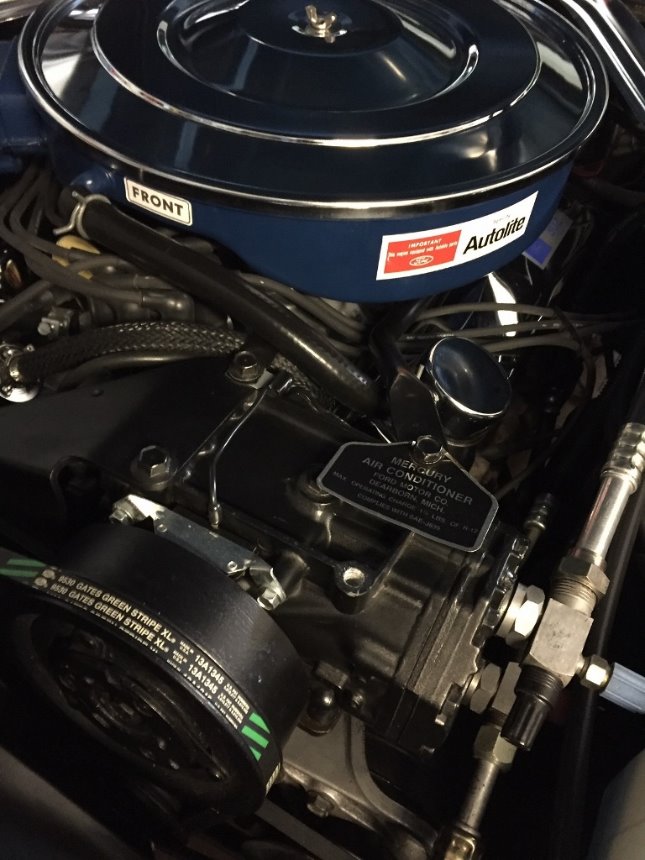

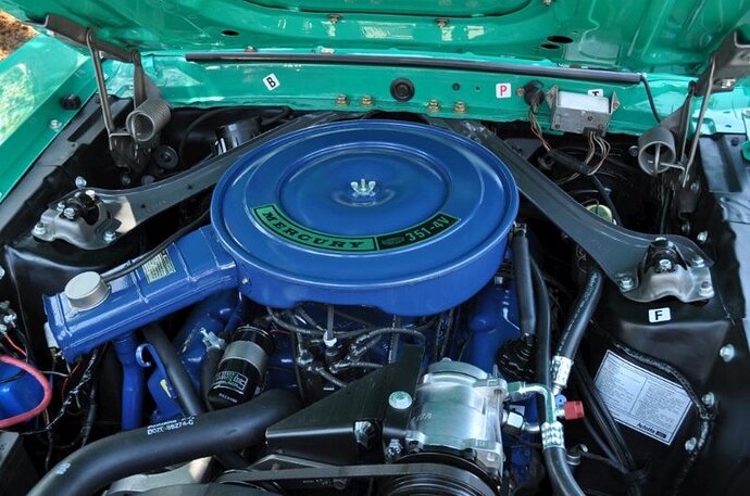

Check out Original Air Group, they should have everything, whether stock replacement or upgrade. Here’s the stock replacement hoses. My thinking on this has changed somewhat, and as much as I like things looking original, I do like the idea of things working more efficiently, a lighter and less bulky compressor, and converting to r134 for easier servicing in the future. Plus I’m not sure if I trust the 50 year old compressor or my old crusty hoses. So I think I’m gonna do this upgrade kit since I already have everything else. I guess if I want to get fancy I could try to paint the new compressor black, but probably won’t worry about it.
I ran across a couple old pics of Jeff B’s 1970 engine bay with the new style compressor and it doesn’t look bad at all IMO.

Classic Auto Air has a great kit & has options for R12 & 134A. Looks just like Jeff’s & works very well!!
Yep, Original Air Group is a division of Classic Auto Air, I should have mentioned that.
Classic Auto Air is what I used for all the underhood components when converting my factory A/C car to modern 134A. I’ve never had a problem with it since I charged the system about 8 years ago. It will freeze you out of the car in 100 degree weather and the compressor is smooth and quiet. I have zero regrets.

Thanks for the compliment but this car is no trailer queen. It’s got nearly 25K miles on it since I finished the restoration. I initially went with the CAA evaporator but it had a defect from the factory so I had to pull it out and decided to go with the original evaporator after testing and flushing. Mine was done while outside the car but you can probably flush it while it’s still in the car. As for the compressor, you can use the original compressor but if you want maximum efficiency and lowest drag, I’d go with the modern Sanden compressor. I’ve never questioned my decision when it’s 100 degrees out after a long day in the sun and I get in my car and it freezes me out within minutes.
