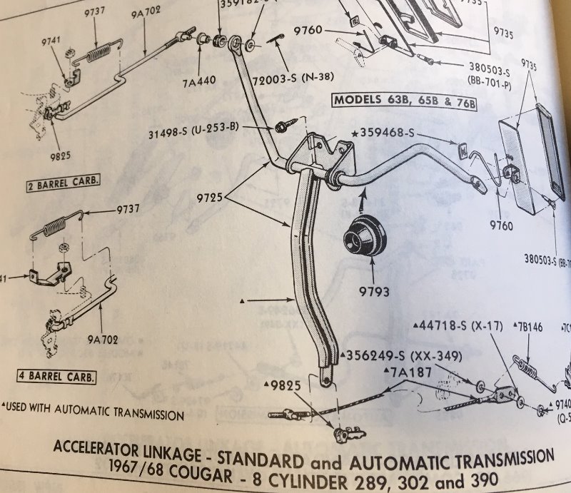

Could someone post of a photo of the correct throttle linkage on the carburetor of a 67 base manual ?
Mine had been fiddled with would like to know how it’s supposed to be.
Mostly interested in understanding where and how to attach the spring.
What i have doesnt match the drawings in the shop manual.

On mine, one end of the spring hooks to a metal tab on the LR carb stud, the other to the bend in the rod.
Research “67 Cougar throttle linkage pictures” and you’ll get a couple of good pictures.
If your current carburetor base doesn’t have a good place to hook it, you can also hook the spring to a hole at the bottom of the throttle plate linkage (if that’s the right term). The plate that the actual rod hooks into on the carb, that pivots. But not all carbs are set up the same way, and you’d want to make sure it can move through its entire travel without catching on the spring. You’d probably want to use the ‘skinny end’ of the spring instead of the end with coils to prevent interference.
It’s how I set it up when I foolishly put a Holley on my original '67, and it worked fine.
I will post pictures from the assembly manual for you if you can tell me engine displacement. I presume a 289 two barrel?
The spring bracket (9741) is available in reproduction from any of the part vendors.

Thanks - i have the electronic version of the shop manual and the diagram is hard to read, so that helps !! :slight_smile:

Looks like you have all the right parts. They are just installed in the wrong places.
Here’s how I put it back - assumed the slot on the bracket Meant to go on the bulge on the carb
https://1drv.ms/u/s!Ah_UnD0RcCuAnd1-YPTSpIqATJRFRg
That’s not exactly the right bracket, but it will do the job.
That is the correct bracket and installation for a 2V equipped car.
