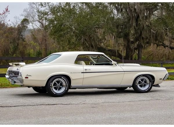

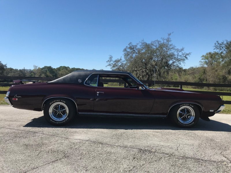

I have Magnum 500 15x7" w/4.25" offset with 235 60 up front and 15x8" w/ 4.50" offset with 245 60 on the rear of both of my 69 Cougars.
Hey Bryan, what paint code was shot on the STD? It looks period correct so maybe a Ford or Mercury color not available for Cougars?
I understand all of that but the OP isn’t considering putting large tires on the rear. In fact, the front ones he proposed are a little on the small side. My comment was specific to his tire selection. My lowered car has no clearance issues and I run 235/60/15’s all around. You can keep the same size tires and modify your stance with different suspension choices if desired.
Both of my Cougars are factory colors. The Eliminator is code M (white) and the XR-7 is code B (Maroon). The picture of the XR-7 makes it look darker than it really is.

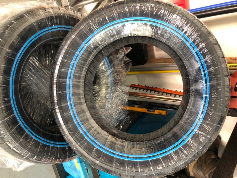

These just arrived today from Diamondback Tires. Dual 1/4 inch WW. They are going on my 70 XR7 convertible with new Legendary Magnum 500s. BFG Radial T/A 225/60/15 all around. Just need to find a set of black walking cat center caps. Can’t wait!
Ah yes, remember them well. I was detailing cars back when those were popular. The narrow deeply indented whitewalls were a PITA to scrub clean. But it’s a cool vintage look!
