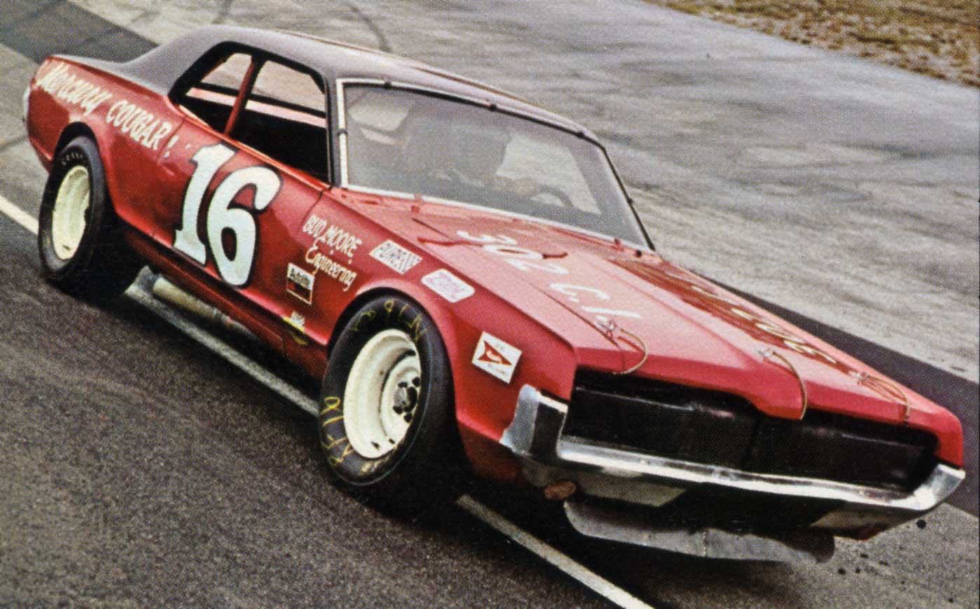

I plan on mostly running a stock body, I have rolled all of my inner fenders for tire clearance though. I have considered modifying the wheel arc’s to be like those on the Max Effort Cougar pictured below. I love that they managed to do flares with the factory lip shape. Imagine those wheel wells filled with some fat Goodyears. I go back and fourth on whether or not I’d like to do this.

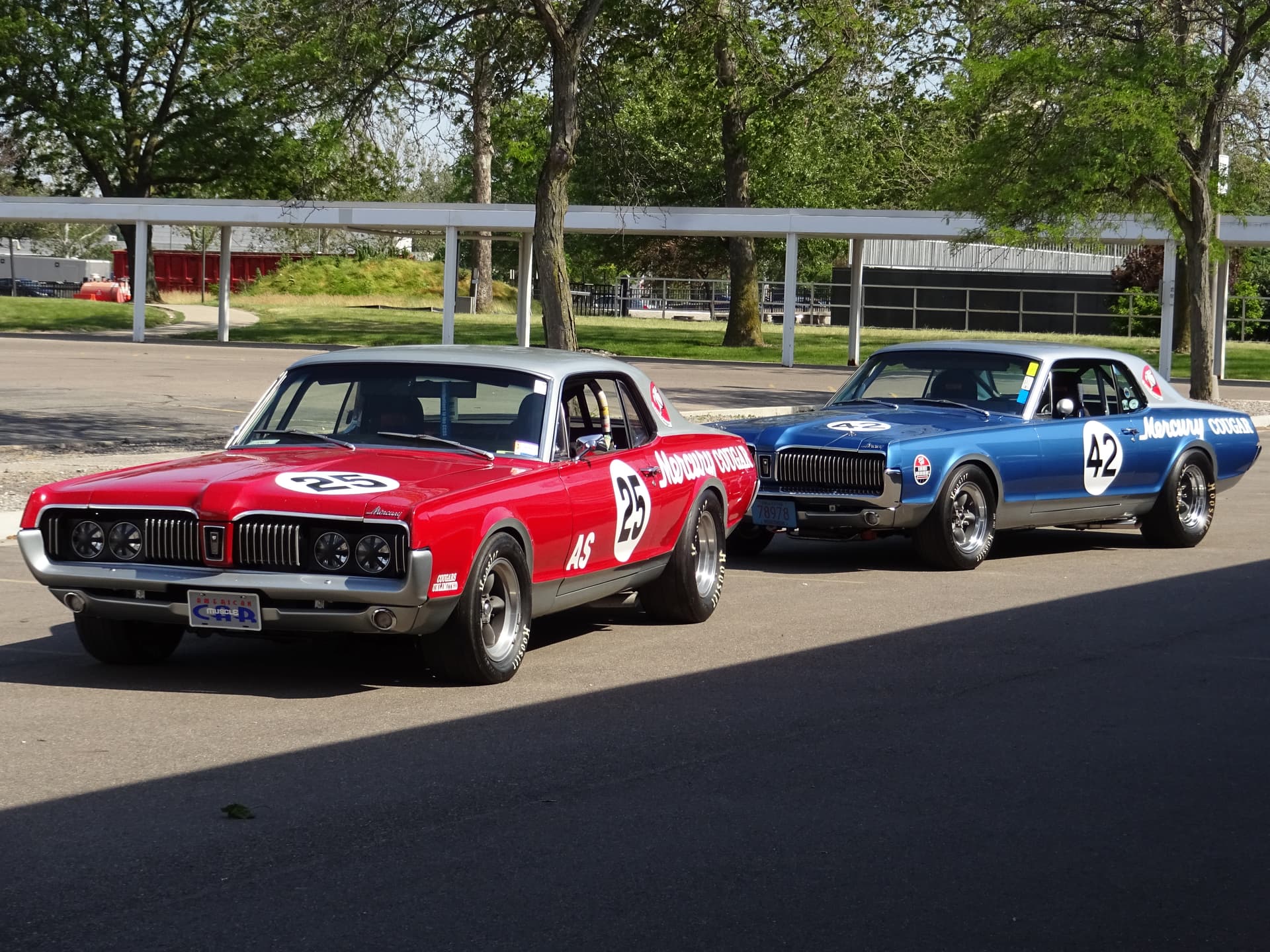

Looking forward to tracking the progress of your build. I’m a huge Dan Gurney/Bud Moore Engineering/Trans Am/Grand American racing Cougars fan.
I also have recreated the BME Cougar livery for both the TA and Nascar Cougars, so let me know if you want any of those decals.
Here are some more pics I have in my files for inspiration.
I have roller spring perches and LCA’s for sale, also the tower braces for sale.
Thanks Propayne! Aside from paint scheme, the #15 car pictured is exactly what I’m shooting for aesthetically speaking. Crow’s foot torque thrusts wrapped in Goodyear Bluestreaks with a stance like that. It might be controversial, but my car has always been a satin black (more of a faded grey now) and I’ve fallen in love with the way the color highlights the lines of the car. I won’t be doing any decals on it as I’ve always been a sucker for the look of a racecar before its been stickered up. I will keep you in mind for a racecar decal project I’m working on with friends!

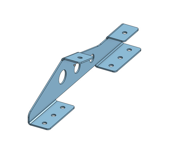

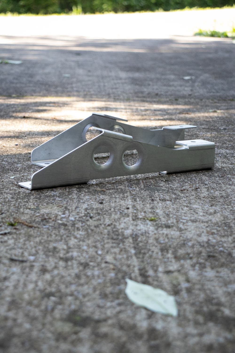

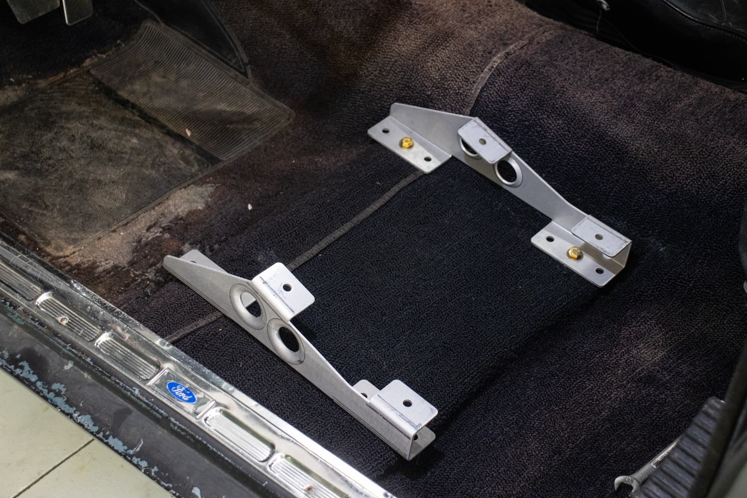

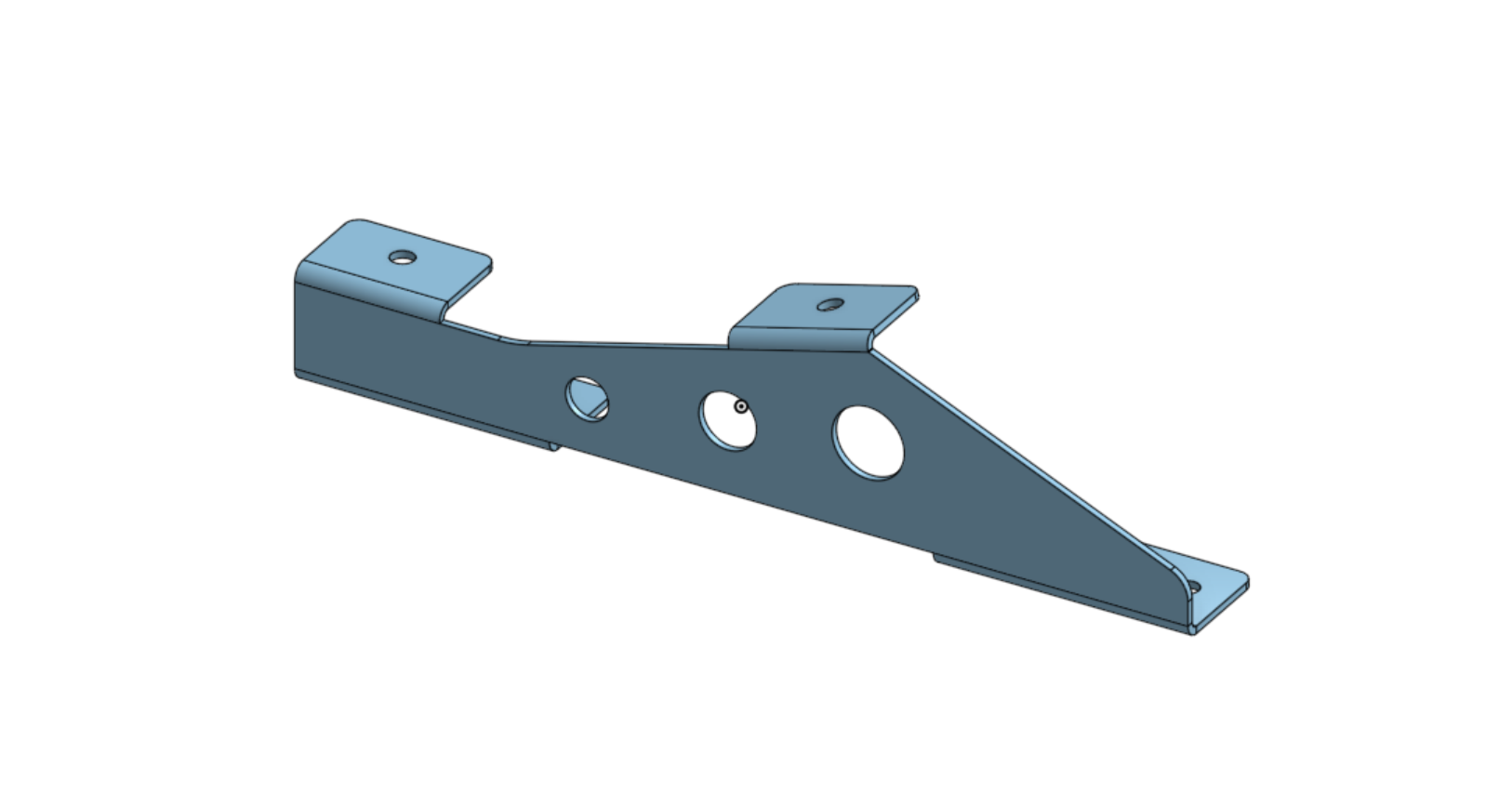

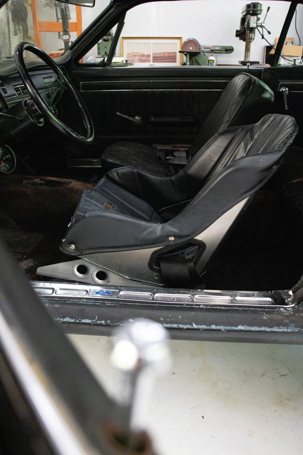

Its not much, but here’s the latest update. I’ve been running a vintage low-back Kirkey racing seat for awhile, but never really cared for the mounting setup that the previous owner of the seat came up with. I was looking around for mounts for the chair and found the universal mounts that Kirkey produces, which is what the previous owner used. It took some modification to make them work, but even then they weren’t great. The second alternative was a set from Henderson Race Shop, which didn’t appeal to me because they were too modern looking in appearance.

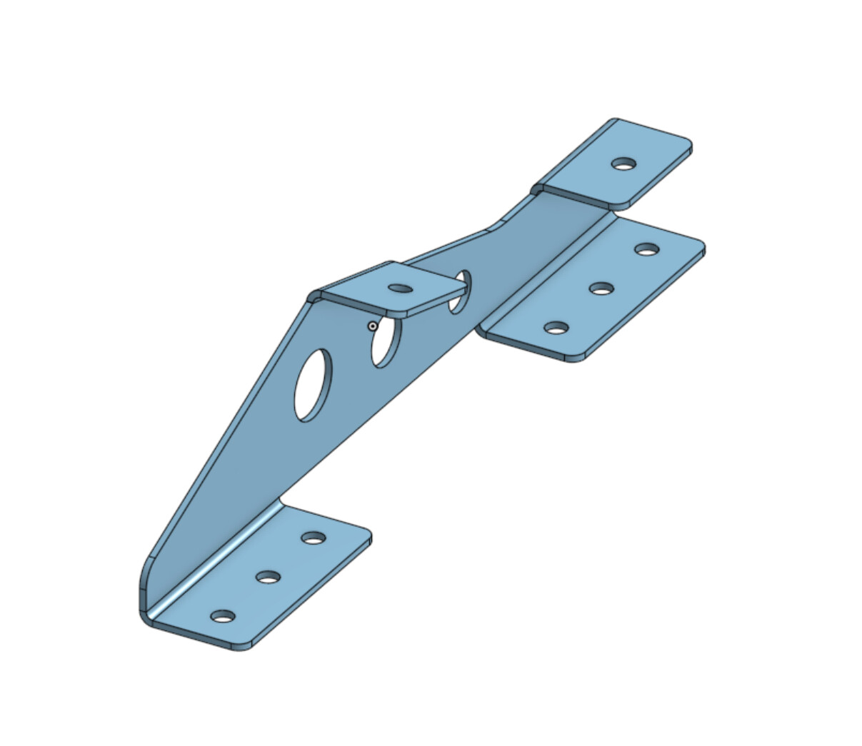

So I decided to make my own using the Henderson design as a basis for inspiration. I used OnShape CAD to draw them up. I’ve been wanting to try out Send Cut Send and this was the perfect project to try it with. I had them use 0.125 5052-H32 Aluminum for the first set, and had them do dimple die and folding services since it was really cheap to just have them do it. While I could have fabbed these mounts on my own, it would have taken much longer and the quality wouldn’t have been nearly as nice as it was laser cut.
Overall I’m happy with the finished product, they feel plenty rigid and they fit almost perfectly. They are adjustable fore and aft by 3". I believe the design could be easily modified to work with a normal Mustang/Cougar seat slider system if one wanted to go that route. The only potential problem I can foresee with these is possible cracking at the tabs because the metal grain runs parallel to the bends there unfortunately. I will test these for awhile and see how they hold up and then maybe offer them for sale. They definitely give more of a vintage race car vibe when you open the door.

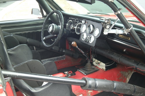

I built my 1967 T/A Cougar in 1993 and helped Ken Houck build his 1968 Cougar in 1997. I road-raced my cat on the vintage circuit in NM, CO, AZ, OK, and WA until 2004. I put together a spreadsheet that details many of the mods and parts used - vintage racing legal. The spreadsheet has helped several other folks build their cars.
LMK if you want a copy or have any questions.
I recommend that you download a copy of the 1970 Boss 302 Chassis Modification Guide - it describes many of the features needed to make your car competitive.
It contains plans for the 6-pt roll bar cage needed to stiffen the chassis. With this cage, we didn’t need sub-frame connectors or convertible floors/rockers.
BTW: Your seat mounting brackets look very well designed. How much do they weigh?
Thank you for the kind words! I remember your website well from when we first purchased the car, dad and I were using it to trouble shoot the sequential turn signals. So thank you for the help back then as well! At the time I didn’t realize that was your racing car on the website, it looks great! I would love a copy of that spreadsheet.
My main hesitation with doing a 6 pt. cage is that this car will be mostly street driven, with occasional track days and I don’t want to make it too difficult to get in and out of. I have seen installations where the bar comes down lower in a less intrusive manner, even one with a bar that pivoted open with the door. Definitely something I’ll be putting more research into.
I’m away from the car at the moment on a trip, but when I get back to it I’ll weigh the mounts and let y’all know.
