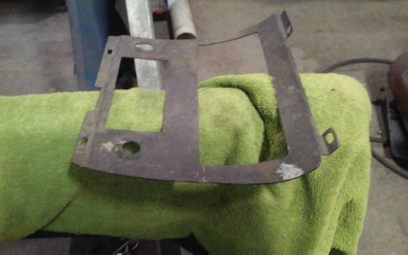

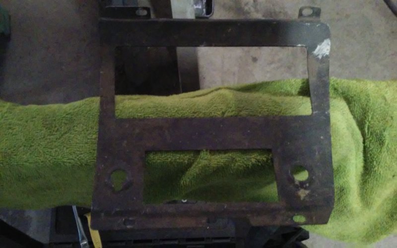

Here are photos of a mystery part I have. Is this from some year Cougar? It was in my car when I bought it along with other misc ford parts. No numbers, black wrinkle finish.
So I kinda dropped the ball on this post. Does the last part pictured look like anything from any year Cougar, and if so what’s the value of it?
As the transmission and the carb, values?
Thanks!
The radio bezel piece does not look like any I have ever seen in any Cougar. It might even be GM, maybe first gen Camaro?
I’ll guess the radio bezel is late 60’s Tbird. The yellow dipstick tube was used on 69-70 428 CJ cars.
So is there anything in the numbers on the trans that I posted that would tell us if it was indeed in a Cobra Jet car, and does that make it anymore valuable? I have yet to find the numbers that Neal is saying should be there. Clearly on a flat spot in the main case just before the tailshaft extension.
Randy, any thoughts on what to ask for the carb?
I guess I will just pitch the bezel piece. Probably not worth much anyway.
