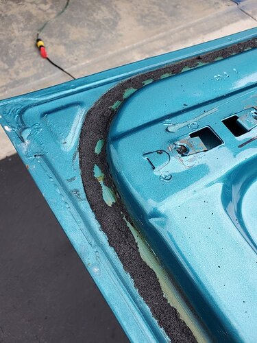

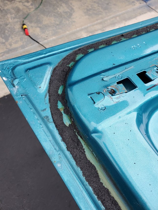

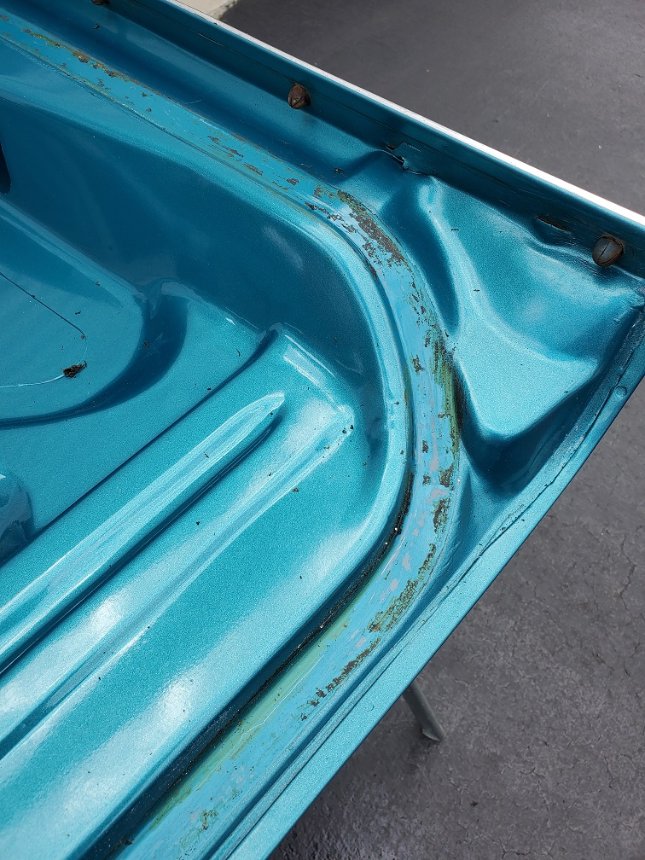

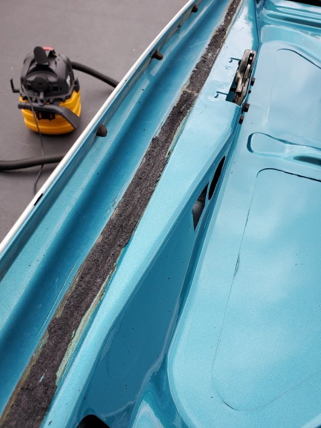

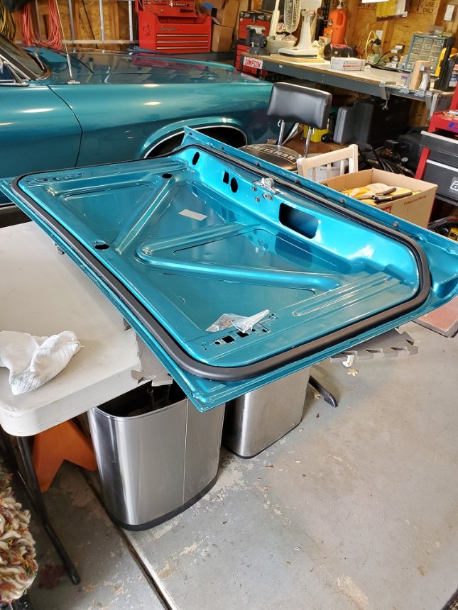

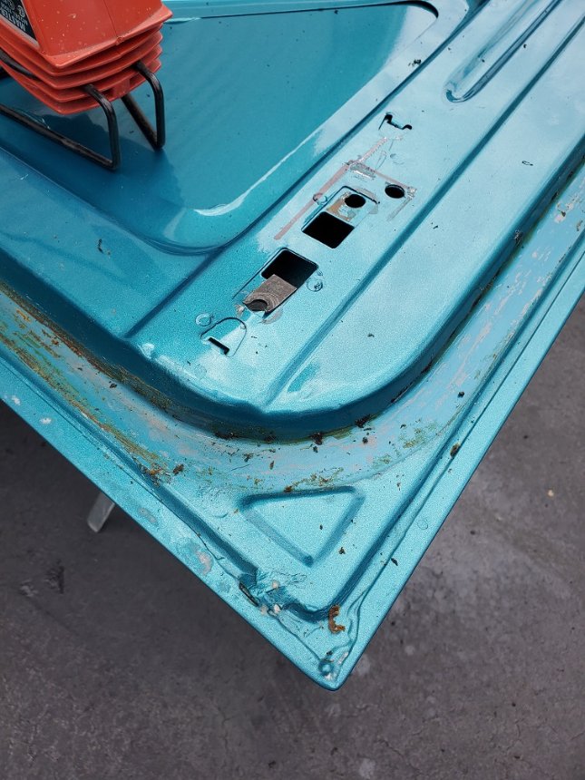

Ok, Job is done. Getting the old seal off, What a pain, I used 2 different “adhesive removers” (not the 3M, Couldn’t find it in stock) WD40, etc.
It started with slicing off what I could with the Razor Knife.
That’s what mine looked like after scraping off the old gasket too. You were smart to remove the deck lid first - I did mine on the car and won’t make that mistake again. Looks great - very nice to have that job done!
Yeah, I was originally going to do it on the car, then I looked at it hard, and said no, easier to take the deck lid off. I used the Sharpie trick for re-alignment on my Race Truck for the Hood, it came on & off more than I liked.

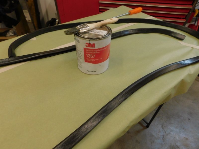

Be sure weatherstrip and deck lid surface have been wiped clean with lacquer thinner first. Then you apply the weatherstrip adhesive to both deck lid and weatherstrip and give it a few minutes to get tacky. I used acid brushes to spread an even coat on both a few feet at a time. Then make sure you place it where you want it, because you only get one chance.
Yes that is the procedure, both elements get a thin coat. as i said, work fast in small increments. the stuff dries quick, and once it touches the other side, it wants to stay there.

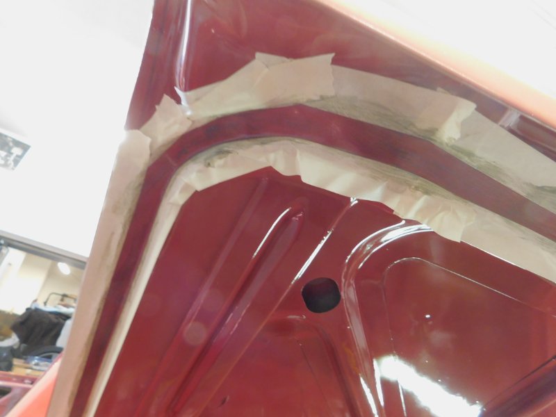

I mask off the trunk lid where the adhesive is brushed on. Lay it upside down on a table for easiest task. I’ve done it with the trunk lid on the car too, it’s not bad if the gas tank is out.
I brush the whole thing with 1357. It takes maybe 5 minutes to dry enough to stick them together. You have maybe an hour of working time so it’s not that hard and no reason not to do everything at once.

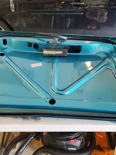

Getting ready to do my trunk seal later this week…amazed how hard/brittle the old one is.

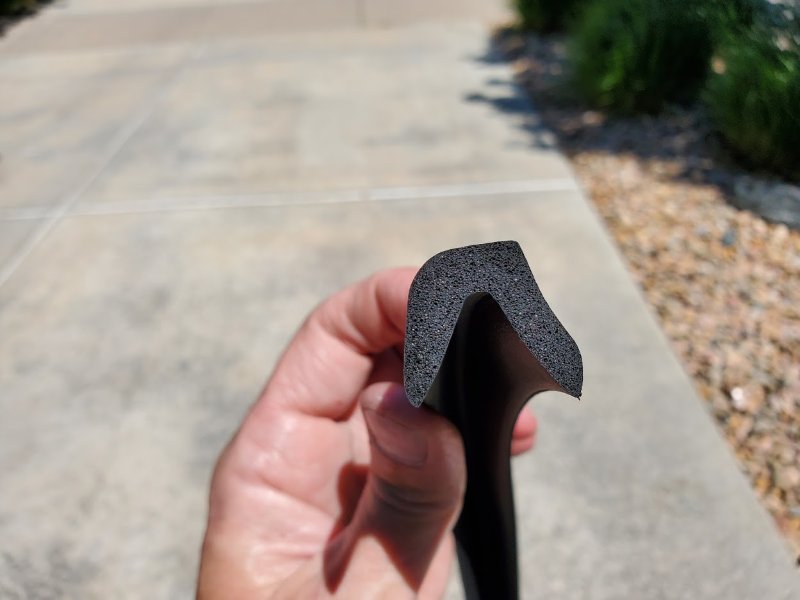

I’m double checking as to which side goes against the trunk lid…left or right? The left side seems to be flatter, so was thinking that side. I tried to compare against the existing seal, but couldn’t cut out a decent section to compare.
flat side to the metal. The “open” part of the seal goes to the inside of the trunk.
