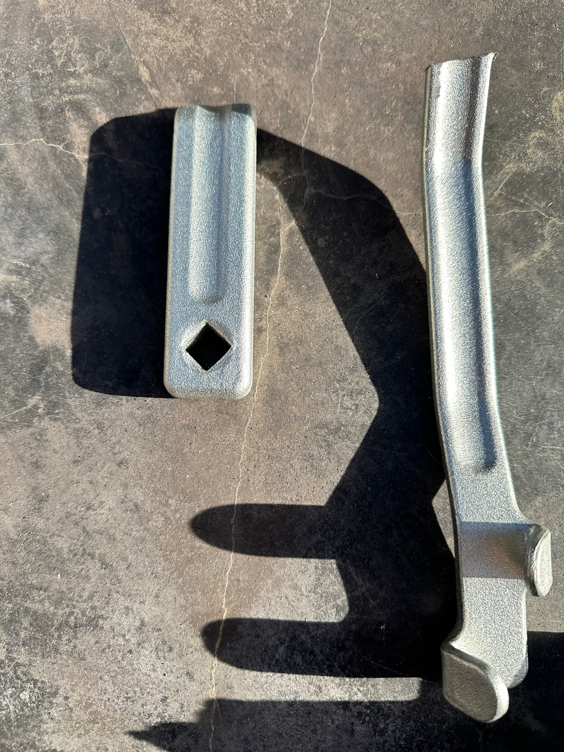

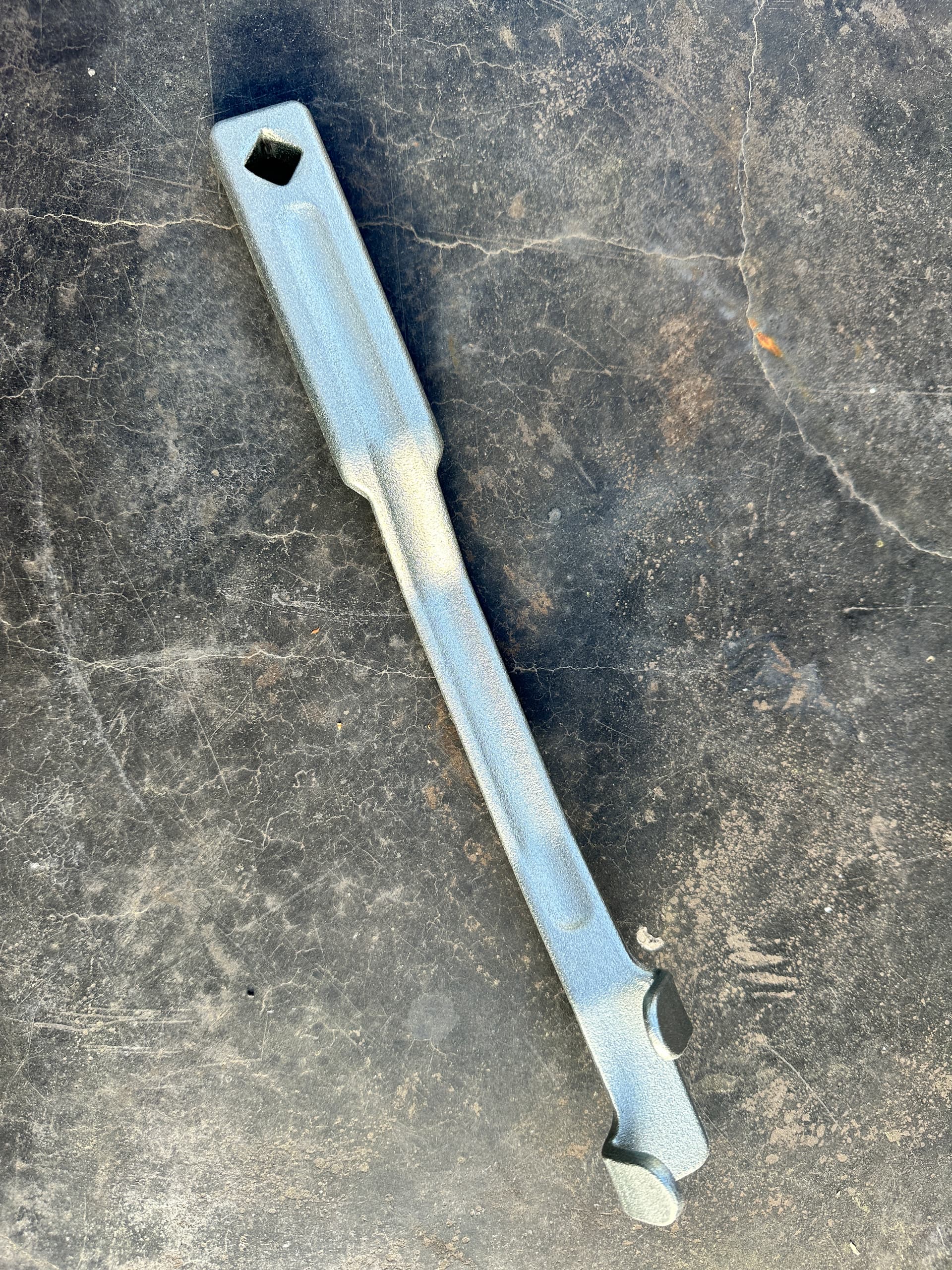

After some searching I found this Wrench Extender Tool Bar for 13 bucks…https://www.amazon.com/dp/B0DBZK8WR2

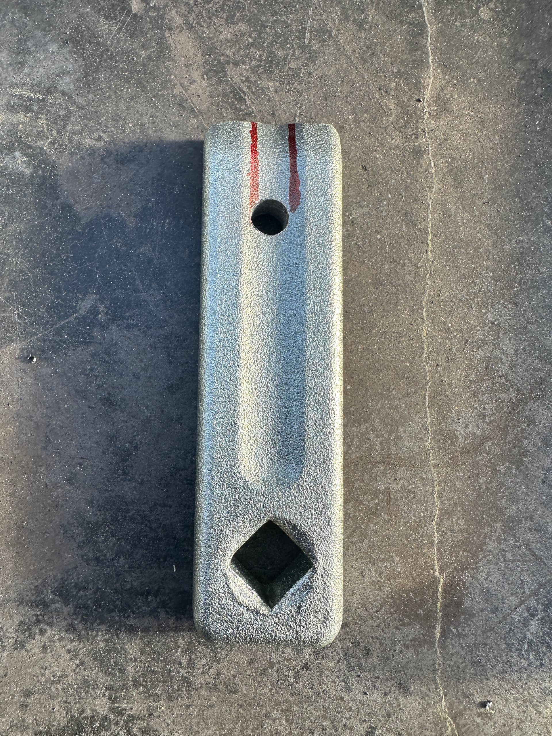

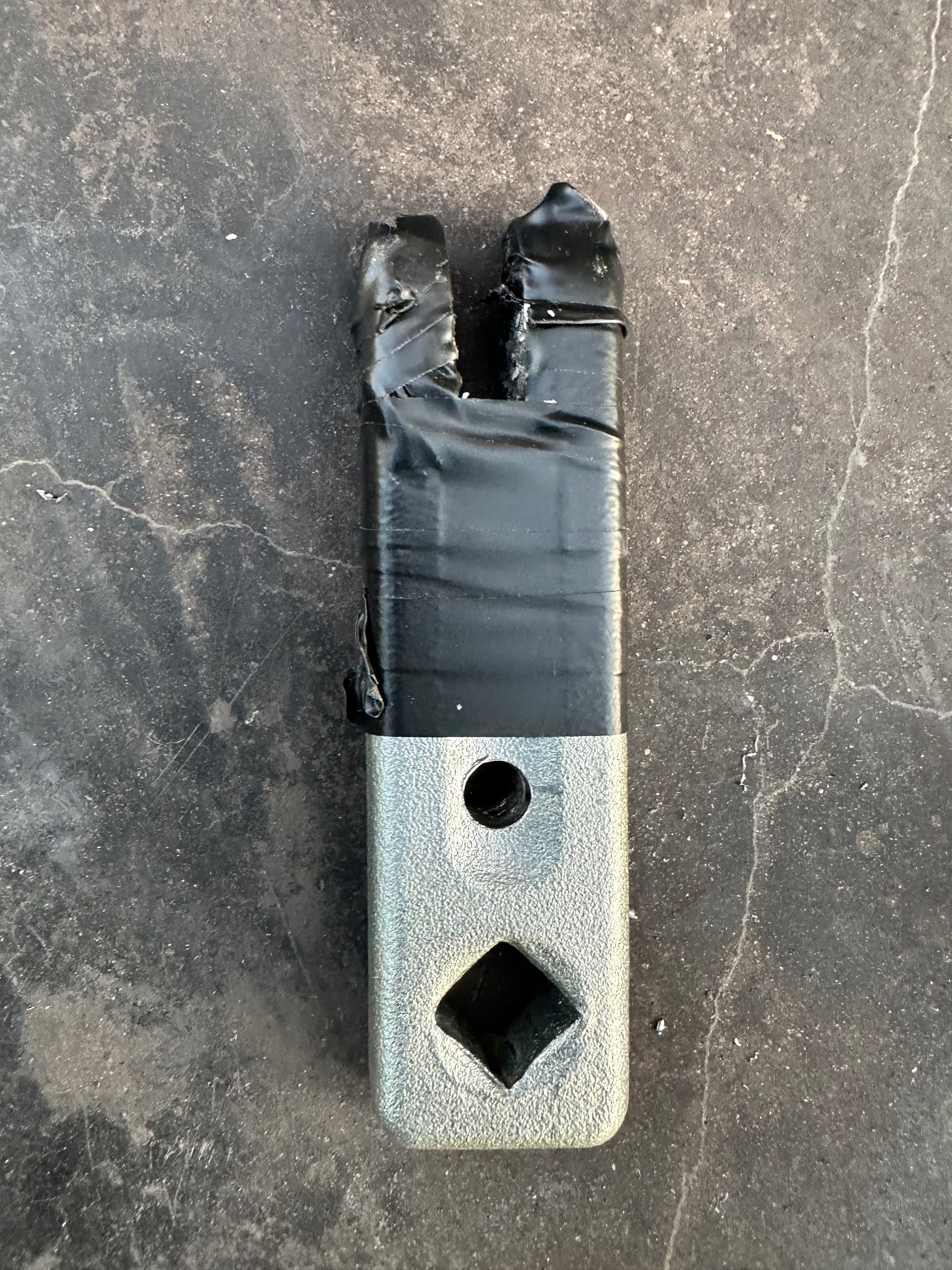

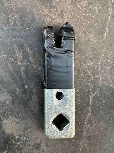

Luckily, it shipped next day and I received it today. The bar is thick and sturdy and was what I needed. Only difference was it utilizes a 1/2 drive adapter, not a problem. After a few cuts with a grinder, drilling 2x 5/16 holes and cleaning up the edges, the tool was ready. I also wrapped some vinyl tape around it to keep it from scuffing paint. Took me less than 20 minutes all together.
Bonus…you can still use the other cut part of the tool for extra leverage on a wrench!
