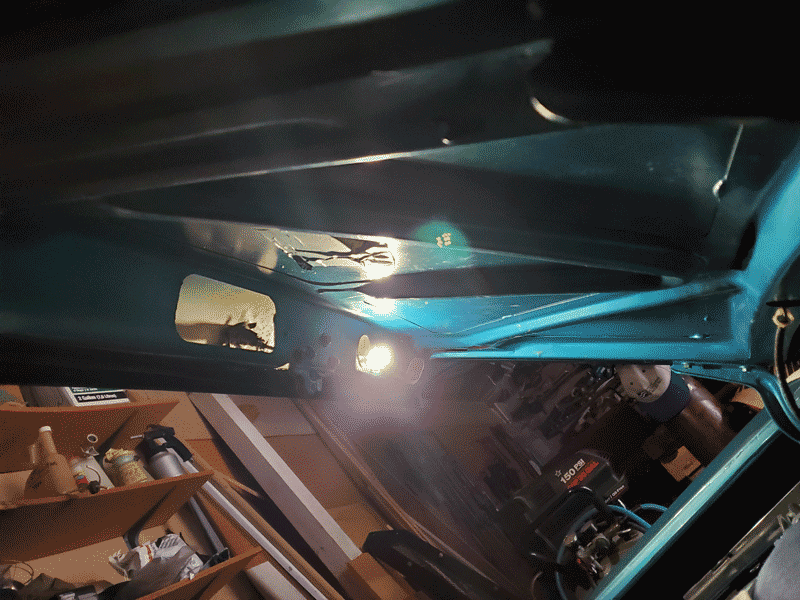

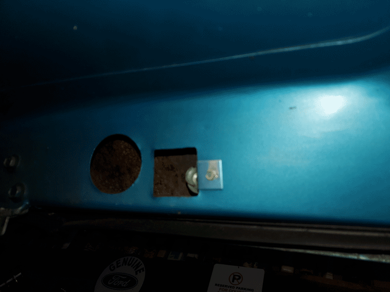

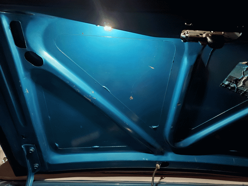

Could you please take and post a photo of your trunk light installed so I can see where I need to mount the light? I took your advice and got the trunk light from West Coast classic cougars but I am unclear as to where it mounts on the trunk lid.

The bulb socket mounts in the rectangular opening on the drivers side of trunk back. The power wire runs up from the center opening on the front of the trunk lid. There should be plastic ring protecting the wire in the round opening, mine is missing. The wire runs up the diagonal reinforcement on the trunk lid. I’m using an LED bulb. I took it our for one picture so you could see the socket and the mounting screw.
Hope that helps
Thank you very much. The information you provided is perfect. I really appreciate it. Best wishes and stay healthy, Tim
