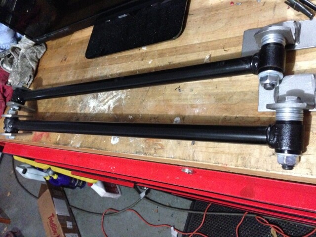

under ride bar install
finally got my under ride bars
installing this weekend
should keep the rear tires from tying to jump into the trunk
on wot 1-2 shifts
Are these the ones from Traction Master?
I am still waiting on mine, backordered…I am real interested to know how they weld up. If you could update with pics and how you set them up, it would be appreciated.
That reminds me , time to call MU and ask why after 60days they are not here yet :bs:
you can shorten the rear ears so you have better ground clearance. Mark w/ susp loaded & then remove plate weld & reinstall. You will be amazed!
10+ years of track time w/ these exact ones.
P.S. Call them direct & order from them. I’ve been a dealer w/ them for the last 10 years due to past “retailers excuses” = Minimum order to get a discount!
