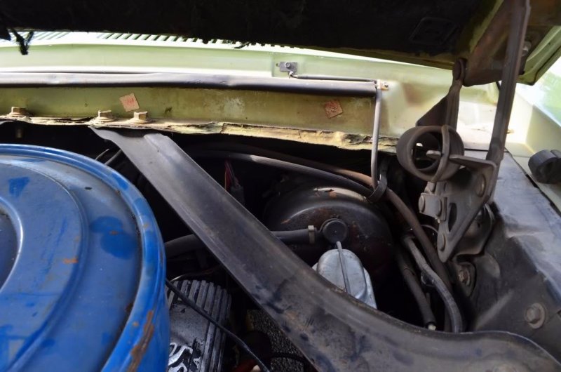

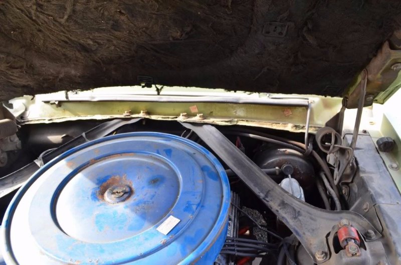

Here are a couple of photos of the under hood decals on our Lime Frost XR7G. The one in the center of the the cowl area looks like a W the other is hard to read.
