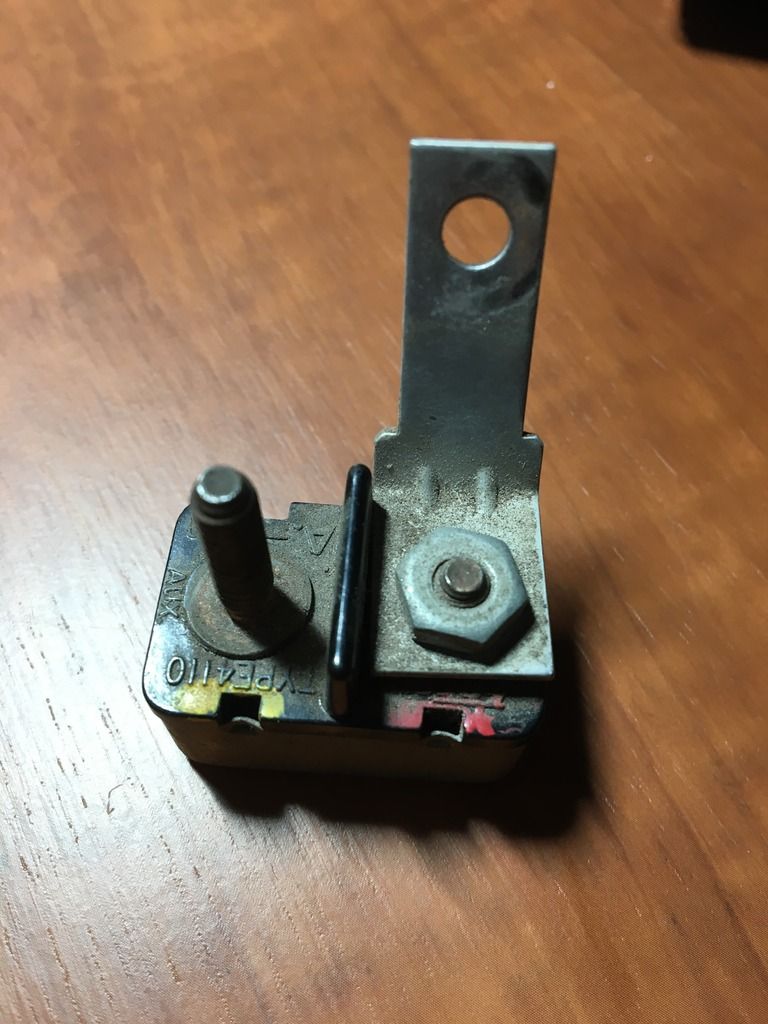

Hello all…I am replacing the ignition switch in my '67 GT and all seems fairly straightforward except for this lug breaker i found attached to the power lug on the back of the switch. Nothing was attached to the breaker and I cannot find a loose wire anywhere. Can anyone identify the purpose of this breaker?

if attached to the center accessory post, it’s bound to be a connection / circuit breaker for some aftermarket add-on. Sometimes a/c power ends up there

It was indeed attached to the accessory post. Just found that WCCC has the exact same breaker listed as an A/C breaker which is normally attached to the rear of the ignition switch. Since my GT has no A/C, I can only assume that your assessment is correct and that the breaker was being used for something else. I’m going to leave it on the shelf.
