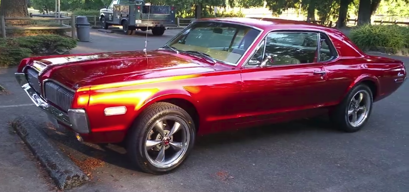

Nice color, and welcome aboard.

That is a bitching color, car too
I’m new to Cougars as well so I can’t comment on the switch, but just wanted to say “What a beautiful car!”
