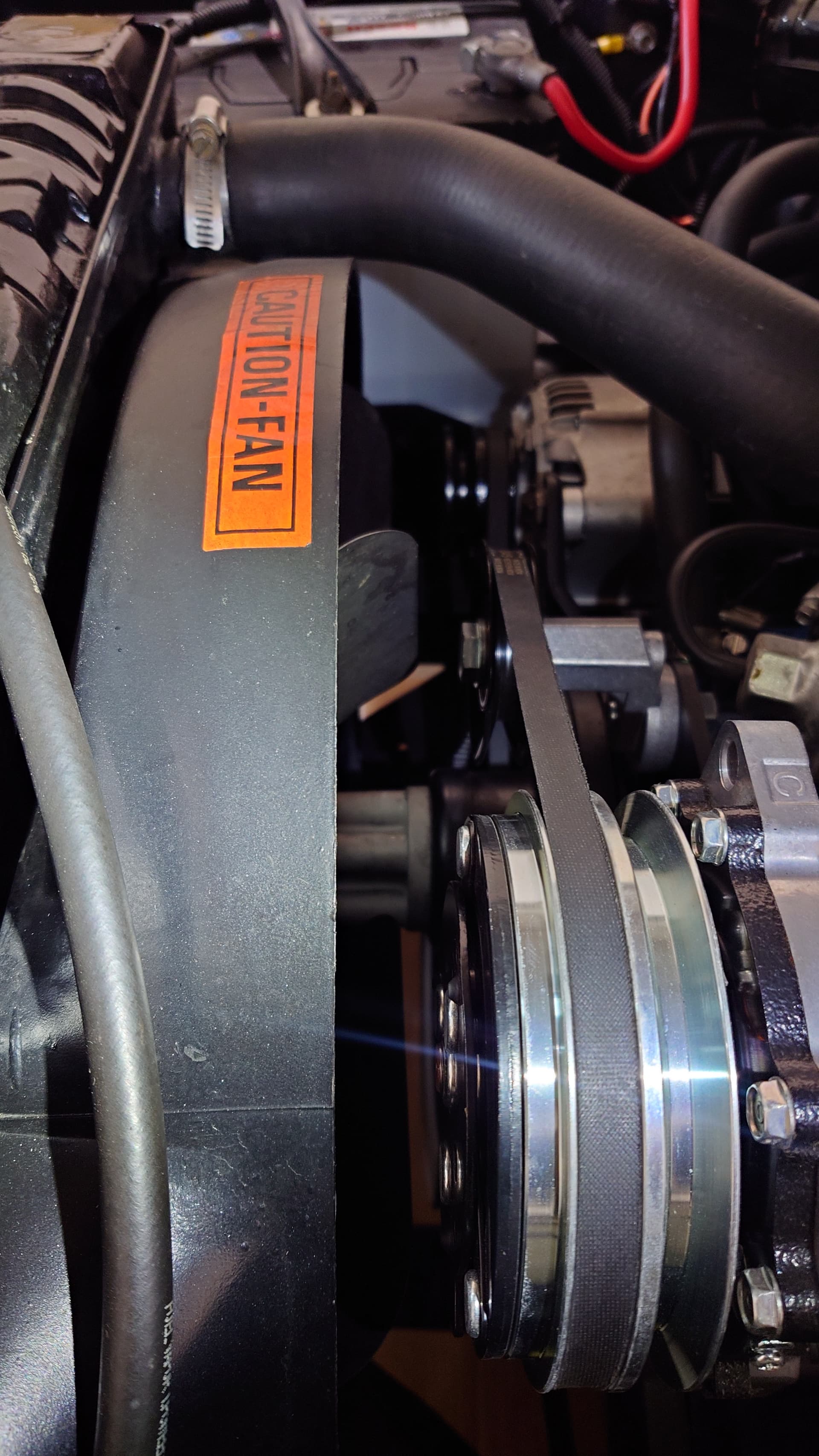

The radiator is 3 core and was recored, after that run 4000mile til now, and one more thing the current fan is half in/half out.

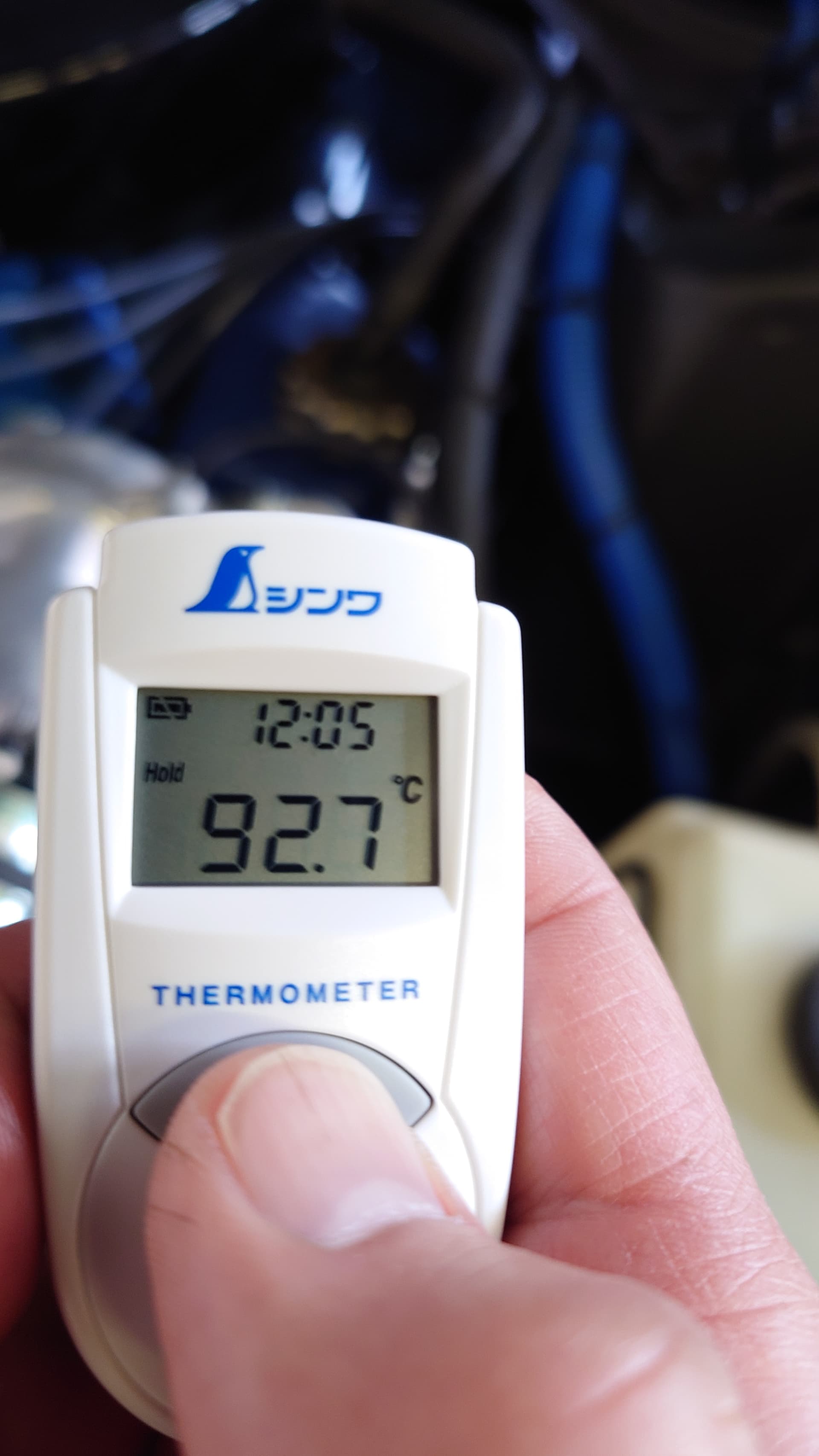

I purchased the infrared thermometer today, so would measure the temperature of those hoses.
If my understanding is correct, runs 170℉(80℃) upper hose and 150℉(65℃) lower hose with car temp gauge around 1/2 as an estimate in case the correct thermostat is put in?

Following this thread is saying the car does not have an overheating issue , it has an airflow issue !
If the rad was recored , was it done with a core with a high fin count ? They can effectively block air flow , especially with multi rows. The distance between the ac condenser and the rad also plays here . Does the car have a coolant recovery system . Important to keep the air out of the system . Did the car puke coolant or just get hot? All these are important to fiw what you have

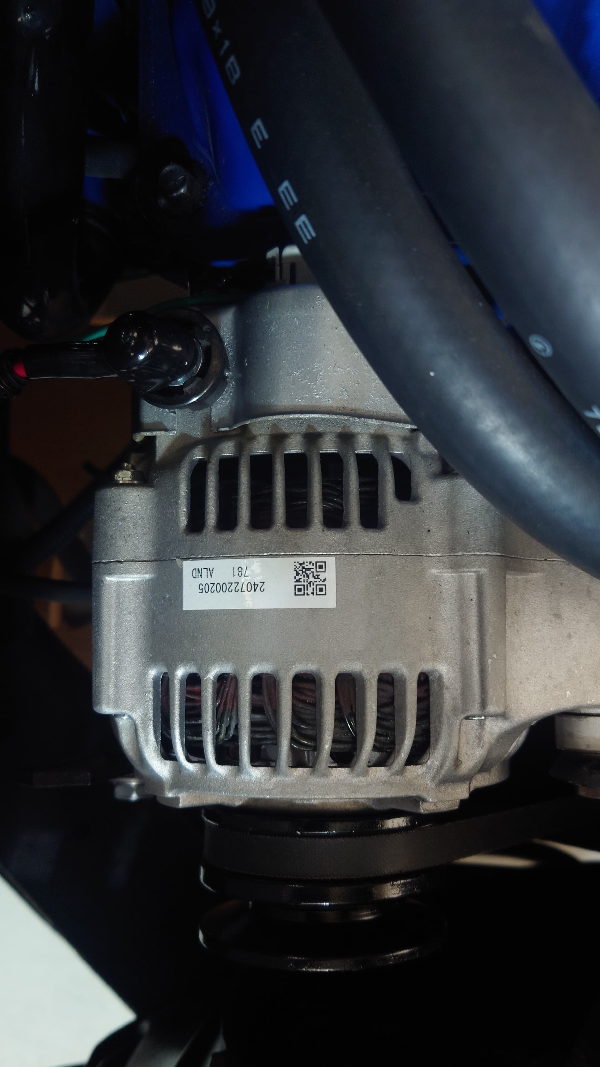

Incidentally, when I took a photo of alternator, there was something that caught my attention.

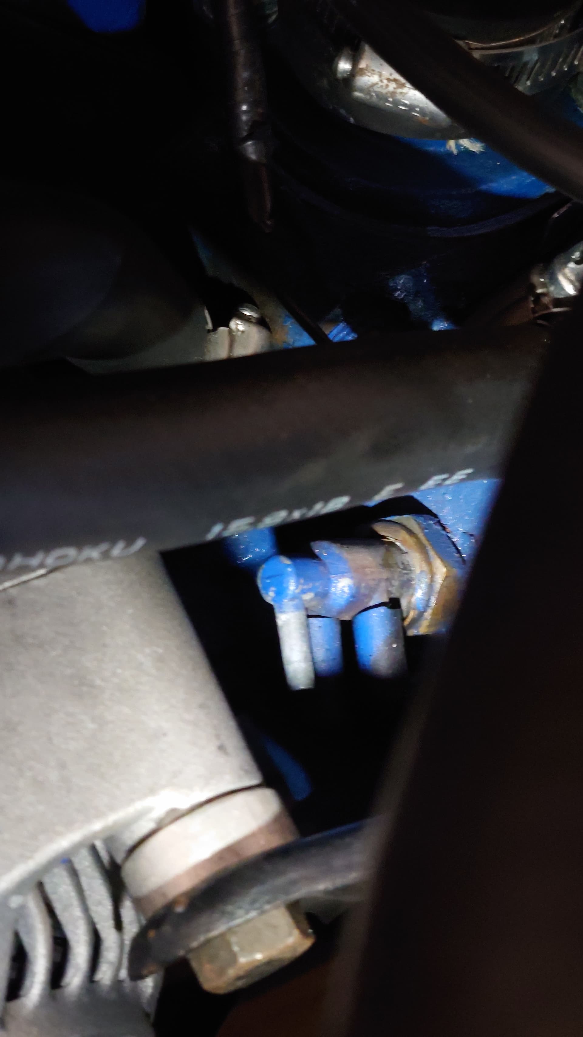

Is this the coolant temp location?
Thank you for helping.
I got it, I will check the sender too.

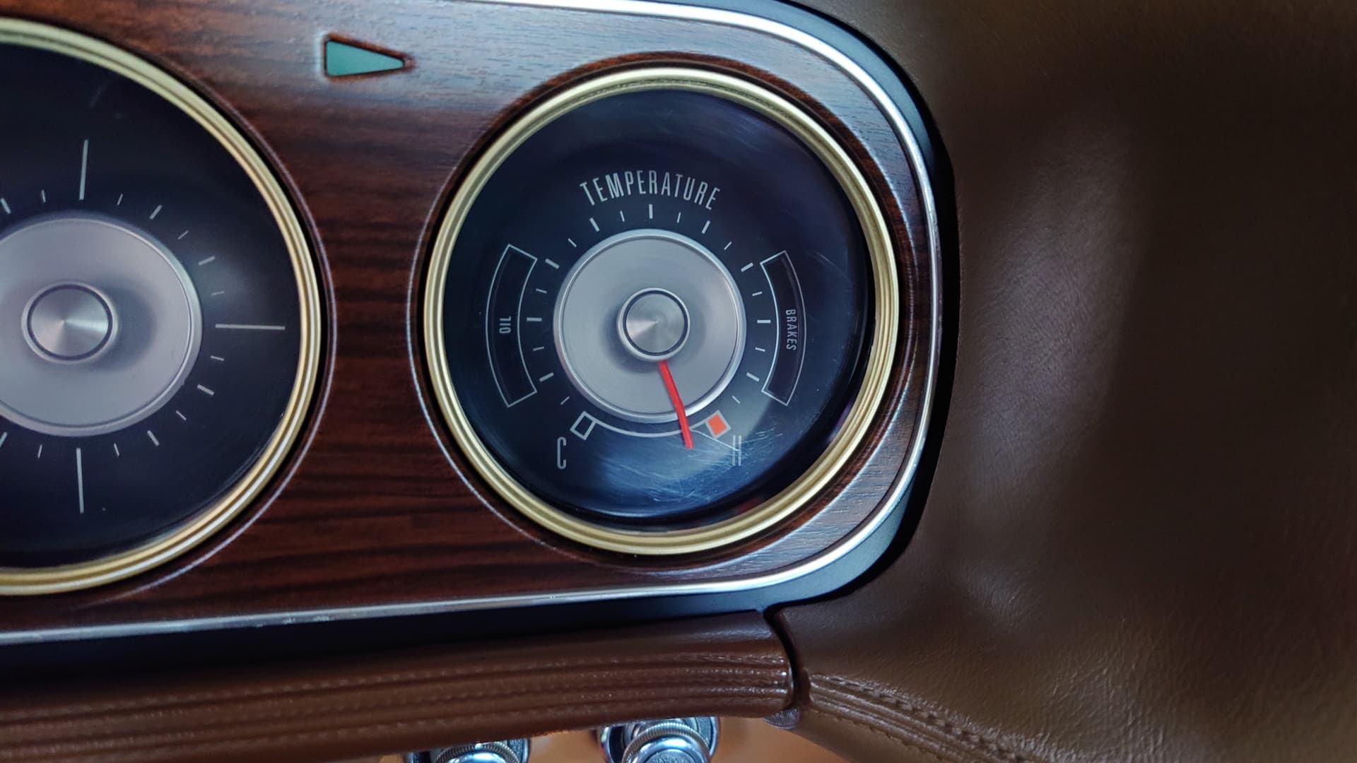

If the correct thermostat is installed, doesn’t the needle of dash gauge mark a red zone even in hot weather?
If my memory is correct , that is a temp operated vacuum switch that was origionally plumbed with ported vacuum, manifold vacuum and the vacuum advance. If the engine temp got hot , the switch applied manifold vacuum at low speed or idle to increase idle/fan speed. Might want to hook it back up
Thanks to everyone, my Cougar has the coolant recovery system that is working correctly.
Thank you for letting me know.
Is this vacuum advance temperature?
Mine isn’t connected to anywhere! Is it OK?:scream:
If im thinking right , if thr vac switvh is still good ,at normal temp , the distributor vacuum advance would be ported vacuum…no vac advance at idle
When temp goes up the distributor sees manifold vacuum which should speed up idle speed (both fan and water pump) helping to cool the engine down at slow speed. A real cheep fix if it works as it should
I keep hearing people repeat that and it isn’t true. While the carburetor has very little vacuum at idle, it does have some and enough that the engine idle speed picks up a lot when the vacuum hose is connected. I must have read this one million times. It still is not true.
Yes, that is the temp controlled vacuum switch and it works as you described. It advances idle speed in case of overheating.

I went to drive in order to measure water temp today.
It run 197℉ upper hose and 181℉ deg lower hose with car temp gauge around 3/4, and run 203℉ sender.

I founded out that the water temp didn’t rise a red zone by putting the sifter P.
Is there something wrong with car temp gauge?
203 deg at the sender is a pretty normal operating temp, so your gauge and/or sender might be reading a little too high. My dash gauge doesn’t read 3/4 until temp sender is 230 deg, top hose is 225 and bottom hose is 195.
But, only 16 degrees drop across radiator is not normal. When my 70 351C sender temp is 205 deg, top hose is 195, and bottom hose is 165.

My temp sender measures 30 ohms to ground at 205 deg which should read a little below 1/2 on the dash gauge.
You can check gauge calibration with one of these handy devices:
