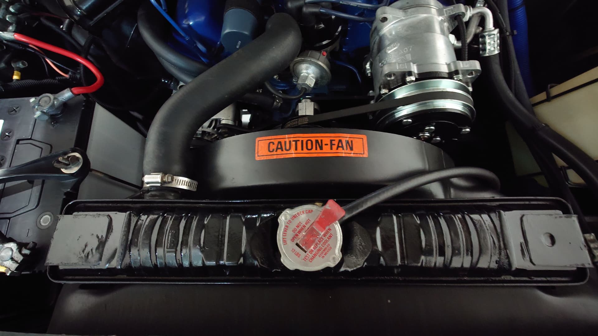

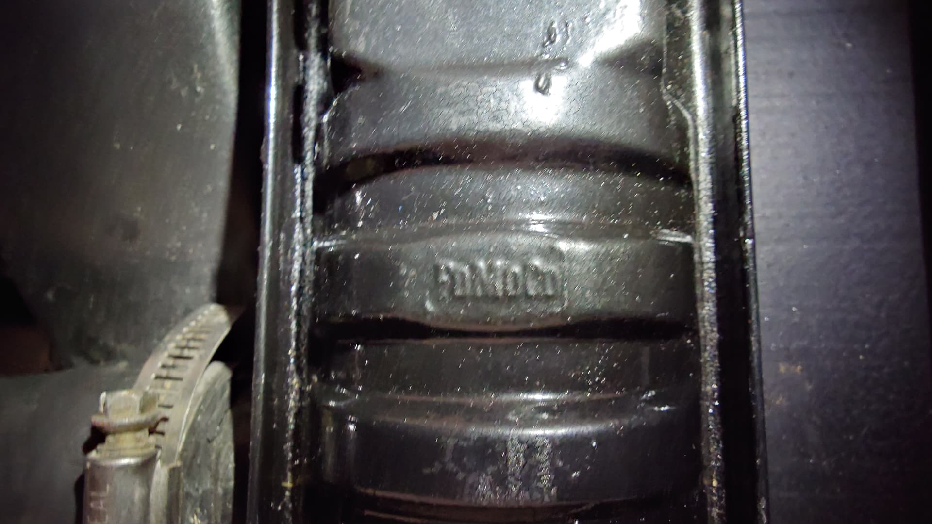

Radiator and fan.
Do I need to replace this fan for protect the engine?

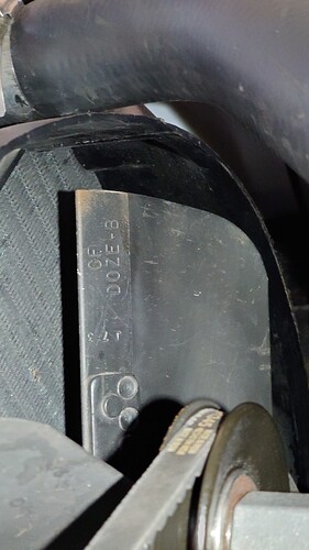

Front what I can tell the last photo, the shroud is too large for the fan…should be about a finger width between the outer edge of the blade and the shroud

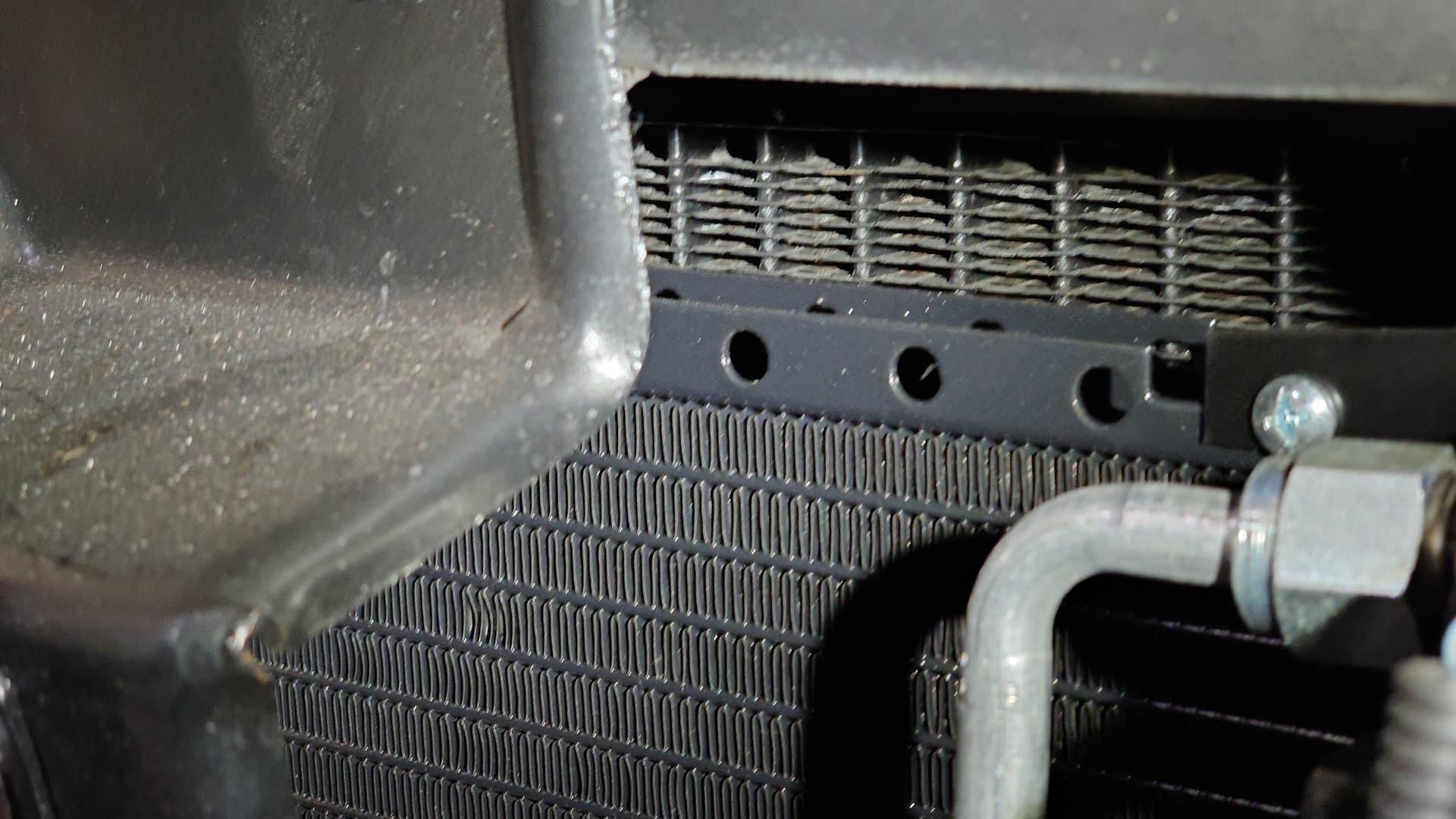

You have the same 5 blade fixed fan and 20" radiator that my Cougar had. They came that way on cars without air conditioning. Looks like air conditioning was added to yours, so you would definitely see an improvement going to the larger clutch fan and 24" 3- row radiator Don talks about in the video. But I would check the thermostat first - start with the smaller easier fixes.

I see you have a stock looking fan from the part numbers on it. Per Royce’s comments, the factory did it right with engineering. It’s the shroud that I would suspect is an aftermarket “close enough variety”. From the other comments about ac being added and a fixed fan, the radiator is for a non ac car from what I remember. I also see that the fan is all the way into the shroud. It should be half in/half out. You’ve got several things to check, but I wouldn’t see that you need an electric fan to make the car cool. Use all the stock parts for an ac car and you should be good to go (radiator, fan, shroud)
