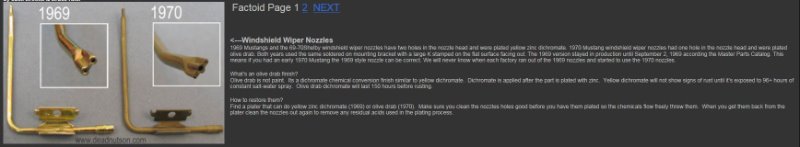

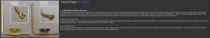

…my understanding is that the original finish on the vacuum actuators was Olive Drab.
True? False? Inquiring minds want to know.
I posted that picture of a bolt in Olive Drab as that was just an example pic I had, to show what the finish would look like. That being said, I’ve seen quite a few variations on what is considered “Olive Drab”. Many of them look plain old olive green to me, and some have an appearance closer to zinc dichromate (but not quite the same).
This is (IMO) a good comparison of the two finishes, from the DNO website, along with a description of the difference between the two.

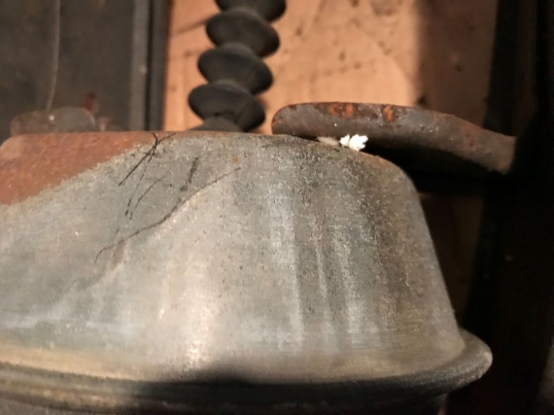

Doing some fall parts re-org and came across this 69 vac can that is original untouched. I would say the color is “olive drab”.
