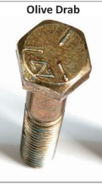

And if you have it apart and broken into the basic pieces, why not send the metal cannister halves to the plater and have them redo the original “olive drab” plating instead of using spray paint on it. Or order the materials and plate it yourself, if you’re so inclined.
I think the hardest part will be opening the pinch seal without distorting the metal too much, and then pinching it closed again and making it look presentable.

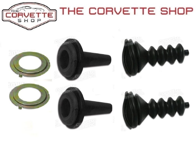

Just buy the Corvette seal kit. Enlarge the holes and install. Easy.
Is that actually olive drab plated? Or is it just painted? I thought Critter Creek painted theirs.
Looks like zinc dichromate - not even close to olive drab
Typically olive drab was used for clips and retainers and not for bolts or nuts
I have a critter creek unit in stock for less than the NPD price, correct kits coming soon!
https://secure.cougarpartscatalog.com/17051/31132/shaft-seal-kit-headlight-vacuum-actuator-repro-1967-1970-mercury-cougar.html?attribs=75
https://secure.cougarpartscatalog.com/d0wy-13a167-a.html?attribs=79

Is that actually olive drab plated? Or is it just painted? from Mike_B_SVT
I would call it painted olive drab on the 1 I got.

I agree with the assessment that the original finish on the 1969-1970 actuators was zinc dichromate (yellow zinc). Thanks Don for the new seal listing info. Nearly every core I have holds vacuum on the lower port fine, but none hold vacuum on the upper port, so I need your new seal kits. Let me know when available. Best Regards, Scott
