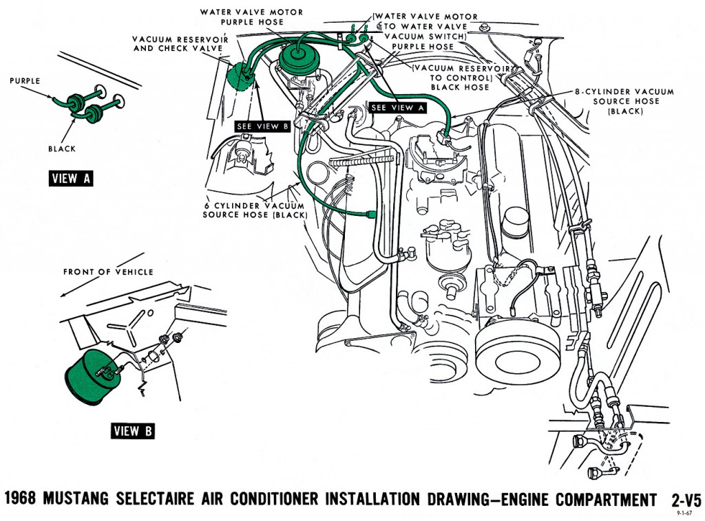

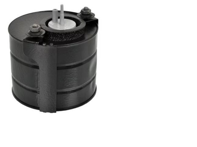

You don’t need the larger vacuum reservoir ( used for the hidden headlights ) which is located inside and at the front of the drivers side fender. But you do need the smaller vacuum reservoir ( ‘can’ ) which is located near the top and at the back of the passenger fender well. It looks like this ( image courtesy of WCCC ):
AC vacuum cannister
