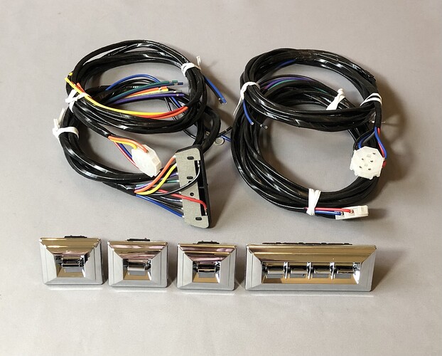

If there’s one thing I’ve learned after wasting over a thousand dollars on many types of window crank switches, DON’T.
I’ve used Nu-Relics and others. I’ve replaced motors, added relays, reworked switches, used multiple gauges of wire and nothing has upheld over 5 to 6 uses.
Going back to manual but I’ve tossed my old regulators and glass mounts. Yay, another ghost hunt.

Perhaps using the switch to operate a pair of relays?
I appreciate that. I am using two relays, the switches just give out. It’s like they are adequate for signal up to 9 volts, but burn up for the advertised use. I’m done with trying to convert to power windows. Cranks are great.

I have seen three types of switch failures. Mechanical failure where the plastic insulating parts break, usually at a pivot point. Over current failures where the contacts overheat and plastic parts melt or where the connections are inadequate and they melt the housing. Over voltage failures where there is arcing across the contacts. This is most common when the lubricant in the switch has congealed to the degree that the movement of the contacts is impaired.
Vic of CougarsUnlimited has much greater knowledge of these devices so maybe he will share his experience. Once we know the nature of the failure we can develop a solution
The issues stem from the switches themselves, as both (Auto -Loc, and Nu-Relics) are housed in billet aluminum. They both fail at direct current, negative switch load, relayed current, positive load, and negative. The crank switch by itself is a great concept and very awesome idea, but until there is a better design of the switches themselves, failure occurs at small usage amounts. Motors are fine. Truth is, I don’t know how to make them hold up for normal use. I wish they did, because I have well over a gnote in extra switches, motors, ect.
Since the money is spent maybe you could send me a pair and I can see what is going on and maybe come up with an idea for fixing it. No charge just my curiosity at work. I have been developing 12 volt products for years and this seems like a reasonable application
What about utilizing a factory Ford or GM switch, may need to make a custom housing to hold them but they should hold up better overall.
Sorry, my only experience with window switches is the factory-style switches. As Bill mentioned the contacts are the weak point because they arc and carbon builds up to where the current can’t pass through them. The contacts were probably not made with the silver-tin oxide coating used on modern relays/switches.
It would be better to use the switch to control solid-state (MOSFET) transistors in an H-bridge configuration. But that will require rewiring the switch panel so that a separate H-bridge controls each motor.
I suspect that is the way it is done in modern cars (except that the CAN bus is used to tell the window controller module to move up/down).
I’m using the same ones that Bill Pratt used for Catvert, but mounting them in the stock position. Not in the car yet but have bench tested OK
