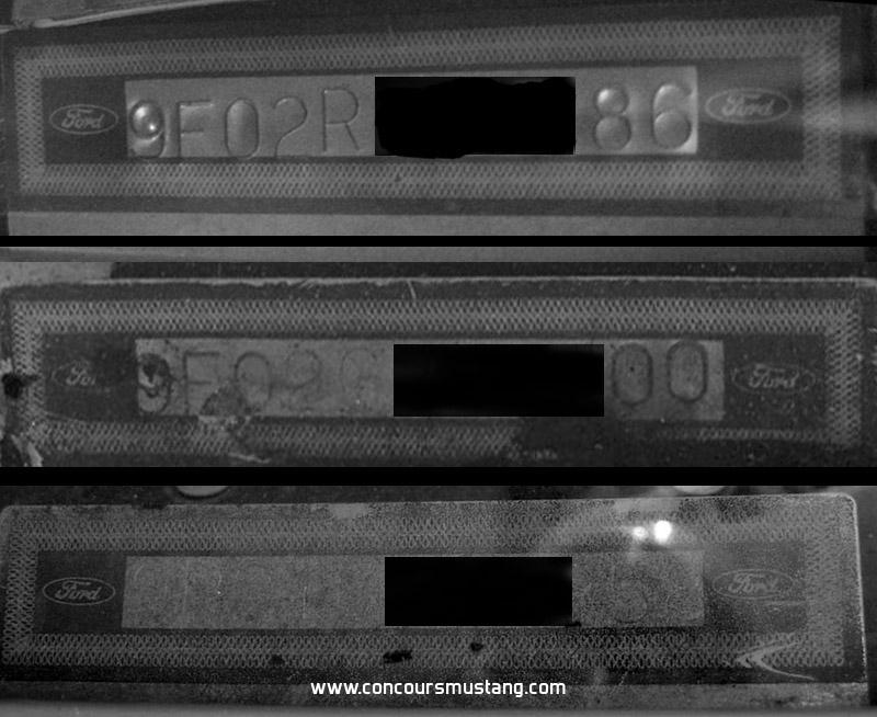

Since there is a pattern applied originally to the dash VIN tag that is very detailed and if your going for the factory look I would suggest purchasing a clear sticker that they sell for this purpose and before you install cut the section that will go over the imprinted VIN out so that the “frame” of the sticker will now lay flat. Would guess (haven’t checked) that WCC carries them
Guess you could paint the whole thing like later years but your not going to get a nice smooth or clean surface finish without painting it without the windshield in place or bending it rearward making it difficult to get it back where it should be
Examples of the pattern I’m referring to above

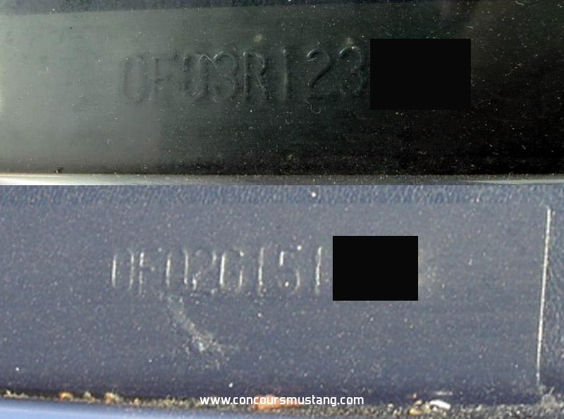

For the 70 Dearborn owners. Sorry didn’t have any Cougar ones handy :wink: Lighting explains the differences between the two examples. Lower one gives you a peek for comparison with the dash pad. Pretty close
