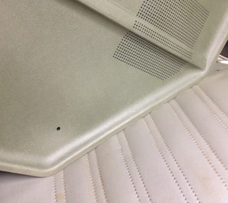

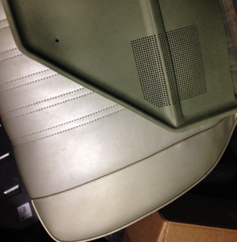

That being said I have an ivy gold interior and bought some alleged light Ivy gold “dye”. I tested on the kick panels since they have faded to a silver hue. The paint does have some metallic specs in it like the original plastic but it isn’t as translucent as the original plastic and vinyl was. Color is slightly off but it seems to match the overall color scheme. In fact in certain light it seems to match the door panels and front seat where the vinyl is darkened from age.
It would be nice if someone sold the fabric by the yard so we could redo the back panels and maybe try and tackle the door panels. The back panels are just a piece of vinyl glued to the plastic and the door panels might be easy to replicate the stamping with real stitching. I’m tempted to change the interior to blue since I need new seat covers and a headliner anyways and it would be easier to match that color.
Here are some photos of the kick panel next to the rear seat that looks to have minimal color aging issues. As you can see the angle is very important. BTW this a Accumatch V-5778.
Thanks for the pictures. That does look pretty dark compared to the seat.
