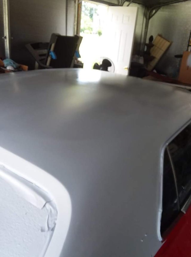

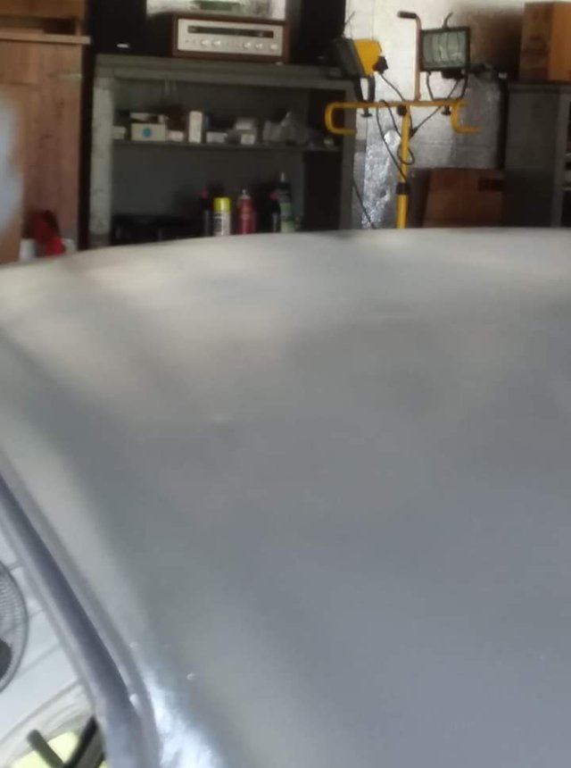

After spraying the primer on the top , I see hundreds of small imperfections. How forgiving is the vinyl top? Will the vinyl hide most of them?
BTW. Is the economy vinyl top really that bad?
Who has used them and what was your outcome?

I’ll go over it with some 2k glazing compound for imperfections and I guess I’ll spring for the better quality vinyl.
