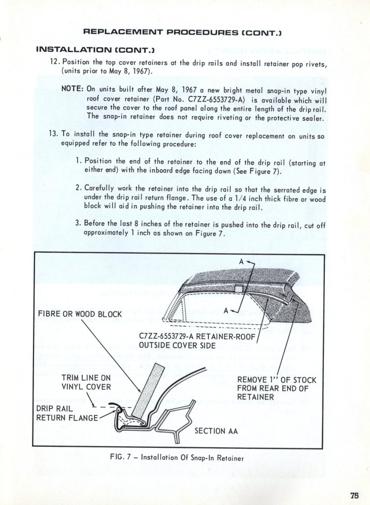

As far as the side retainer strips, I don’t have those anymore, and am wondering the same thing as you, G68. I don’t plan on using them (mainly due to scarcity and difficulty of installation) but I do wonder what the proper thing to do is in the drip rails to keep the edges down & sealed. Any opinions? Seems like I’ve seen black silicone caulking, etc. Is it needed if you can get the drip rail trim over the edge of the vinyl?

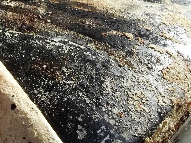

There was something black painted on the roof under my replacement top. That’s the only reason the roof didn’t end of looking like Andrews. It was starting to go though. You can see the water and some rust in the photo.

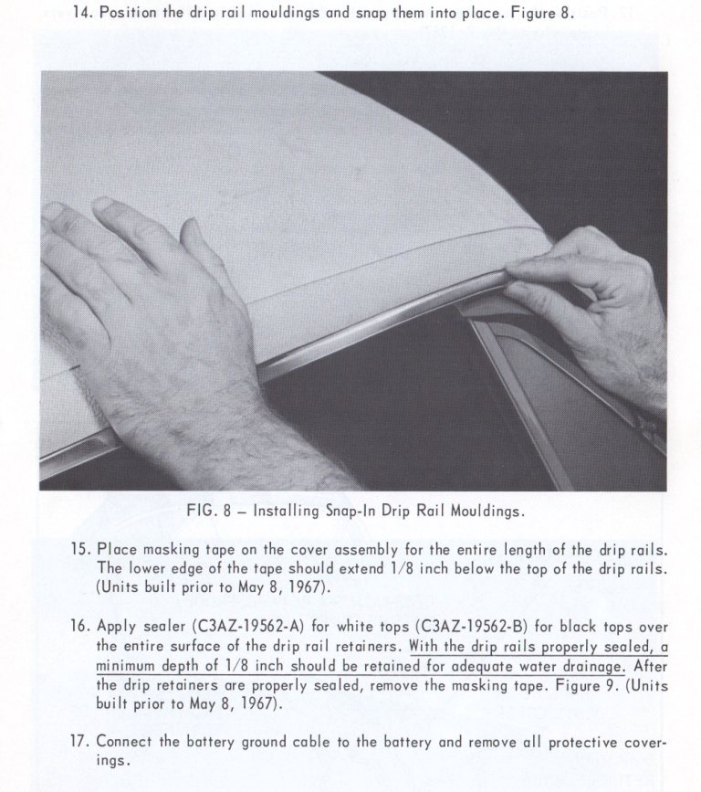

Here’s the proper thing to do with the drip rails according to the manual. The silicone was apparently only for the early '67 models. It doesn’t say not to use it on later models, it just says it’s not required.
One interesting thing is that they drill holes and hammer in nails to hold the replacement vinyl along the top edge of the front and rear glass.
