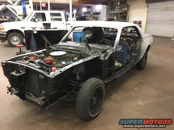

After working through the basics of an engine that has not been started in 15-20years I wanted to know if I had a running motor or not to decide on my path. To my surprise she actually fired right up and runs pretty well. Since the car was basically already stripped down I decided to do the body work and paint first which is backwards from the norm of body work being last. Not having an endless budget I worked with the body shop to save some costs. They pretty much just had to prep and paint. I did all the panel fitment and assembly before paint.

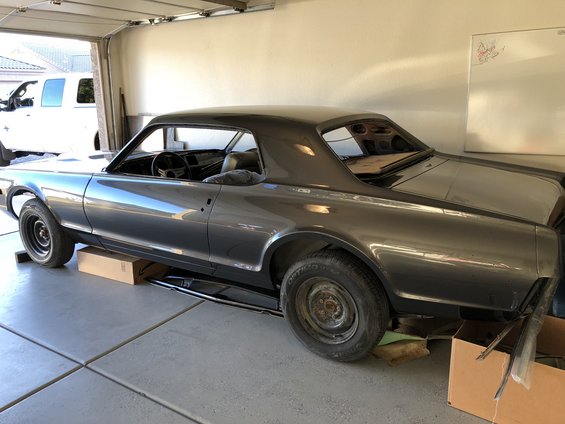

From the day I picked it up I knew I wanted to paint it a dark gun metal grey color. For the availability, ease of touch or or god forbid repair I chose a 2017 factory color from a F250. Very popular color on todays modern fords.

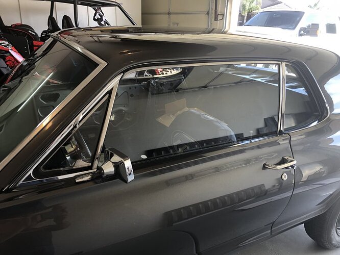

What is so daunting on a project like this is all the details. Every part needs some sort of attention, what seems like simply cleaning up and painting can take hours or days. I bring small items like the grill into work to work on as I had spare time during lunch or after hours.
Not having deep enough pockets to re-chrome every piece of window trim like I would love to do I cleaned up and polished what I had to the best of my ability. I can use the cash elsewhere like motor and suspension upgrades. I even bought some blem bumpers from wccc to save a few bucks. I bet most couldn’t tell where the blem was if I didn’t point it out. Things like door handles, mirrors, some mercury badges, etc or reproductions.
