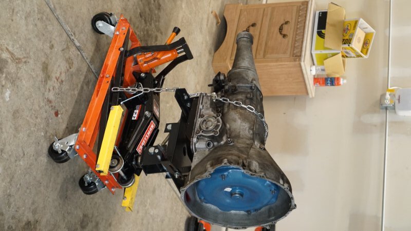

This is my winter project. C6 is already out and I am sizing things up. Been bench designing for a few months now. I need to confirm one more dimension before I am comfortable purchasing a 6R80, adapter, electronics etc…
I have a 6R80 hanging around. Do you need any measurements?
I’d be very grateful if you could double check this 8-15/16" measurement that I have circled in blue. I’m guessing it should be 4 15/16". Hoping really, since the 68 Cougar has about 5" clearance in that region. I don’t have any 1/4 mile times for the old powertrain but expect a 6 speed to really wake this car up. Generally the 6R80 should be more efficient and gives you the close shift ratios of the more famous manual gearboxes. My 9" rear end has the factory 2.75:1. It’s an open rear end but I will probably drive it with that at first to understand how steep of a traclok etc… I want to consider.
The 6R80 had a 4.10:1 first gear ratio, so you probably don’t need more than a 3.50 rear. The 6R has a .069 OD ratio, very close to an AOD’s .067. With 30%+ OD, you --can-- get away with 2.75 rear, depending on tire size and camshaft. I’d suspect a 3.25 would be the best all around gear. Eh… thinking about it, unlike the AOD, the 6R has TCC and if the programming is good the trans can better cope with a small rear. The AOD had a direct shaft so when it hits 3rd and 4th is it locked solid, which makes it “luggy” with a small gear.
The 6R I have is in a trailer and we’ll need the forklift to get it out. If it’s not raining I should be able to do this in the next day or two.
