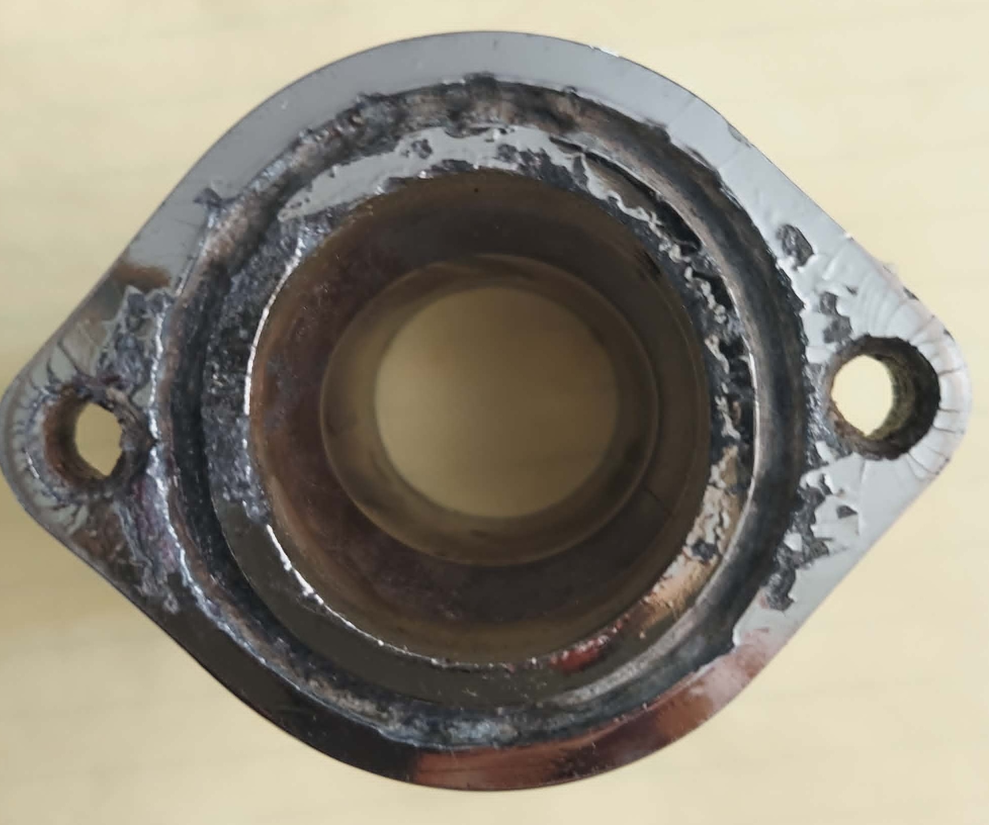

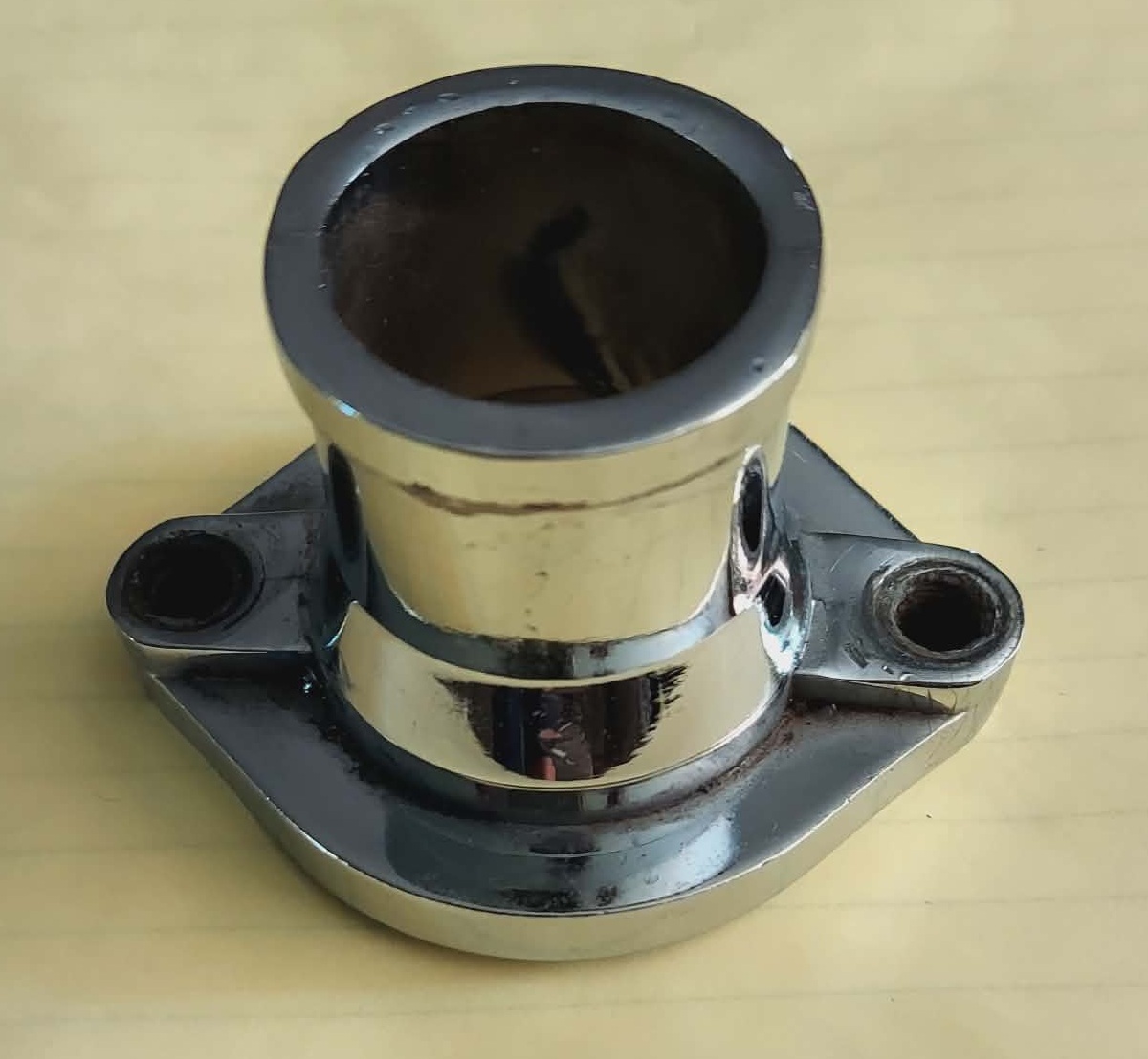

So today I finally dragged myself out to the cathouse and while trying to figure out my underhood wiring chaos (specifically trying to locate the solenoid fusible link) I decided to digress and put in my ““Robert Shaw” style thermostat Track Boss 180 degree. It’s been running with a standard 160 degree stat since I bought it (9/23). Never paid much attention to the outlet housing before but taking it off I can see it is an aftermarket chrome piece - topside looks fine, but Oh My what a mess on the block mating surface. Open to suggestions for a “good” aftermarket repro. WCCC is “out of stock”. I’m guessing a quality OEM would be prohibitively expensive (if found). Need something cause this pup ain’t sealing.

I pitched a crusty pitted OEM one and a chrome one just like the one you posted. I bought a billet Aeroflow unit in black and it looks great. It’s been on my stock Cleveland for a while now and will move one day to my 393 Cleveland.

I did check Rock Auto, they do have it, a MOTORAD CH2035 for $15.40; NPD carries FourSeasons 84858 for $14.91. They look pretty similar, advantage for me with NPD is they are 1/2 hour away and saves me shipping. Let’s hope it seals. I did notice the replacement did NOT have the grove cut into it like the one I took off, and I wasn’t sure that was actually supposed to be there on the housing - thought only the block.

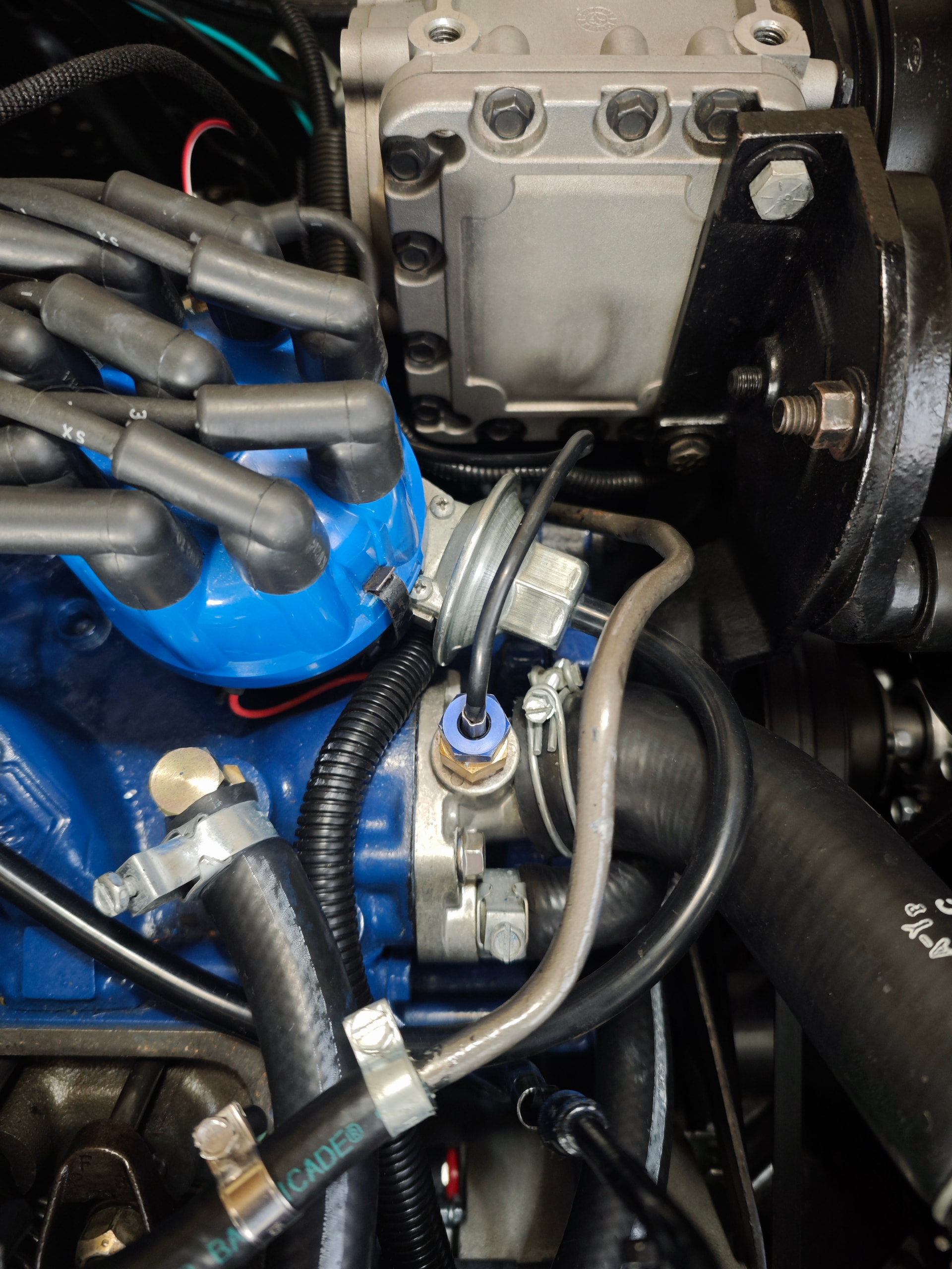

Hi, well FWIW i suppose to each his own, but there’s really no need to over-spend or complicate for this project. So after I got rid of the old nasty OG housing and wanting to install the new thermostat, this is what I did with my 302 on the ‘68:
I purchased this housing, (links below) (bad stock photo but nice in person) threw away the included thin, cheap gasket and bought a much higher quality FEL-PRO gasket both from AMZN. I 1st clear coated the aluminum housing so that my fresh polished finish would not oxidize, then used an exacto knife to trim around and perfect the fitment of the fel-pro gasket to my new housing. I removed the upper plug because i have a temp gauge probe in that port but it came with a nice plug.
Next installed everything with some of my favorite Permatex ultra black RTV, lightly rubbed & coated on both sides of the new gasket, wrenched it in place & let it all sit and cure overnite before refilling the cooling system and testing. everything 1st time out the gate is 100% perfect no leaks and end result looks good too.

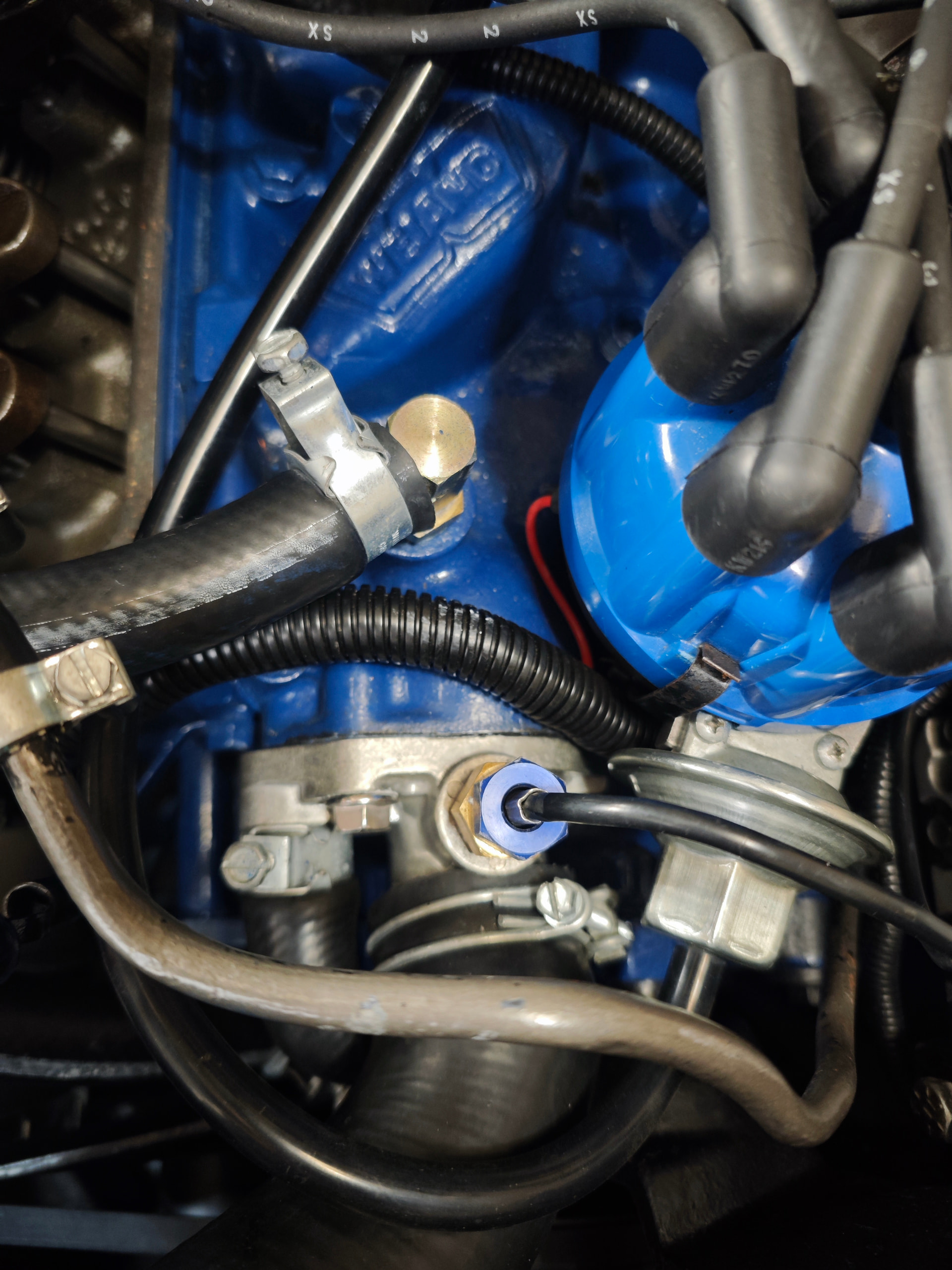

Busy stuff going on in there but you get the idea of the housing end result here.
