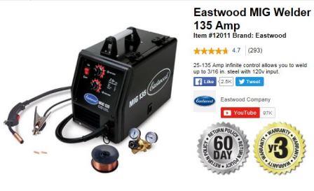

I am in the same situation as you and have been doing a lot of research on welders. I admit that the Hobart, Lincoln and Miller welders are all out of my price range. I have been trolling Craigslist and have yet to see a great deal on a used one. During my research, I have come to the conclusion that you should stay away from the Harbor Freight Welders. I have been thinking about getting a welder from Eastwood that has MIG flux wire capability and can use shielding gas. This runs about $280. I admit that I have not pulled the trigger yet and I would like to hear what others think or have heard about this welder. This will also plug into a standard outlet (which I need) as long as you make sure you have enough amps going to the outlet.

That Eastwood Welder is a relabeled Lincoln Mig-Pak 10. I have the Lincoln Mig-Pak 10 and have been using it for almost 20 years. I’ve thought about replacing it in favor of a dual-voltage Mig like the Hobart 210 MVP. Or the Lincoln version because the Lincoln I’ve had has lasted so long.

I had an older 220v welder I picked up at Harbor Freight many many years ago. I was having feed problems and last year I purchased an Eastwood 110v welder, I believe it was model 135 and they had it for $200. For the money it work has worked excellent so far, but I don’t have many hours on it.
