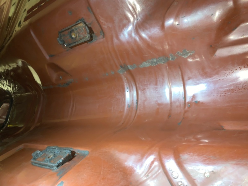

My may 71 car is red oxide but I’ve seen several (batch?) gray examples…

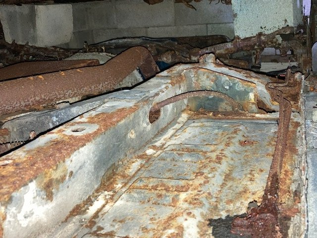

I’ve been meaning to post the underside of my July 71 built 71 XR-7. This is the main floor area. You can see it is a light Gray. This is after I removed the sound deadener.

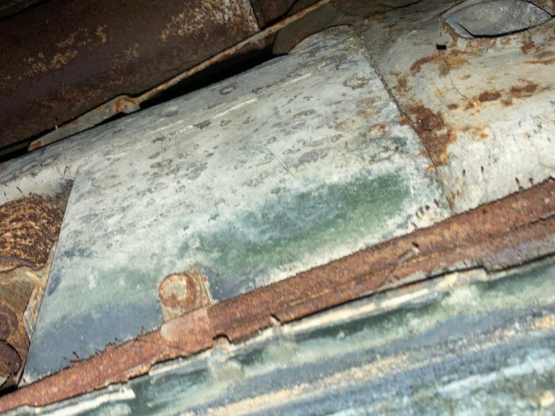

This is the area above the gas tank. It is mostly body color. I have seen this on a few other 71/73 Mustangs and Cougars.
The advice to find out what was used on others built close to the same day is sound. Looking at your pictures it looks like your may have been a light gray kind of like mine was.
