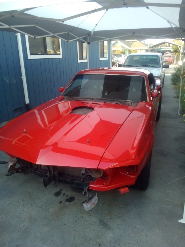

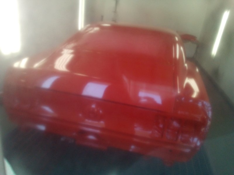

I just finished getting my car painted and now i want to protect my investment of time and money I have had my car for 20 years and now that its painted I will be worried when i start driving it again. A friend told me I can have GPS put on the car I am Sorry its not a Cougar but my 73’ XR7 is next in line to be painted. Thanks for any advice.

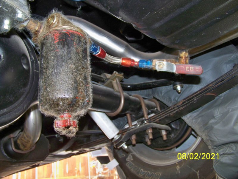

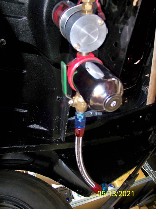

You could just pull the fuses but that gets old. Just prior to the fuel pump, you could put in a shutoff valve. They’ll start the car, but the carb will run out of fuel. Thinking the car is unreliable, they’ll walk away hopefully.

Tire boot on the front tire is the best way. Hard to drive/remove and tough to tow. I use a hiden fuel shut of valve. a manual one.
