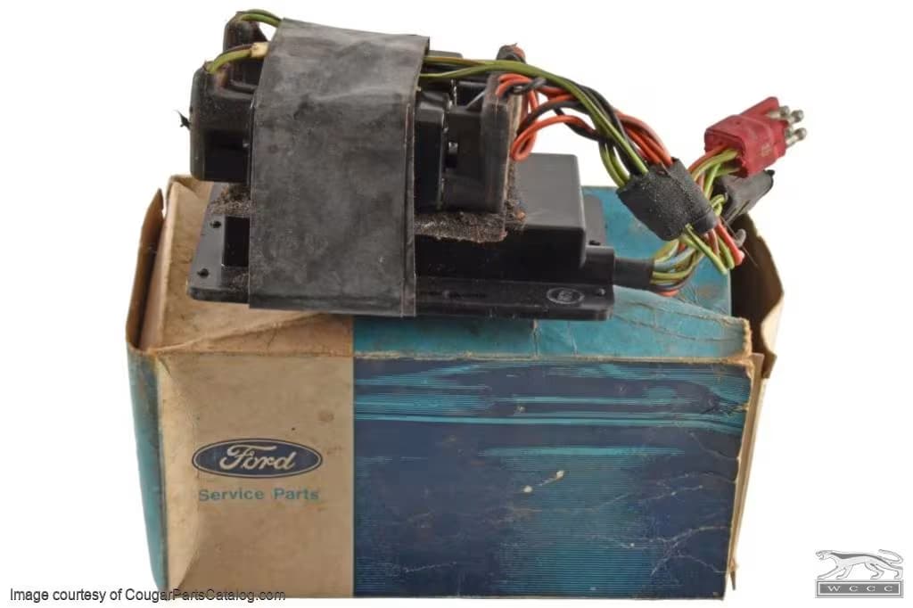

I have a box in the trunk of my '72 XR7 convertible. The part number is worn but it looks like D2WD-13B314-AA. What is it - a sequencer? What are the other 4 little boxes attached? I’d attach a picture, but I don’t see how here. I’ve tried calling West Coast Cougar many times at different times to identify and order a new one, but they no longer answer any phone calls. I’m hoping you can help me know what to ask for. Thanks.
If it looks like this, it is the Turn Signal Sequential Unit
Yes it is. Thank you!!!
I have the electronic sequencer in my 71. You remove the guts from the existing plastic box and pop in the new board.
I have one in my 70 and it works great after a decade of use! Like Hemikiller says, the board snaps right into the original plastic box, and plugs into the existing wiring harness for a factory look.
